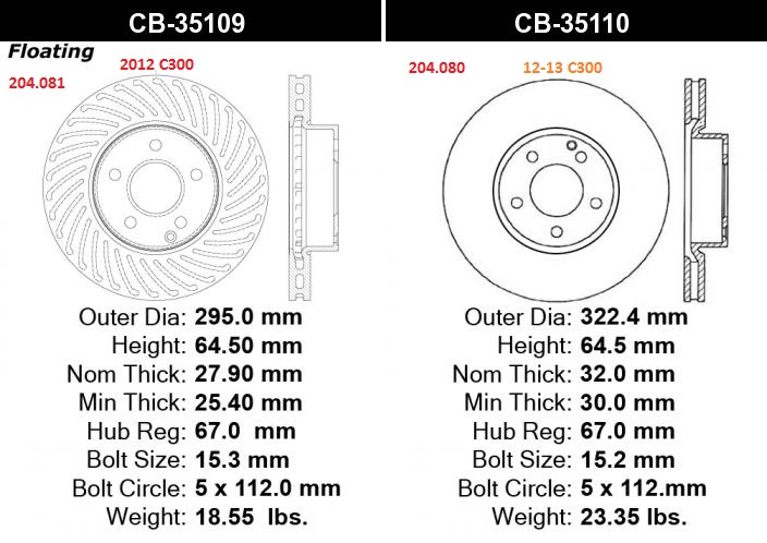

This image is what their website shows for part number and dimensions. (I wrote in red) The left ones are for 2012 C300 204.080 and the right ones are for 2012-2014 C300 204.081. Did MB change brakes for 2013 and they got it wrong thinking 2012 fronts is the same as 2013+?

So that means the 2012 and 2013 rotors are not the same thus they sent me the wrong rotors? (What I was trying to figure out) Well looks like they already noticed that when I just talked to them.

Question since they now giving me a hard time about it. Can 2012 C300 be chassis 204.080 and 204.081 and have different break size for the same model?
That is pretty much what they are saying. You ordered brakes for 2012 C300 204.080, but you actually have 204.081 so you now have to return and pay restocking fee + shipping. My problem is, is a 2012 C300 even 204.080? As far as I can see that would be a 2013 C300 which means your website is wrong and is confusing customers.

I am hard headed because I am not accepting what looks like a mistake from both sides which they want to completely blame on me? I already ordered the correct part so how am I hard headed? I understand I made a mistake, but are we going to let other people make the same mistake for not getting some clarification? Are you one of their employee or perhaps their so called parts expert that expects every buyer to know what their chassis number is? I went to ecstuning and I had no issues finding my correct vehicle, but big no no expecting that for some brakes. If you can show me how 2012 C300 = 204.080 then I'm completely sorry, but for now please answer the question or refrain from not adding to the discussion.
2012 C300 = 204.081 and 2013 C300 = 204.080 yes or no? Cause from the 10+VINs I've run 2012 is always .081 and 2013 is always .080. Also 2013 = bigger engine and I would imagine bigger brakes. 2008-2012 = same engine, same brakes, please enlighten this blind hard headed person.
