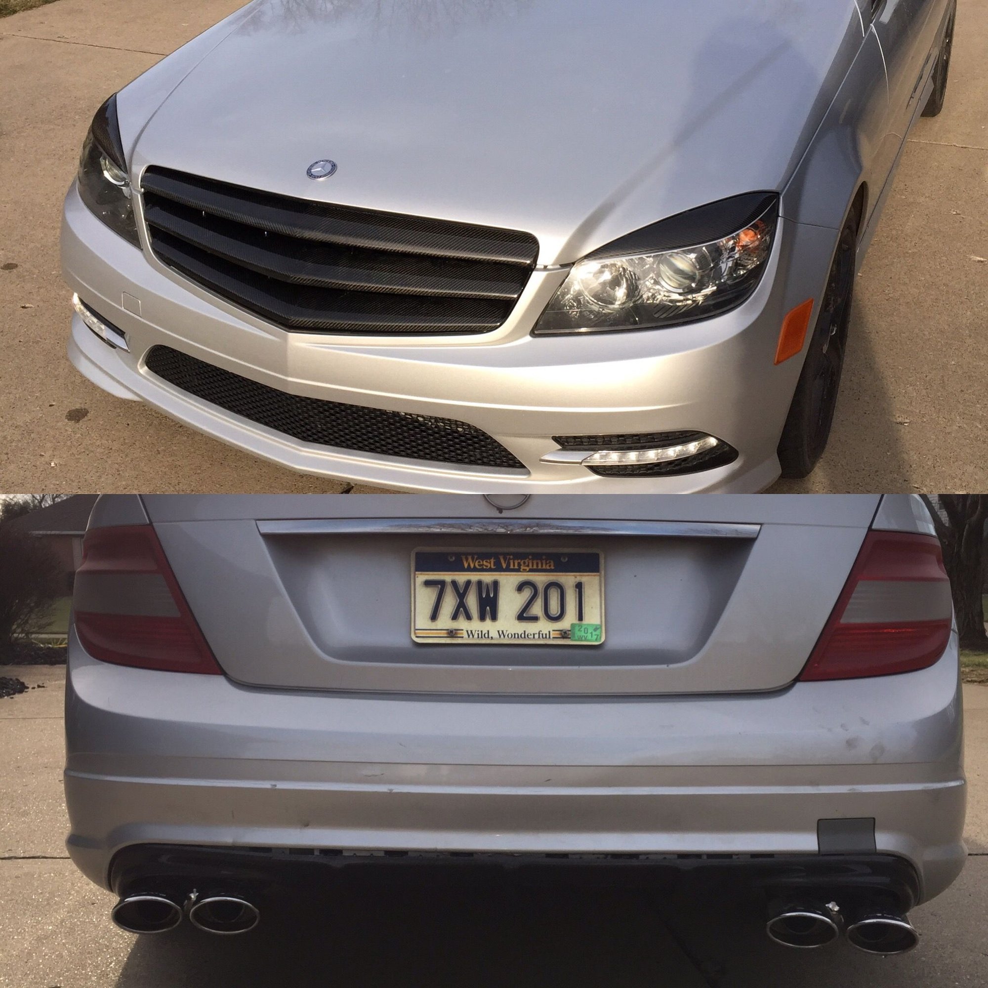

Hey, I got the Carbon fiber diffuser with quad tips but the diffuser won't fit in the brackets because there's not enough room from the bumper guard underneath I'm thinking I may have to take one of the clips out that fit by the tailpipe anyone else having this problem?

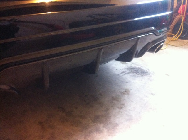

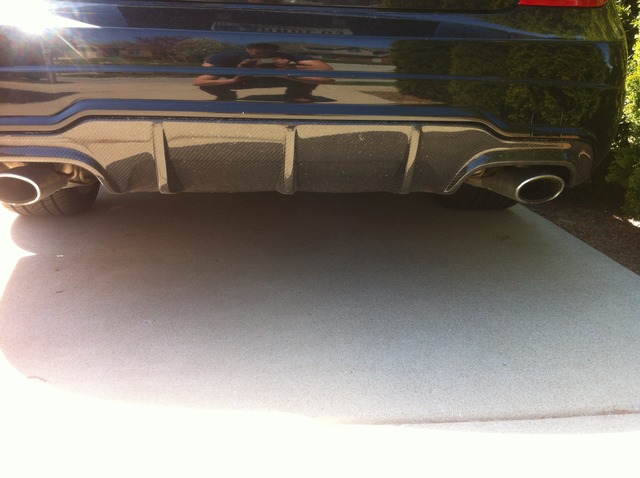

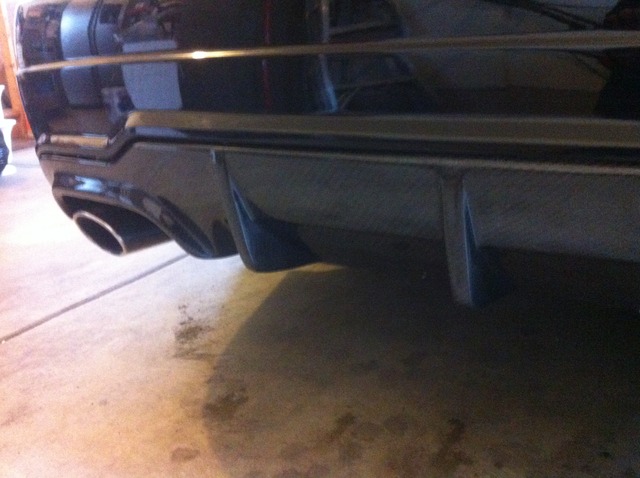

What do you mean bumper guard? This is mine directly after I put it on
Carbon fiber diffuser not fitting in correct-44a159d1-ab5d-447d-b3e1-c02dbd1cfae4_zpsbksmaaui.jpg
Carbon fiber diffuser not fitting in correct-f636b518-8856-4dd5-9a95-190076a77e20_zpsjbqvve9s.jpg
Carbon fiber diffuser not fitting in correct-2d1d2b4a-8198-4f06-9d9c-e21a98c1c8fc_zpsnknym2rd.jpg
When I first started putting the diffuser on I thought it was slightly to big, but it really is all about how you install it. It curves with the natural contours of the bumper compared to when it's just lying flat on the ground. You need to make sure you get the middle tabs in first.
