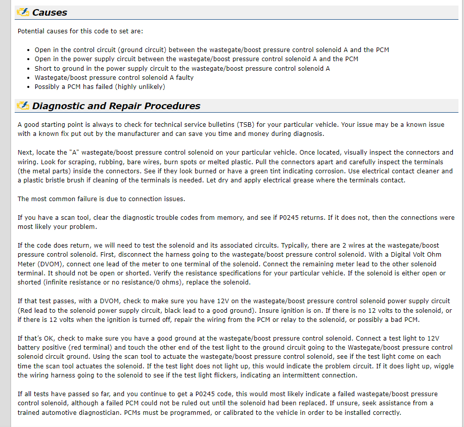

I never seen that code before so did a little searching around. It appears a common cause is a worn/damaged wire or connection. Trace the wires may be a good start.
