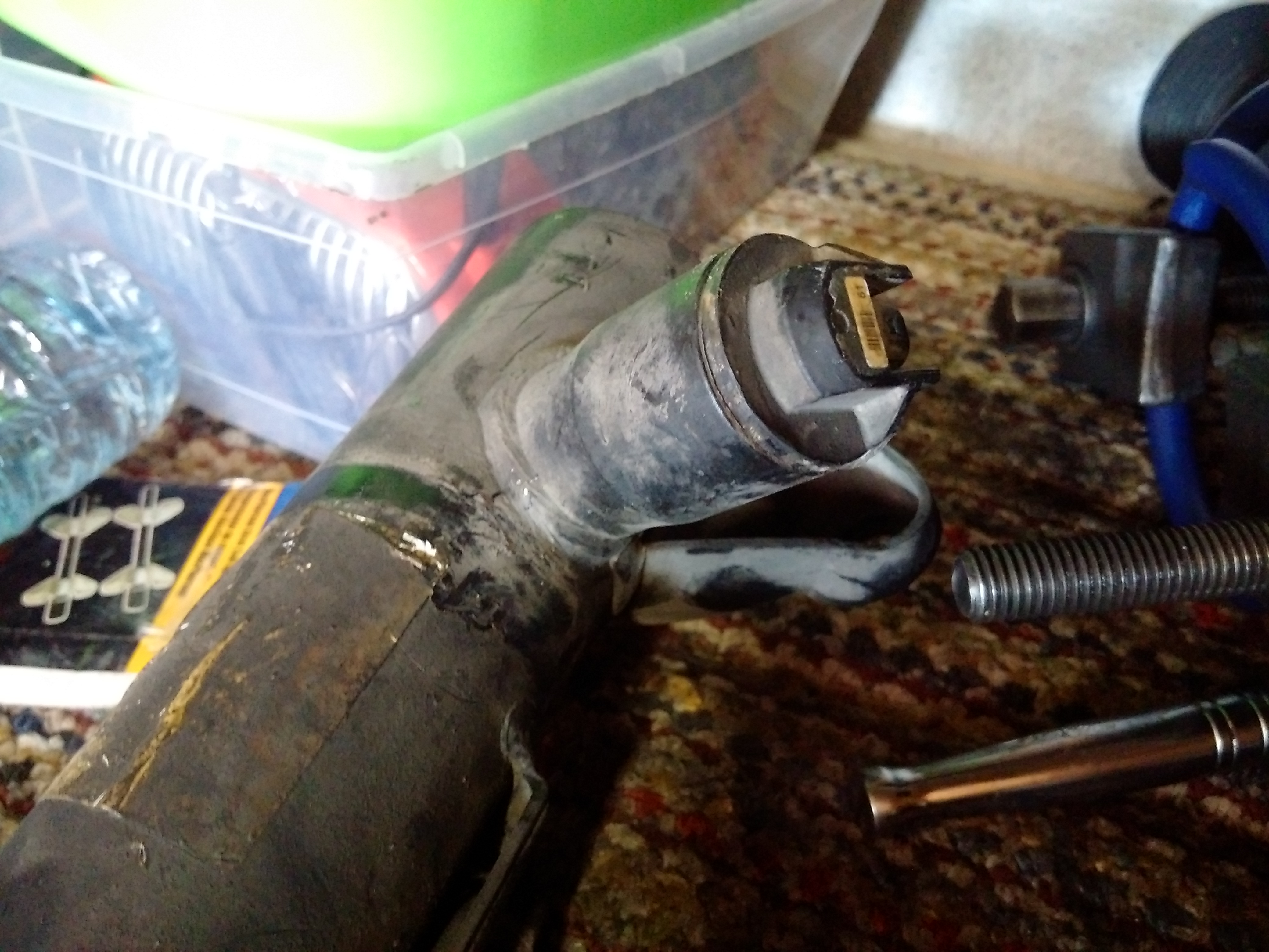

I also noticed the bottom of the strut has a plug which i had to disconnect to take it out.
Pics.
Thank you.

Here is the back with the electric plug.
Is there a trick to extend the shock strut further out?
It seems like a do have dynamic handling package (no one told me about it) but springs can still be changed, what if one fails and you want new?
Must be a way.

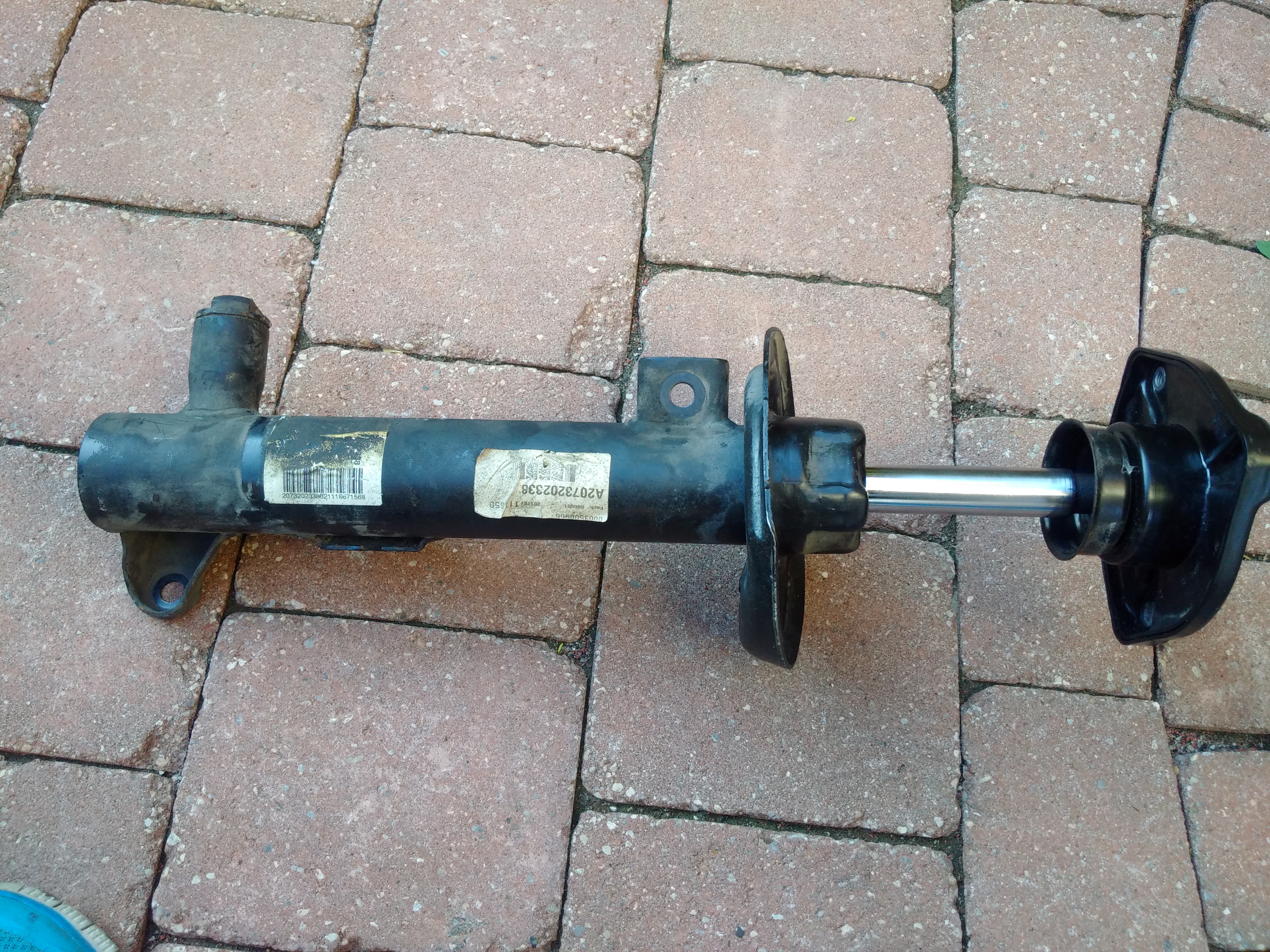

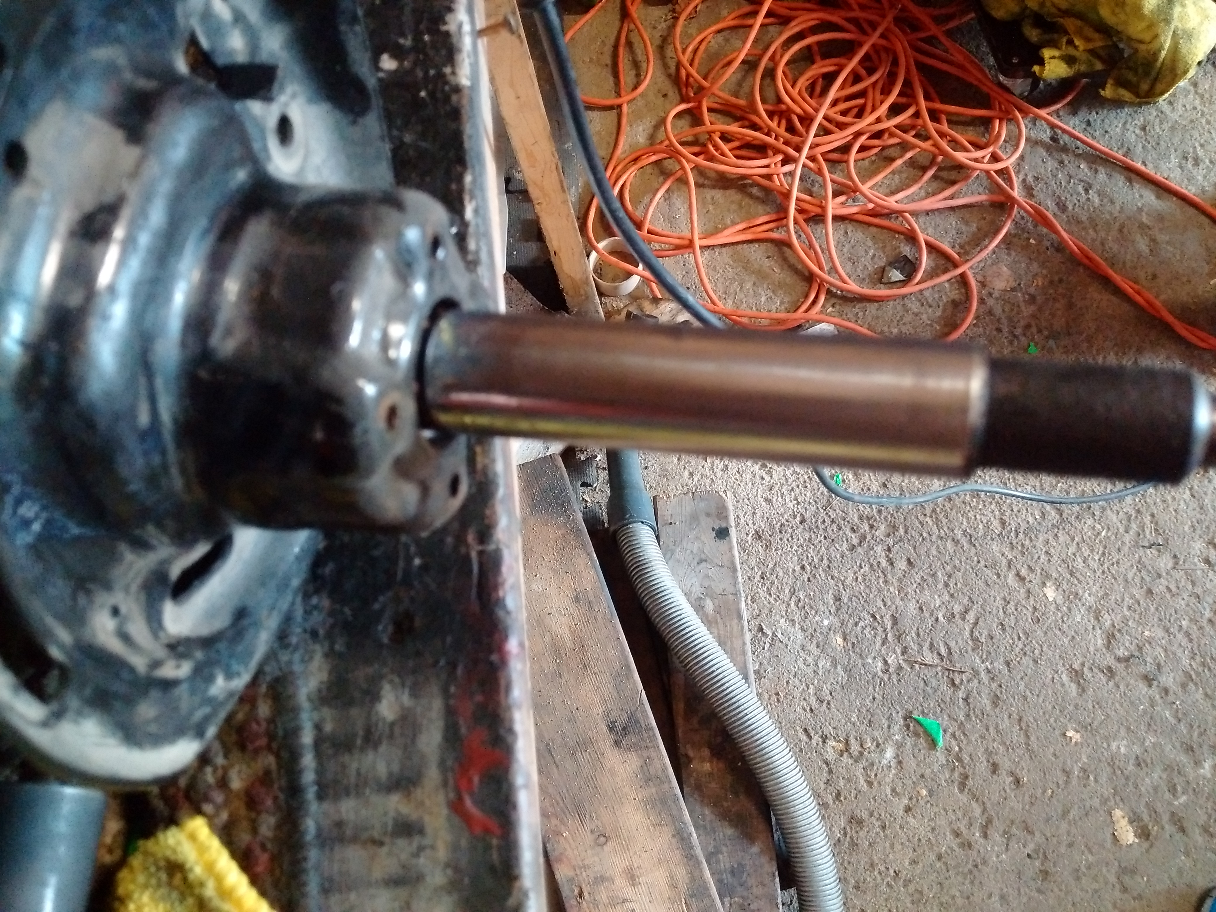

Look at the size I can work with.
No wonder my springs can't fit.
I tried pulling but this is the max I can pull out. Goes down all the way in no problem.
It's a Monroe a2073231300 part number on it.
Tried turning the plug on the side but no changes.
It almost like it needs to be told to extend all the way up.
I can't be the first one with this type of strut.
Thank you

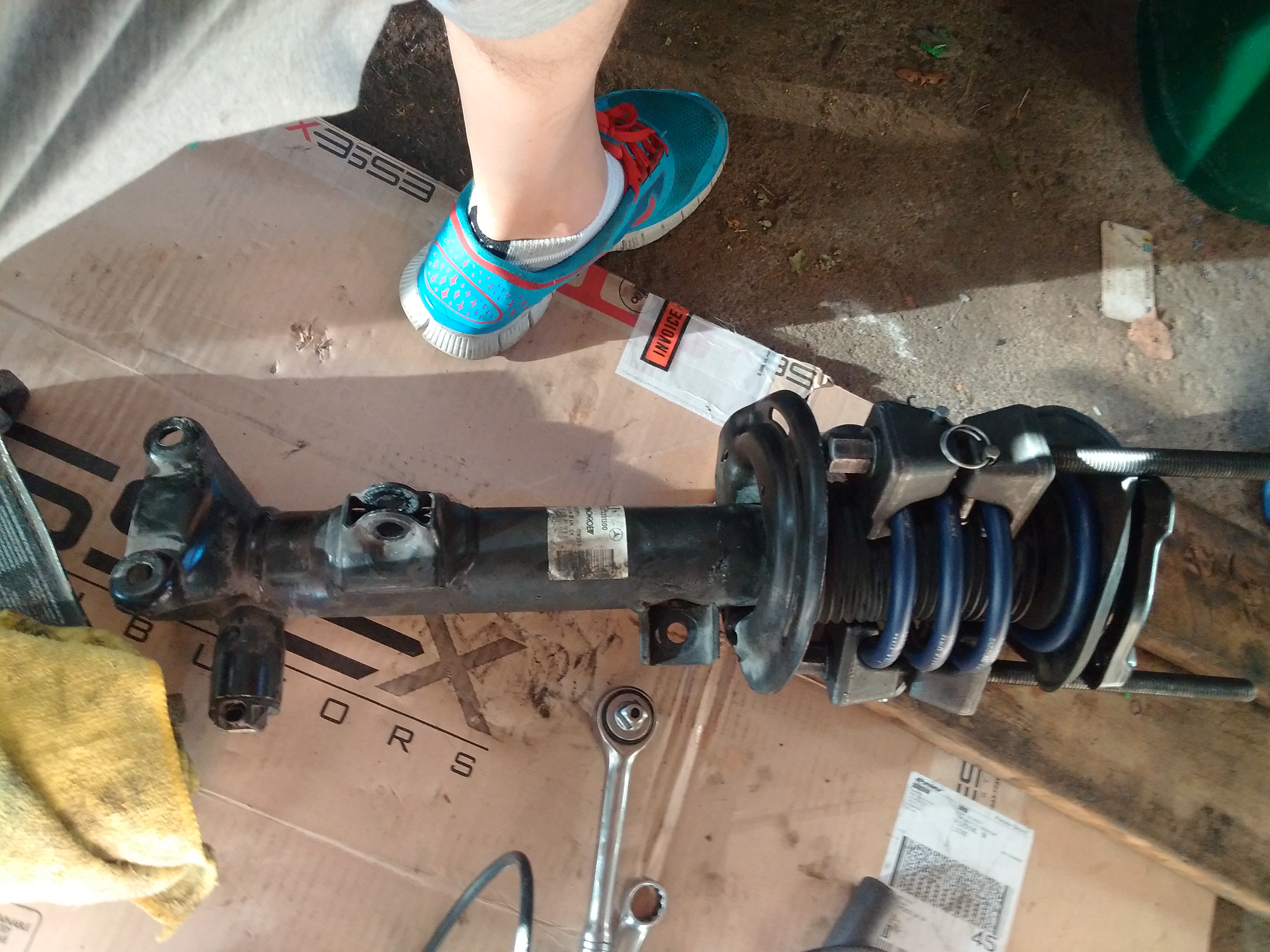

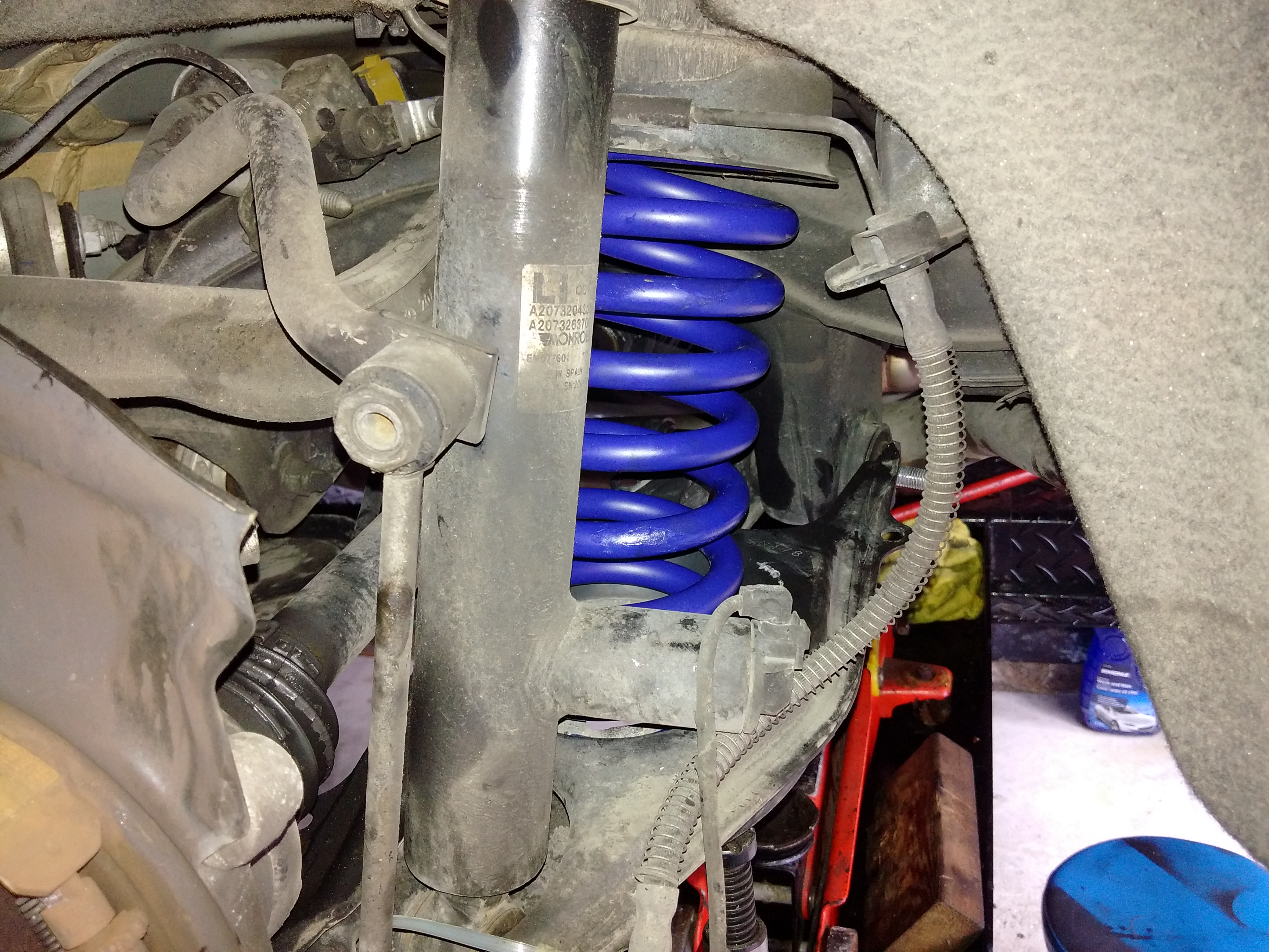

Ok I got this, finally.
I just never anticipated I have to compress the springs so much.
The spring compressors are until the end and if I go an additional ring for more space I can not align the spring properly.
One done one to go.
I hope this is worth it as it was such a pain to do.
So far as I dropped it to the ground I noticed maybe 1cm drop from before.
H&r claim 1.2" at the front which is 3cm.
Attached Thumbnails h&r sport springs installation problem-img_20160918_174901.jpg

The super sport sprint have like three to four rows of non active coils that are intended to sit together basically acting like a spacer. Those were covered with a plastic covering to keep them quiet. But yea. No worries about compression on them because those particular non active coils are meant to be together. I have the same springs because I was going to install these bit then decided to go coilover. They were very soft and shpild be lo problem compressing.

Ok I see by the last pic. I don't think the spring compressor will work. It will keep those non actives from coming together. Standing the strut up and leaning down in the cap you can't get it attached? They are very soft springs.

It's done, one is in the car, the last pic has the spring compressed before I Released it.

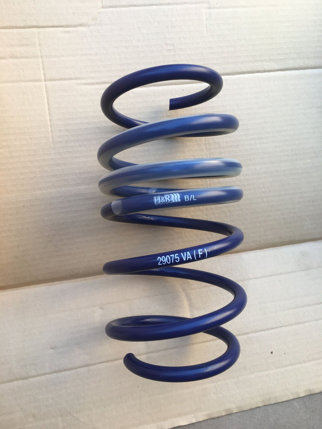

Is this the spring u have?
Old Sep 18, 2016 | 08:54 PM
Isaac13's Avatar
Joined: Mar 2014
Posts: 65
2013 C350, 2013 GL450, 2018 G550 4x4^2
Your spring looks like it might be different
edit--- I am wrong u have sport springs, I thought super sport my bad

Old Sep 18, 2016 | 08:57 PM
kavadarci's Avatar
Joined: Dec 2015
Posts: 194
Likes: 12
2012 C350 Edition 1
Yes mine are different, mine are sport not super sport
