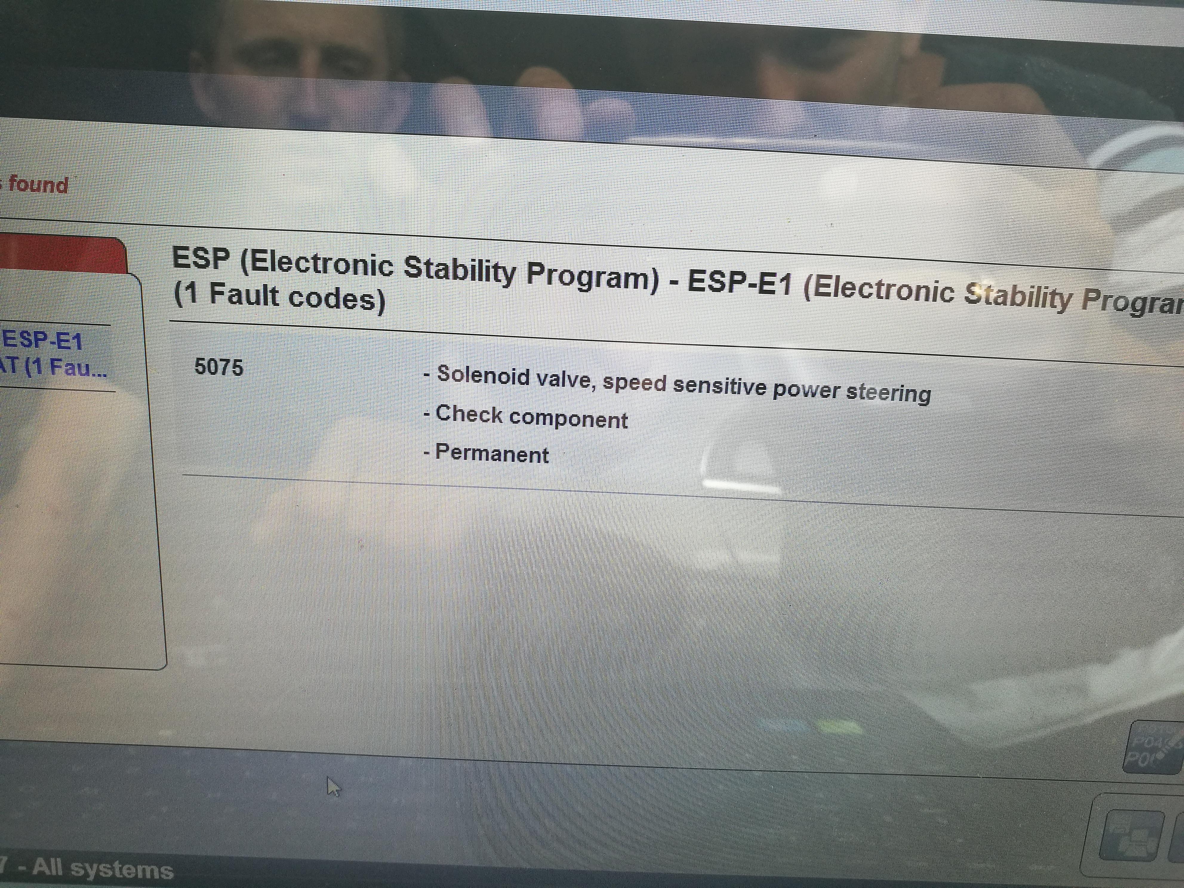

Hi,so after I recently purchased w204 I have noticed that power steering is very bad,it's hard to turn the steering wheel.After some research and diagnostic, we came up that the solenoid valve should be faulty.
Has anyone replaced it yourself?Maby it's worth to check the fuses?Anyone know which fuses are for power steering?
Any DIY for replacing sps valve?
I'll include error code with picture.
Thank you
