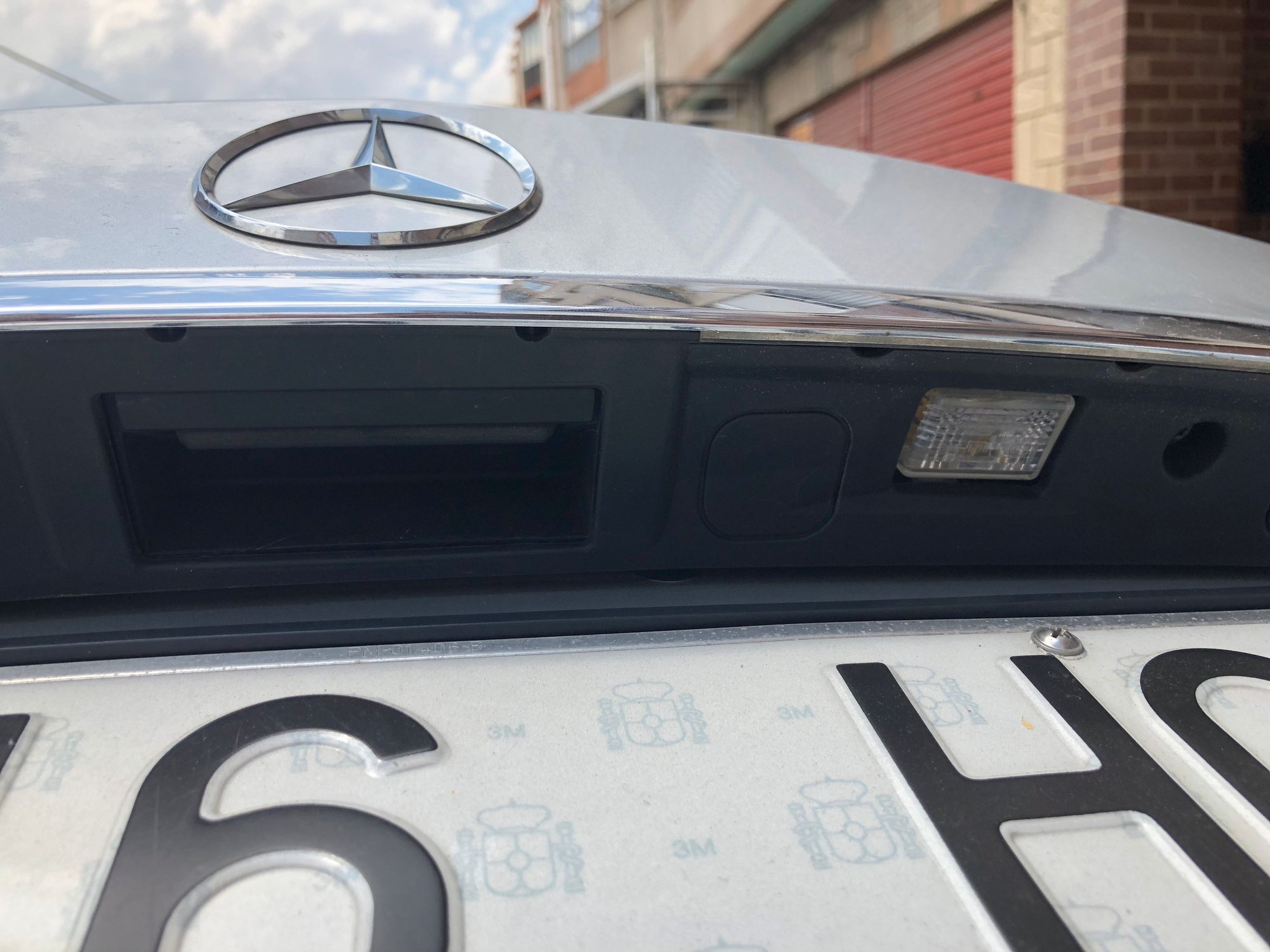

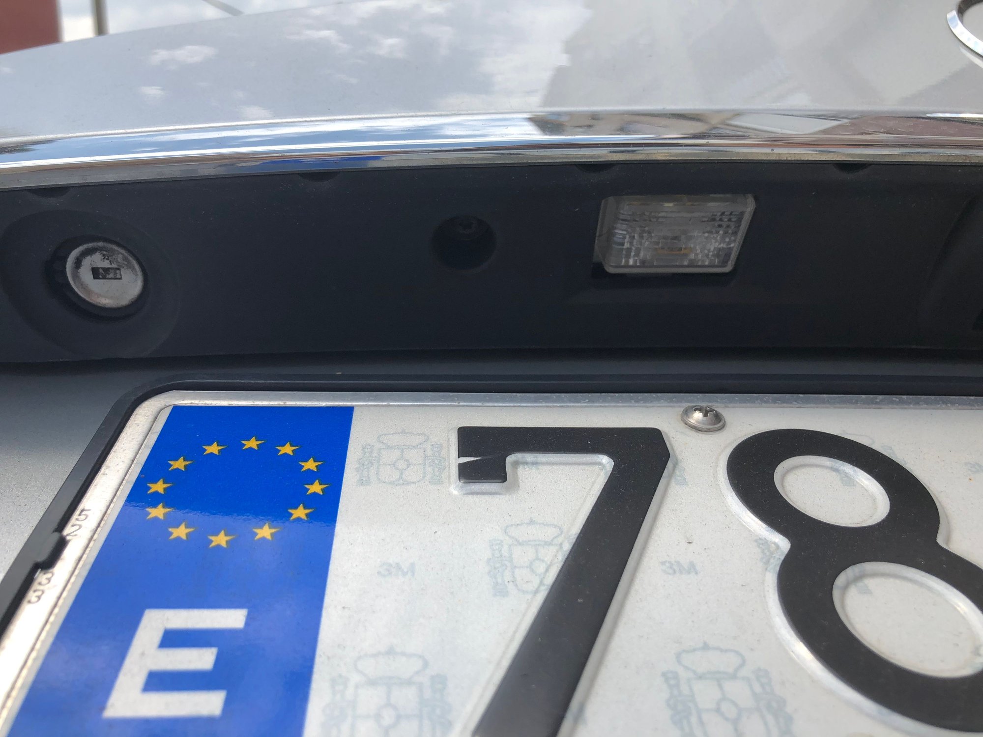

Hey there,I am triyng to install a rear view camera and I’m not sure what do I need,w204 c220 2011 avantgarde.ill attach some fotos

You need a camera ($25 on Ebay) and Fakra cable to plug into the back of your radio. The camera will replace the backup light housing in Pic #1. You run the camera video cable from the front to the rear and tap into a 12 volt fuse that is only powered when the car is on. I had a 2011 C300 and install very easy, not sure what radio you have or if you have the correct video out in the back of the radio. There are many videos on Youtube or search this forum.

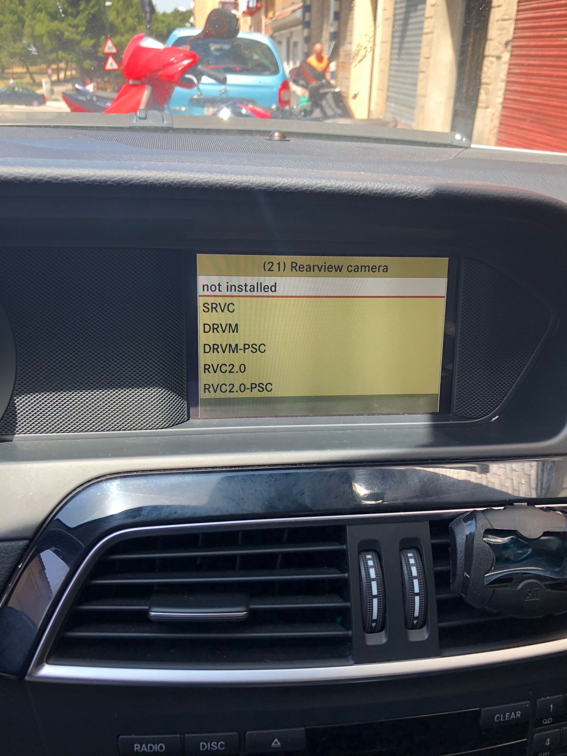

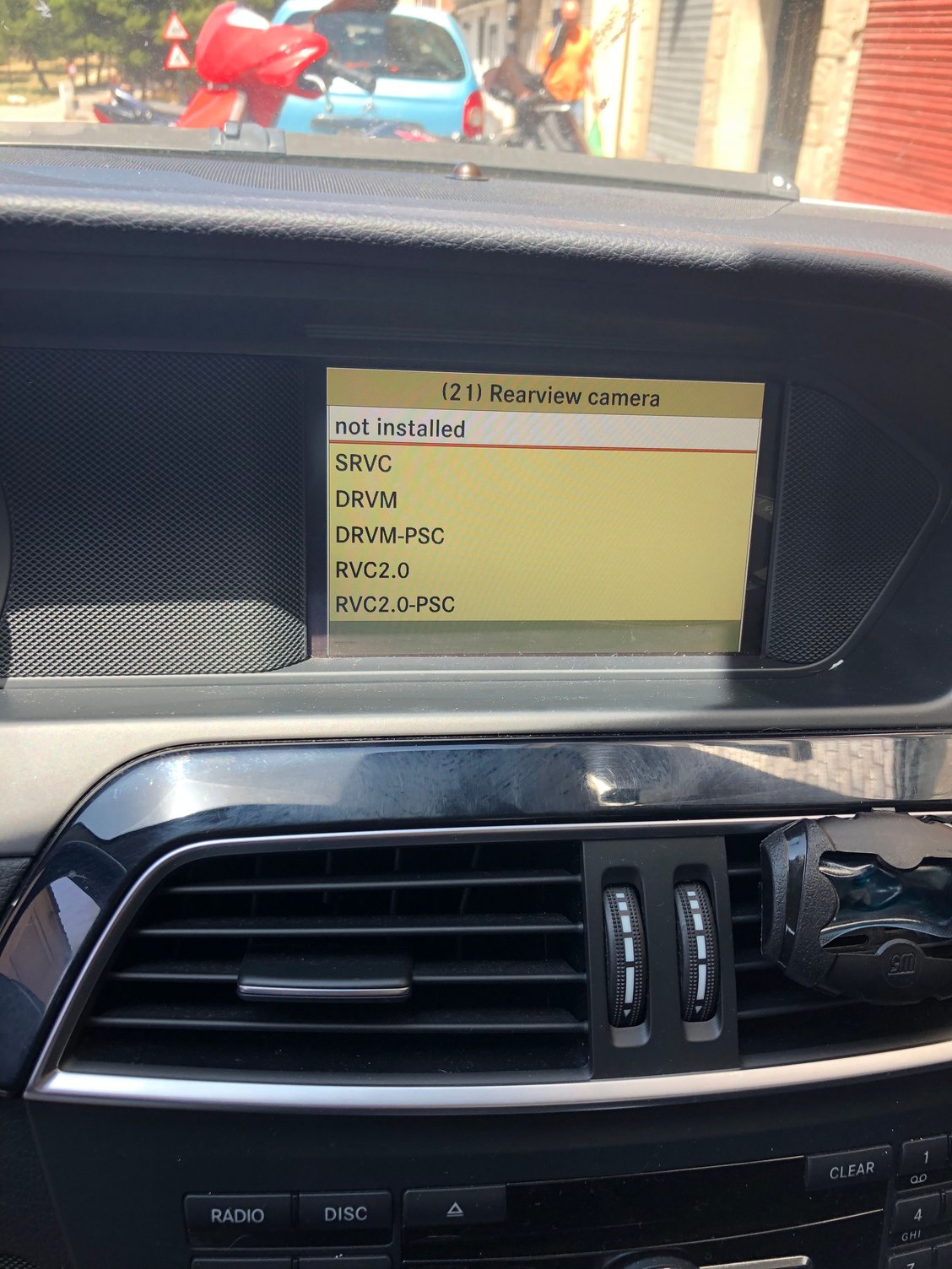

Shot story, buy a rear view camera with CCD sensor and 170.º angle. Install on one of the plastic square of the frame. Dont replace license light because then you will have diferent light color. Run power cable to fuse 71 near rear sam. Run video cable to front (get it from rear sam compartment that as a hole to front back seats, then down below frame, then up to a/c filter then to back of the NTG.
On the settings, select SRVC in engeneering and enable camera with R in settings.
