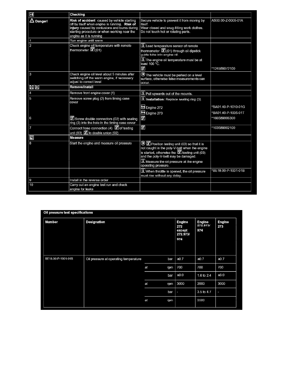

For LandonC300 to check M272 oil pressure
Old Aug 22, 2018 | 08:15 PM
Glyn M Ruck's Avatar
Super Moderator
Joined: Jun 2008
Posts: 19,942
Likes: 192
Old Aug 22, 2018 | 09:42 PM
LandonC300's Avatar
Joined: Aug 2018
Posts: 4
2008 C300 Sport
Thank you so much for your helpful reply. I will have to get a pressure gage and check this! I’ve read of a number of people with the knock at start up, but I haven’t read of any engine failures so maybe I am being paranoid...
