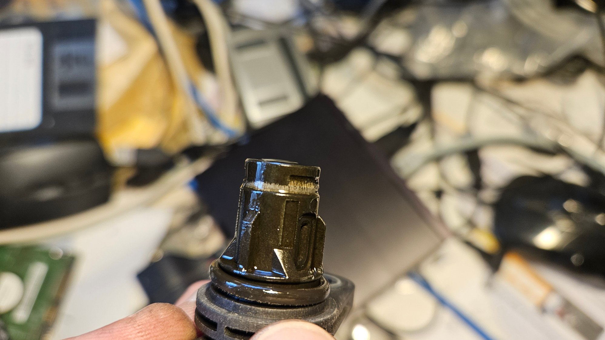

magnetized particles
that has got to be steel
nicely aligned contaminants captured by CPS...
This makes me wonder if the engine drain plug is like the rear differential: loaded with sparkles! Missing a premium $10 magnetic plug ?
