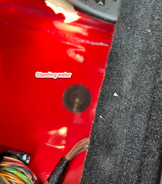

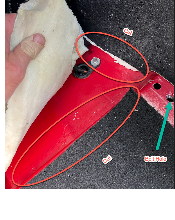

this is missing silicone RTV... just like the two rear blind spot radars: water enters right through the faulty wiring seals.
nearly  waterproof electrical connector
Tooo bad forum policy now disables contributors from EDITING posts after 4Hrs... so be it.

The water intrusion in that connector came from the water that puddled in the floor pan inside the car and not externally from driving through puddles.
