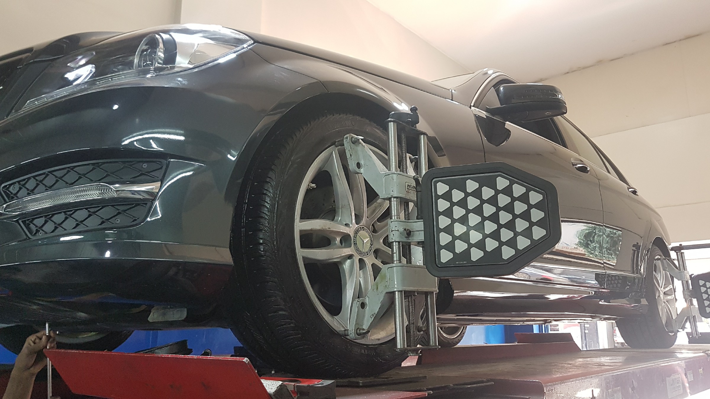

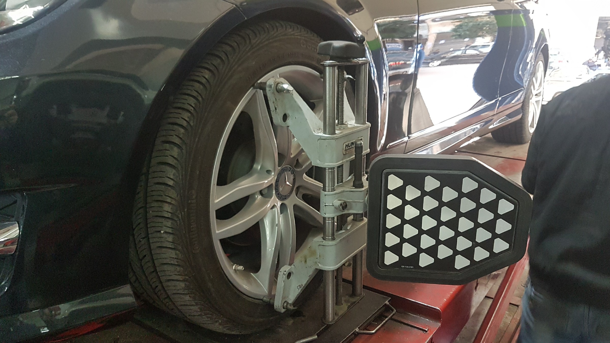

Day 6 - Full assembly, Alignment, and Mods
We spent the early morning hours yesterday finishing the assembly of the car and replacing the difuser with the quad one to later install the quad tips. I then drove the car to the alignment shop where it got a front and rear alignment to the T. The car drives perfect now. I took some underside pictures of the car because I was very amazed how clean it is underneath given the mileage obviously.
I then visited the muffler shop where we installed the quad tips after an hour of measurements and fine-tuning.
Pictures below

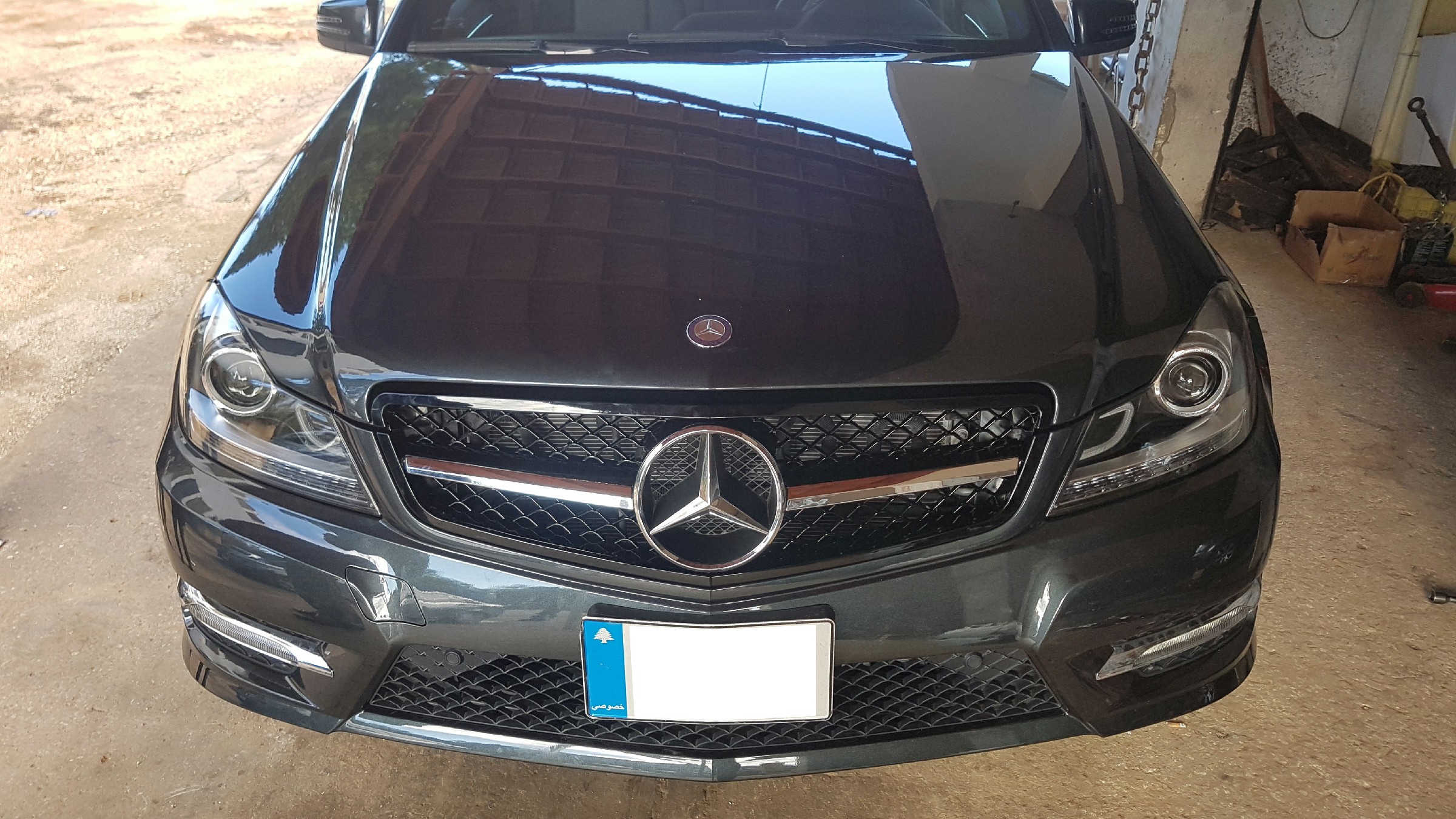

Nice!
As with many aftermarket grills, there is that gap at the top, which might make a whistling noise.
I know there is a fix but I have OEM grill so I don't know...but it should be here on mbworld
Thanks!
Yeah I noticed that gap right away but had no idea there's a fix. I'll look it up and apply it although I did not hear any whistling. The car is very very quiet.

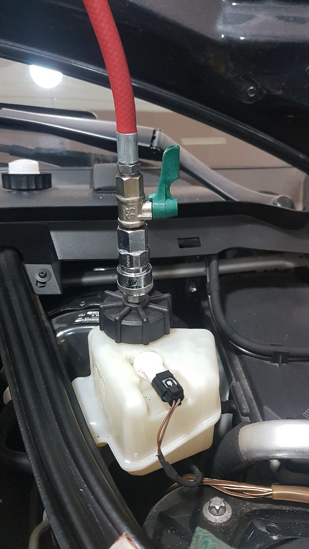

Day 10 - Engine Oil and Brake Fluid Change
Today, I changed the engine oil and the brake fluid for the car. The brake fluid has been in it from factory so it was definitely due. Regarding the oil change, I was told by a friend that the 4MATICs must be drained from below and not using an extractor from top because the front axle goes through the oil pan and extracting from the top would leave 1-2L inside. Contrary to that, extracting from top using both the plastic hose and then the grommet sealed around the oil dipstick opening extracted 6.8-6.9L of oil out of 7.0L. I then jacked the car and drained using the bolt and the remaining 0.1-0.2L drained out. For the future, I think I will use the drain method every other oil change.
As for the brake fluid, we used a special machine to pressurize the system and feed the new fresh fluid through the reservoir and then draining from each wheel until the color changes. The process used 1.5L of DOT4 Plus fluid.
