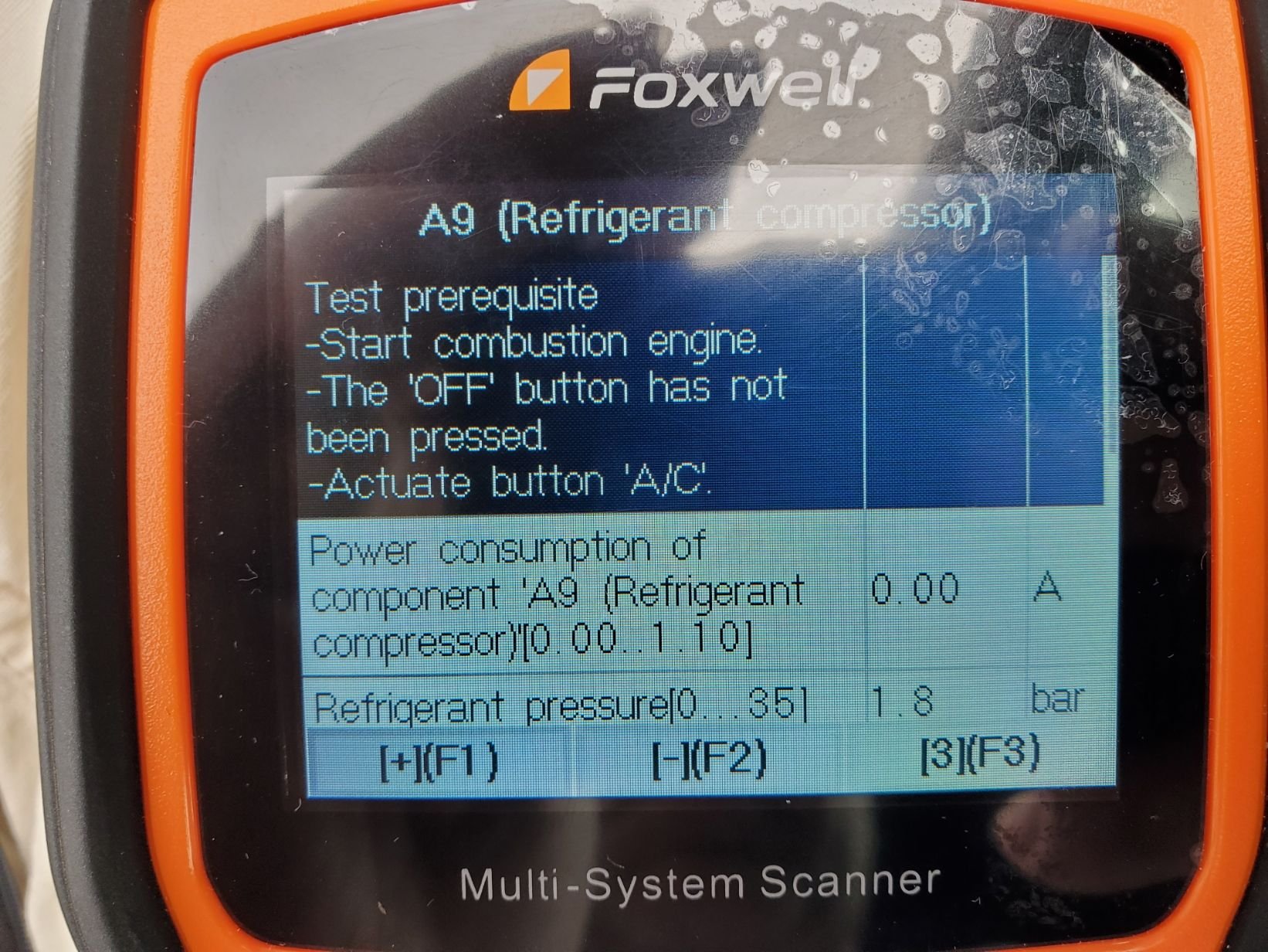

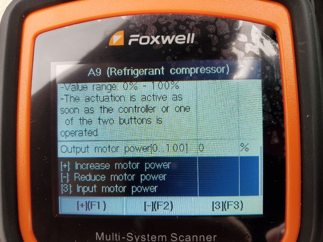

Old Aug 16, 2025 | 05:54 PM
TimC300's Avatar
Joined: Aug 2023
Posts: 3,791
Likes: 1,151
From: MA Coast
I would try testing for the noise with my obd scanner. There is a test function for the compressor that allows you to run it. See if the noise occurs at a specific speed/input.
