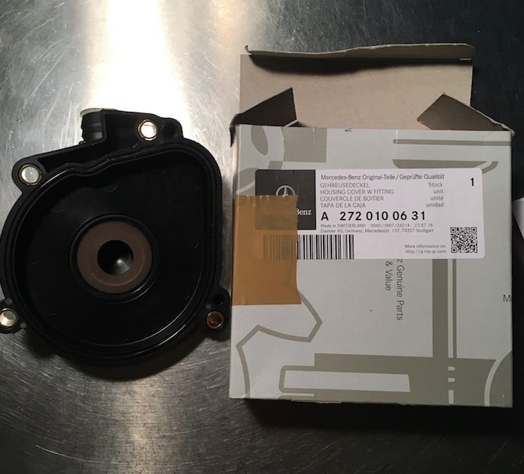

Breather Cover Lower Bolts Removal, Oil Drip Pan DIY
For anyone attempting this job, I will tell you it's a pain in the ***.
It's a challenge to get clearance even with a small vice grips. Why Mercedes put torx bolts on is just insanity..
PCV Breather Cover
Oil Drip Pan for PCV

UPDATE: Got Bolts Off
Using a small vice grip, I used a T30 Bit. Positioned it as close to the handle as possible.
DO not buy crescent vice grips. Total garbage...
It barely gave me clearance. Success!
Problem No. 2 Getting the oil drip pan out. The extension is too long to clear.
I believe an E10 fits the bolt but I can't verify with anything online.
Not sure what extension tool I need. Anyone?

Hard for me to visualize but maybe try a swivel socket attachment? That way the extension can clear

I ended up using an e10 with a 1.5 extension which barely clears the oil drip pan. Extremely tight getting the 3/8 drive ratchet on.
Using the e10 is not an exact fit as there is a little bit of play. Not sure what size the actual bolt is.
I used a T30 bit with 4 inch vice grips for the bolts on the breather cap which is a ***** to get to.
NOTE: I am going to swap the Torx bolts out for E10 bolts as it's too easy to strip. Space is super tight.
Not really sure what the best tools are.
If someone can add their thoughts on making this job easier. Thanks!

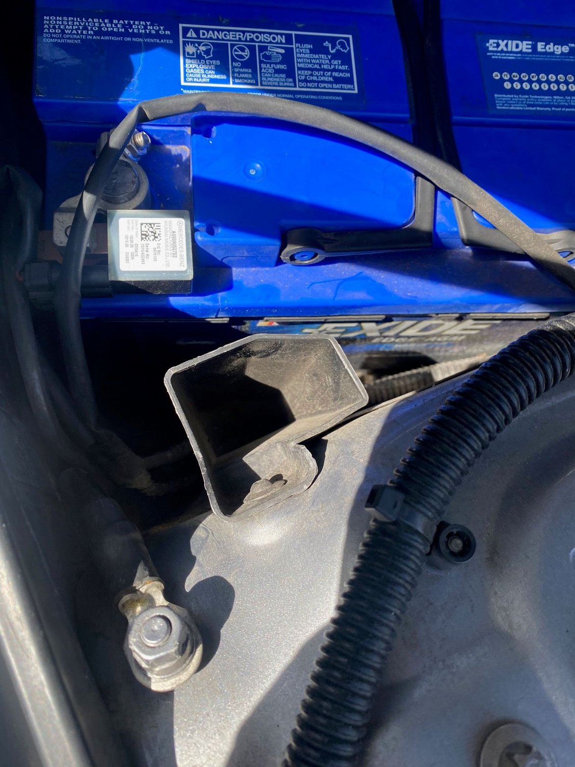

Random Question: Plastic Holder with Hose
While doing the PCV, I noticed this plastic holder with a thin hose.
Does anyone know what this does?
