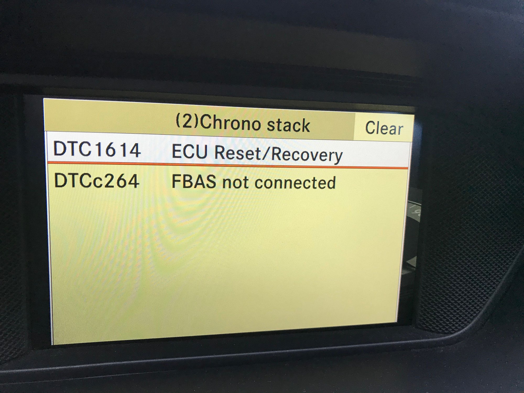

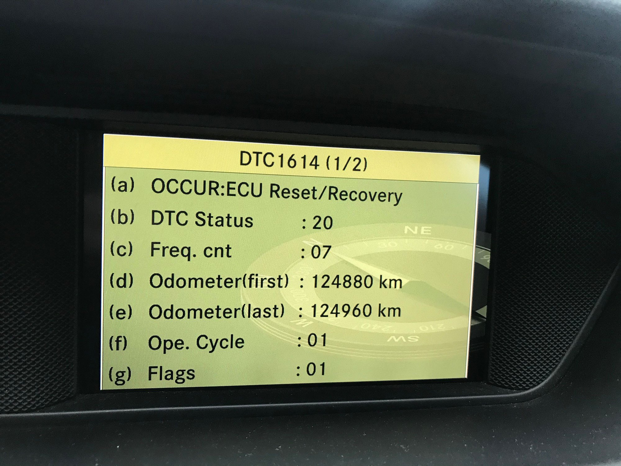

New info ...
I went into engineering mode and located a fault that was logged at my current mileage. See photos ...

Engineering mode
push Hangup # 1 at the same time with unit on for 5 seconds or so.

I stopped by the dealership to ask about it and they told me about the sirius XM issue and that the problem would go away once they fix the update. Strangely enough, it stopped happening on the way to the dealership. I did eventually look in the engineering menu again and found out that the errors I had were from about 45K miles ago. All is good.
