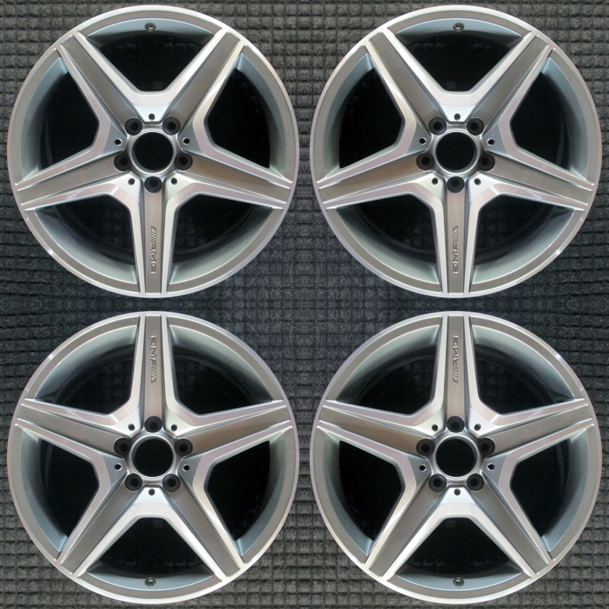

Hello, searched around but ended up just confusing my self with tire sizes..
just got new oem c63 rims and was wondering what tire size should i run on the rear.
front rim: 18x8 ET45 (A2044013902) Probably will run 235/40/18 tires.
rear rim: 18x9 ET54 (A2044014002) was wondering if I can run 265/40/18 or 265/35/18 with out rubbing ofc. Dont really wanna run 255/35 or 40/18.
2013 c300 4matic sport. Live in the area with bad roads.
thanks you.

"Live in the area with bad roads." Then you should be running 17" with high profile tyres !!!
The rolling radius of the front and rear tyres should be within a few percent of each other or you will have isses with electronic systems that measure the tyre rotation speed.

i have stock 17s right now with the profile of 40 just like i want for new set of wheels but 18s. I checked the website, it doesn't tell if it will rub or no. Will that electronic system five me checkengine light?

https://www.alloywheelsdirect.net/me...g_vi_wheel_511
Recommended tyre sizes lower down the page.

I have looked into those and never saw the actual answer from people fitting a C63 rim on a c300-350. Most of the folks don't put oe size on these rims so I am just curious what they ended up using.
