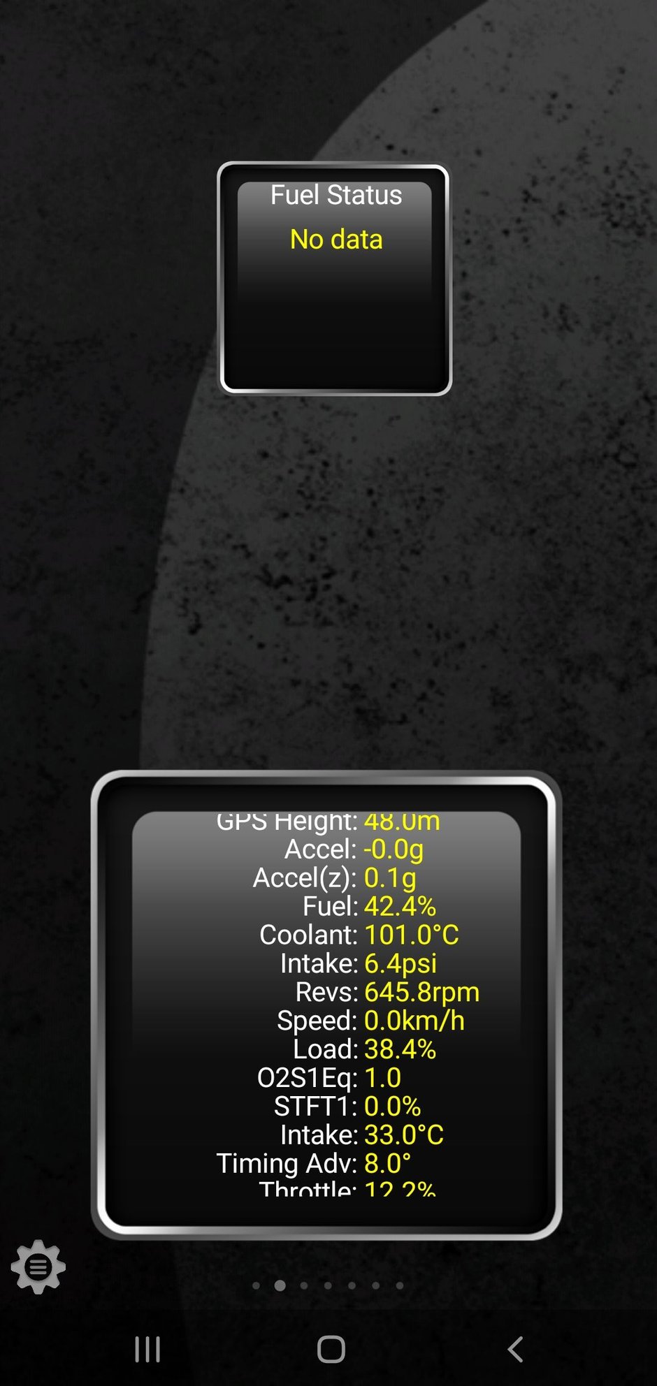

my dash temp never gets over 90c but the odb reading can get as high as 105c. are these readings from different sensors?

It is normal for the dash temps to be "massaged" so they stay in a fairly narrow range unless there is serious overheating.
