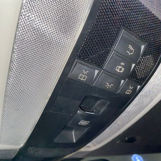

ISSUE: Dome light will go on when I use button or open door. Rear ceiling light does power.
No blown fuses that I can see.
Looking at the fuse diagram, I don’t know what to look for:
Can anyone help?

UPDATE: Still Unsolved.
Removed the 17 fuse. No ceiling lights worked after removing it.
No issue with rain sensor.
I have to assume that this has shorted inside or the button on the console is bad...

Did you ever manage to sort this out? I have the exact same issue. Dome light works when opening the door and using the key but none of the buttons work for the front dome light. Sunroof button works as do the rear dome lights.
I replaced the unit by buying a used one off ebay. Issue was resolved.
