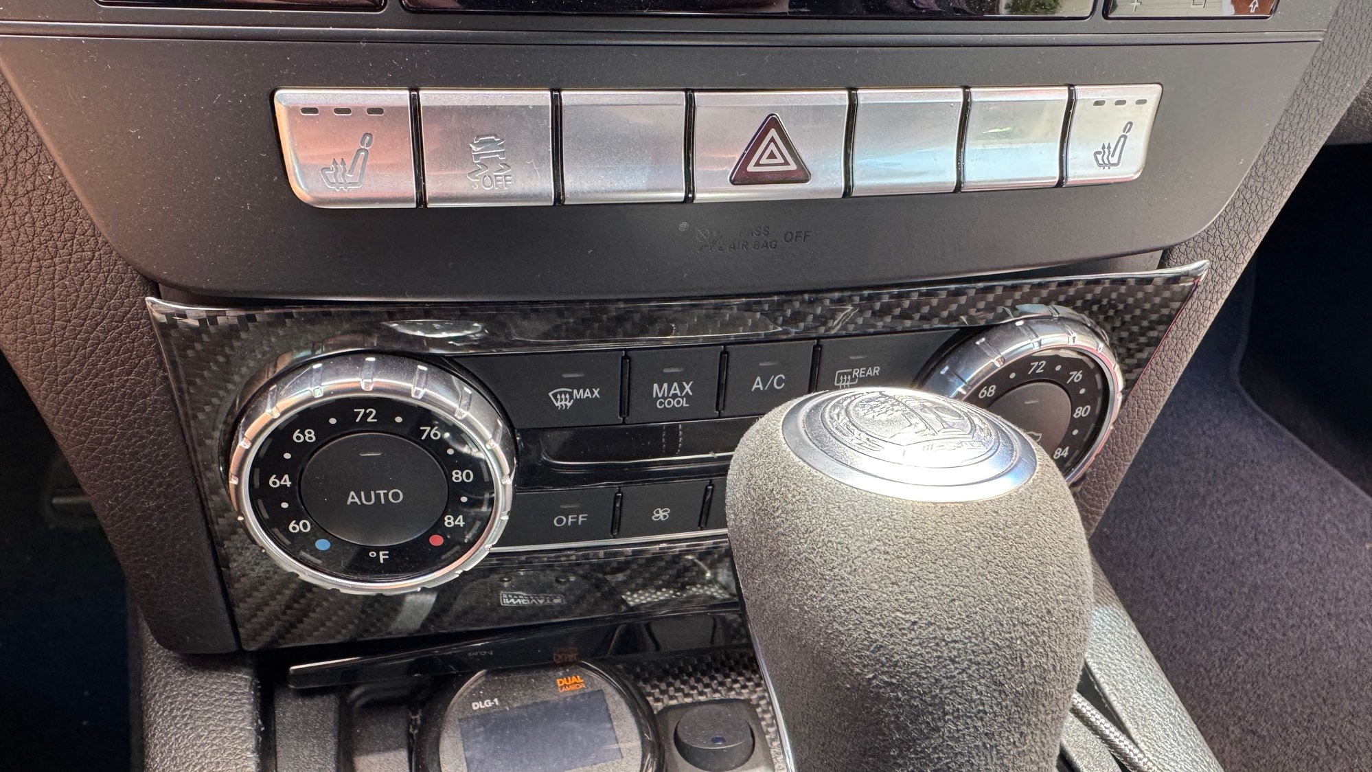

Just got her back yesterday. Today as I was looking around the interior for spots to place toggle switches for my diff and aux trans coolers, I noticed that my "carbon" AC surround looked funny...
That's weird, right? Let's investigate further.

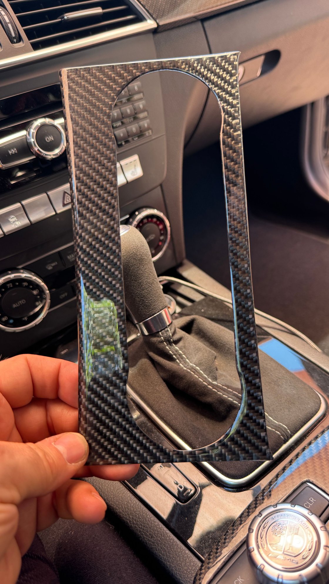

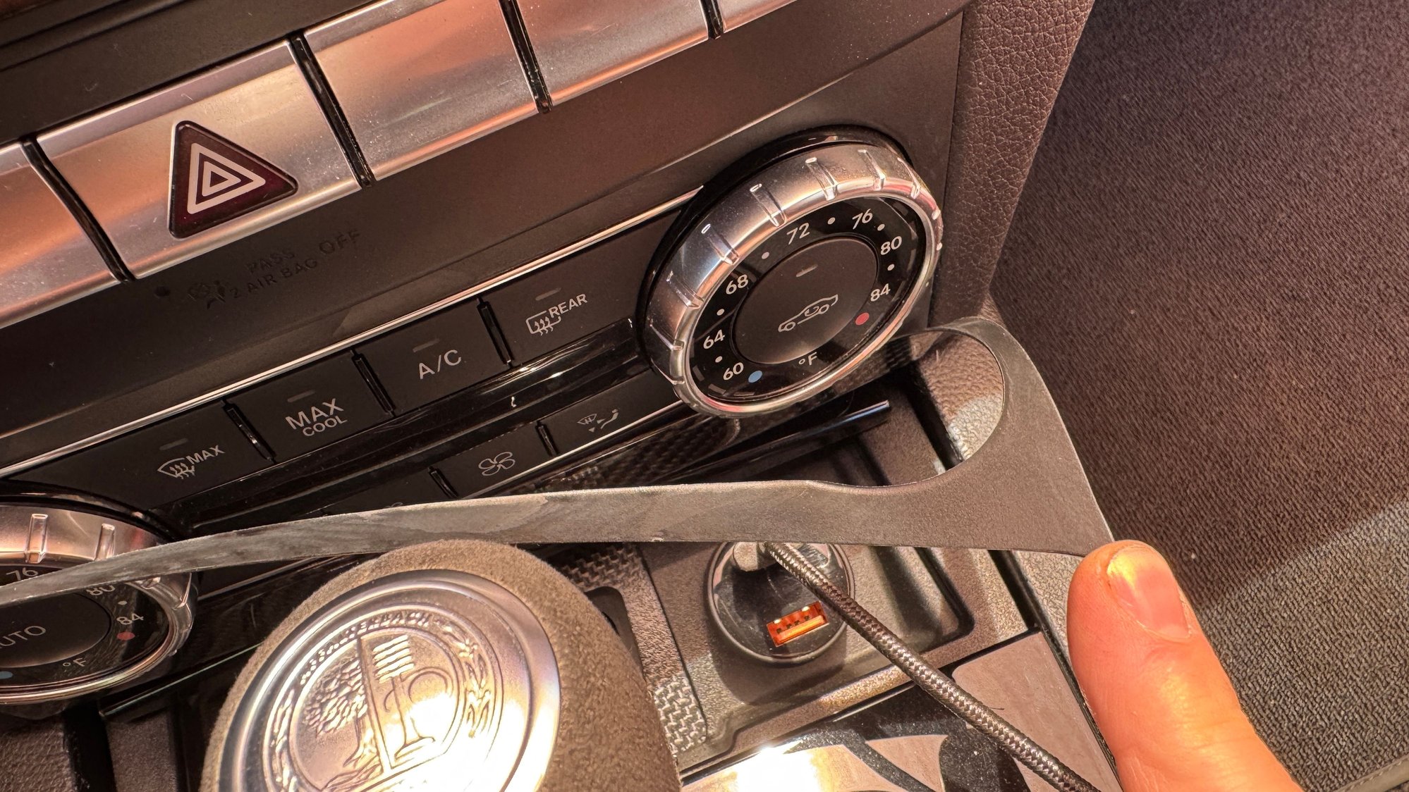

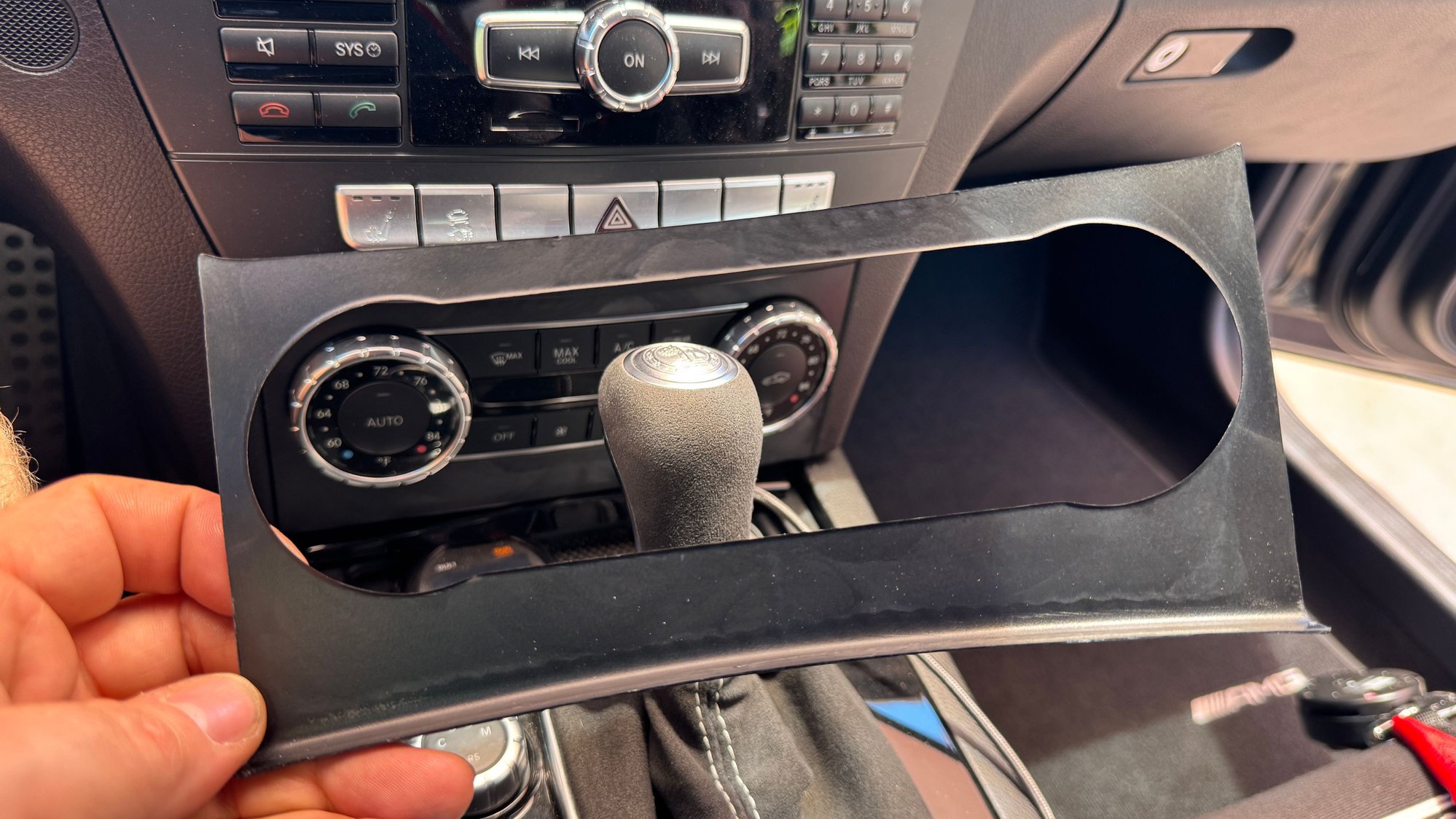

Uh oh. I've skinned a bunch of carbon trim pieces. You have to sand down and rough up the OEM part to get the surface to take the carbon skin and epoxy while also not being larger dimensionally than the OEM trim piece. The OEM trim piece as you can see here is untouched. That's a bad sign. Let's keep picking...
Bro. That's a fukin carbon sticker. I'm surprised it didn't peel away earlier, this has been on for 7 or 8 years.

Now that I'm looking at it more carefully, I think he was probably just mass-producing these thin overlay skins from a mold on their own - clearly without actually individually skinning and keying/sanding the OEM trim piece donors he received - instead just gluing them on with a thin superglue or something (although there's no evidence of any kind of glue residue here).

Same thing happened to every piece I bought, likely from the same guy. TERRIBLE quality. Happened to me in less than a year. fit terrible from the start, burned into the carbon when finishing. I warn everyone when I see it pop up. But I will say I only tried him after a big euro company blew me off when their lifetime warrantied shifter surround had the epoxy darken. As you mention, China is better and cheaper than most of these crooks. I even ripped apart bunch of his crap and covered it in Alcantara, I was so pissed. I made a thread with pics on that subject.

Yeah man you got played for sure. A true carbon skinned part will not come apart. The epoxy quite literally mates itself with the surface it’s on. What you have was probably held with 3m tape (old 3m tape held on great!) $200 is a fair price for a real skin job by 2018 standards

It was glued down, but it was not glued with any sort of glue that was proper. Let’s just say the surface wasn’t prepped right, the parts were not finished right, the parts were not able to fit in without further shaving, one part came with a scratch due to shipping. I spent at least $2000 for the entire center console and rear vent. It literally was the biggest waste of money I’ve made on a car in over 30 years of driving (besides once owning a cpo bimmer)

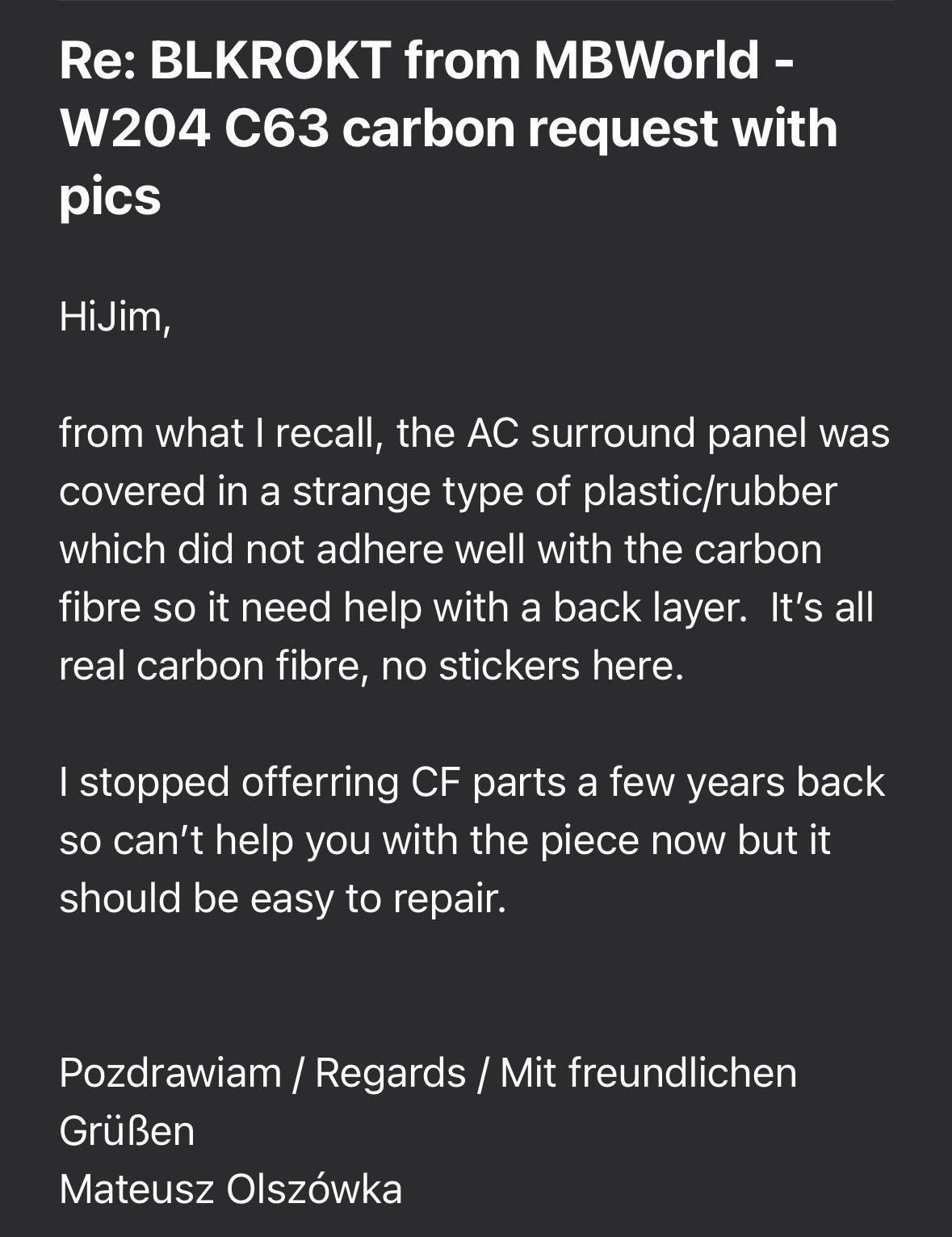

Got a reply from him. Guess he didn't want to show up in this thread. Chickenshít.
Confirmed zero surface prep. He was just gluing carbon stickers on. Doubt any of it is real carbon, doesn't look like it.
Says he's not making his shìt parts anymore. Yet I see him all over the forum.
