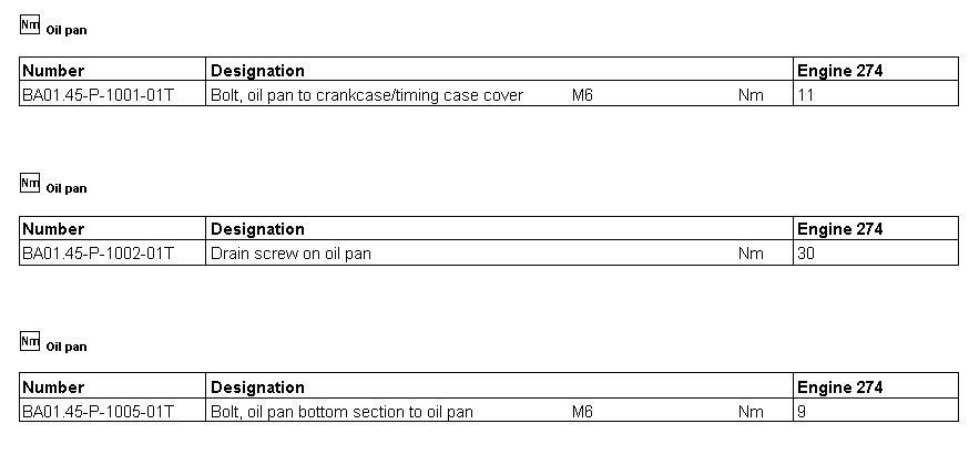

I don’t know if anybody is still on this thread, I’m currently changing my upper oil pan on my 2009 c300 4matic. It was a pain of a job so far, I have the new pan in with the bolts snug letting the gasket maker dry, I can’t find the torque specs anywhere do you know the specs for the car?
Old Aug 5, 2023 | 09:44 PM
  #56
troublesolver's Avatar
Joined: Aug 2023
E63 AMG S
Not 100% sure on what exact model you have without a VIN, but these torques are for both the c300 T-model and c300 4matic limousine.
