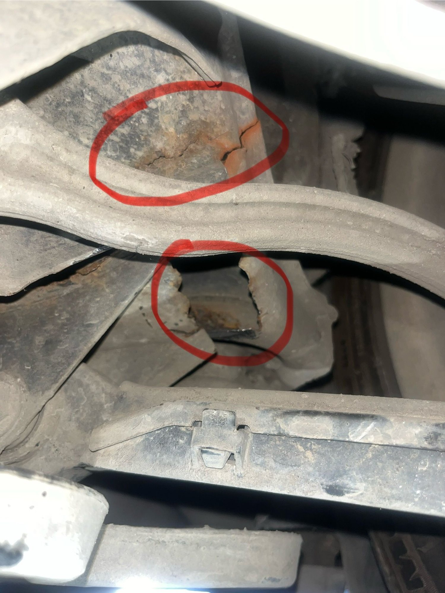

I guess it has affected me too. Car drifted after an abrupt stop. Took the car to the mechanic and he test drove it. Told me my rear subframe is damaged and needed replacement. Bought the car 5 years ago from the US at 137000 miles. It’s now 162000 miles. It’s a 2008 c 300.
was thinking could it be welded or it has to be completely changed? Below is a picture of the damage. It’s at the right side.

Originally Posted by Obi3ice
...was thinking could it be welded...
Why? It's covered by the extended warranty. Or not where you are?

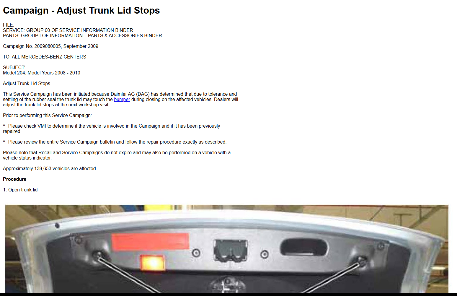

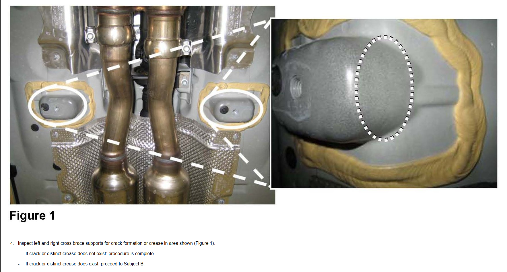

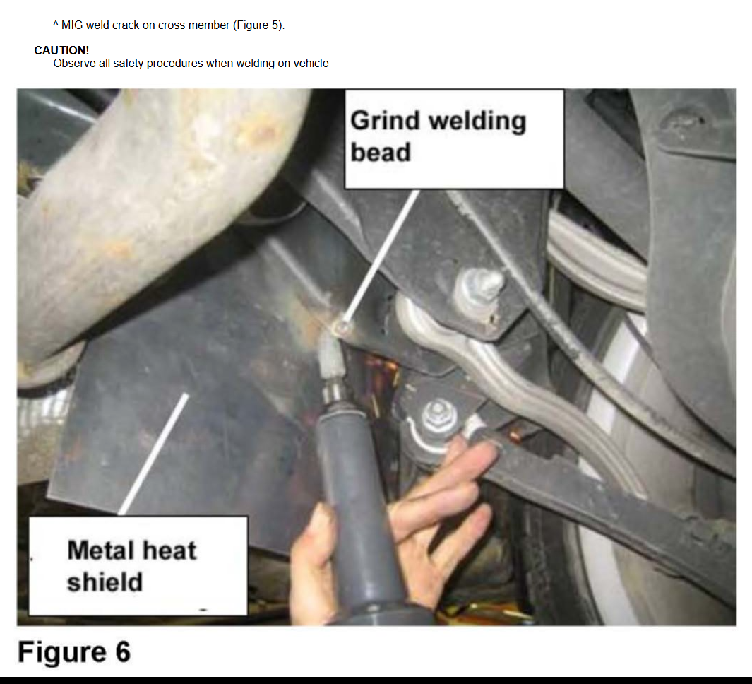

Congratulations you get a free rear subframe. From my understanding the new subframe should come with all new bushings/silent blocks installed. This would be a great time to have any faulty rear control arms replaced, they should only charge you a minimal labor fee since most of the work is already being performed.
I only came across two instances where they say welding is approved for repairs. I'll show them just for everyones knowledge.
This one looks very limited to only a few certain frames:
Heres one for the middle crossmember area:
Heres something not related I just happen to find it right now. Deals with the trunk stops.
Unfortunately not covered where I am.
