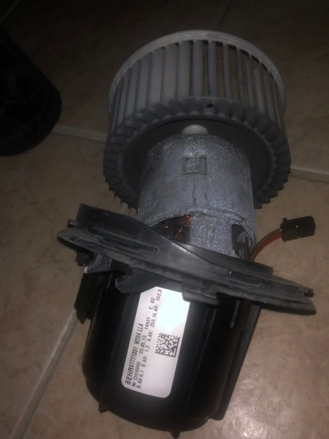

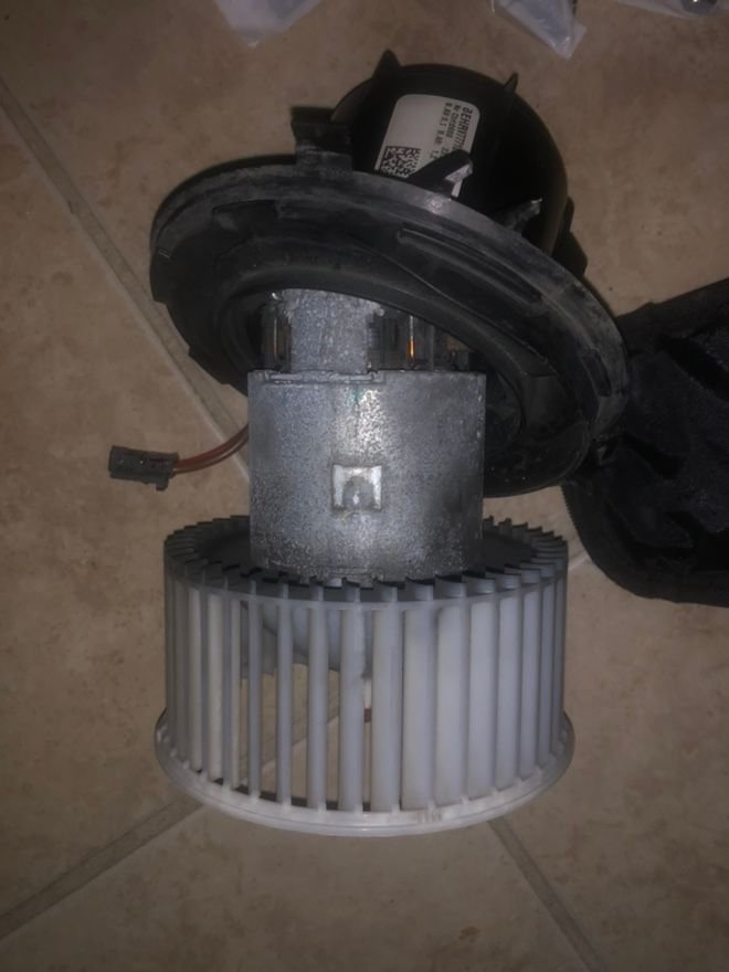

So I ripped it out today, and found that the passenger side footwell panel, the insulation part of it, was a tiny bit damp. After inspecting the motor itself, the black plastic housing was perhaps about 10% wet as well. The hole that the fan came out of seemed to be only about 5% wet in the same area. So condensation seems to be the culprit? Guessing with the extreme cold, and the heat in the blower, there has been condensation forming in there. As there is no other trace of water from anywhere, not even when looking from the engine side of things. Question now is how do I stop it from happening again? I'm popping another newer motor in there. Would hate to have to go though this again. Thoughts? Thanks
