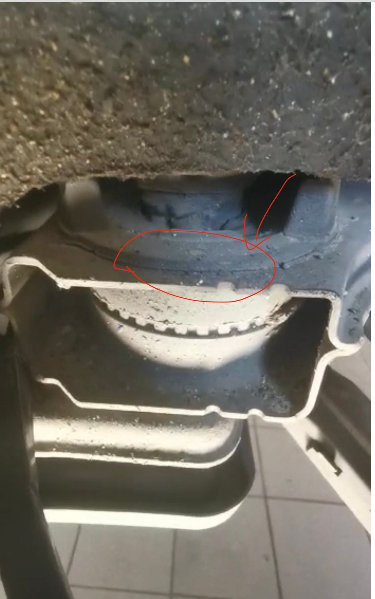

Hello guys, can you please assist with the below?
It seems that the rear wheel rubber is damaged and needs to be replaced. I can feel it that sometimes the car kicks and I believe this is the problem.
What replacement rubber should I look for?
what do you believe is the less costly solution for this replacement?

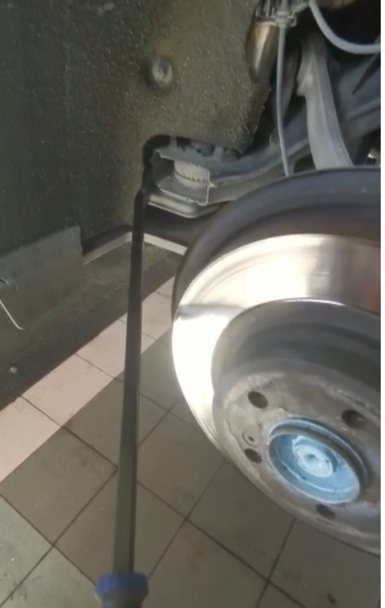

Can you zoom out and give a picture that shows a larger area? I'm having a hard time figuring out what I'm looking at in that close-up picture.
Also, what are the details on your W204 - what year, model, drivetrain (RWD or AWD)?

Mar 14, 2022 | 05:53 PM
Well, it's some kind of bushing. Look for rear end suspension parts on a site like mbparts.mbusa.com and then go to www.fcpeuro.com and see if you can find it cheaper.
Look here: This is for a C350 but I suspect they will be similar if not the same. You're looking for a suspension crossmember bushing. I suspect the rear bushing.

Mar 14, 2022 | 09:35 PM
A 2011 C250 wouldn’t be a US car. I think the OP is in Cyprus. #14 Suspension Crossmember Front Mount maybe? I think a Mercedes dealer parts desk could clarify this. I wouldn’t expect them to charge anything for a parts ID. But even at Mercedes prices, these bushings don’t seem too expensive.
