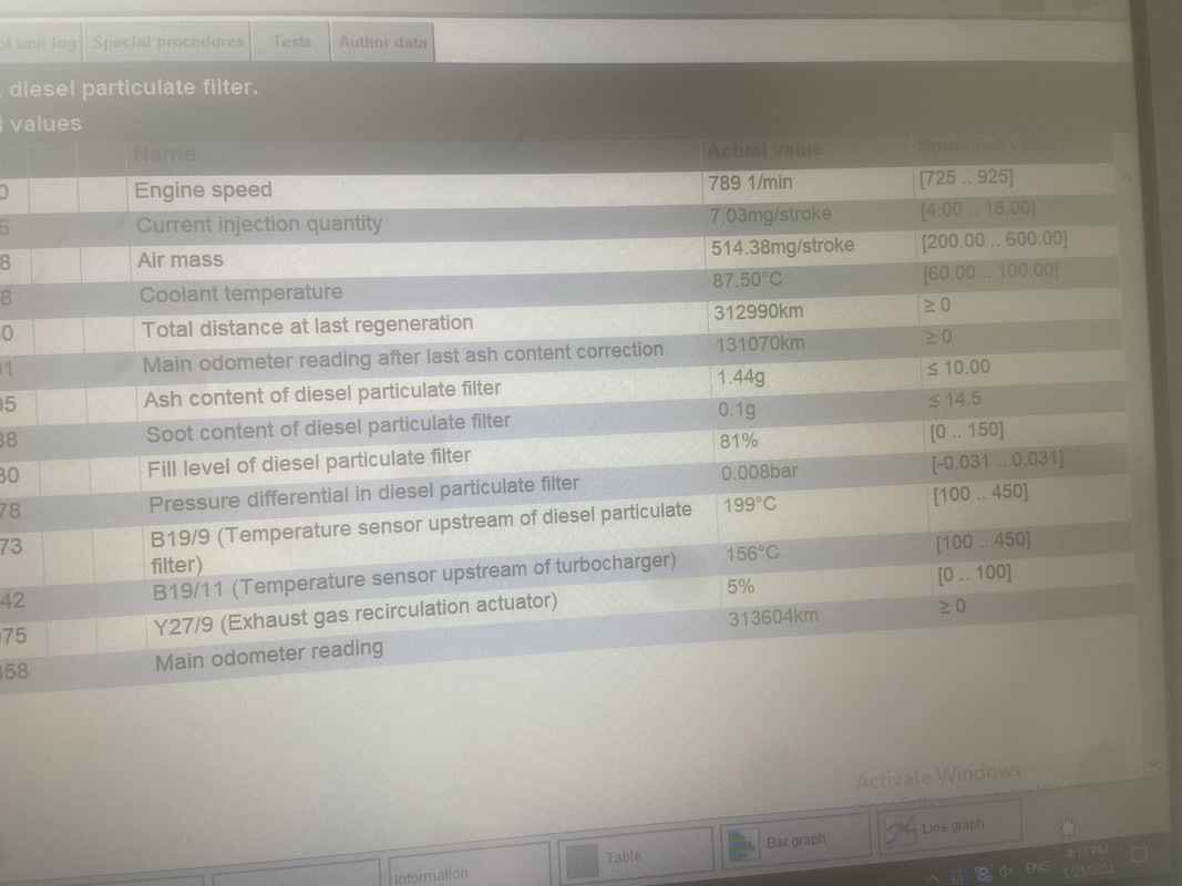

Hi guys, 07 c200cdi here. Did a scan and the soot level is at 86%. Took it for a drive yesterday but it did not regen. I wonder if there is something to worry about it.
im unable to attach the scan results here buy here's the link i uploaded to https://i.postimg.cc/hGzbfcqQ/FDB95-FCE-598-F-4-F18-A3-AC-8-CD7-CB567541.jpg
i'm doing a long trip today and hope it will regen itself but let me know as i'm in a worry honestly

Looks like it regenned 2000km or so ago so everything appears to be normal.
I used to monitor mine but I have stopped now as it just seems to work and I can never tell when it is regenerating and I drive like a granny !

have you checked to see if your car has a DPF fitted? Check for pressure sensor on the exhaust because my 2009 c220 has 2 cats no dpf but xentry does show dpf values…

Dpf regeneration will only start at a fill level is 100%
