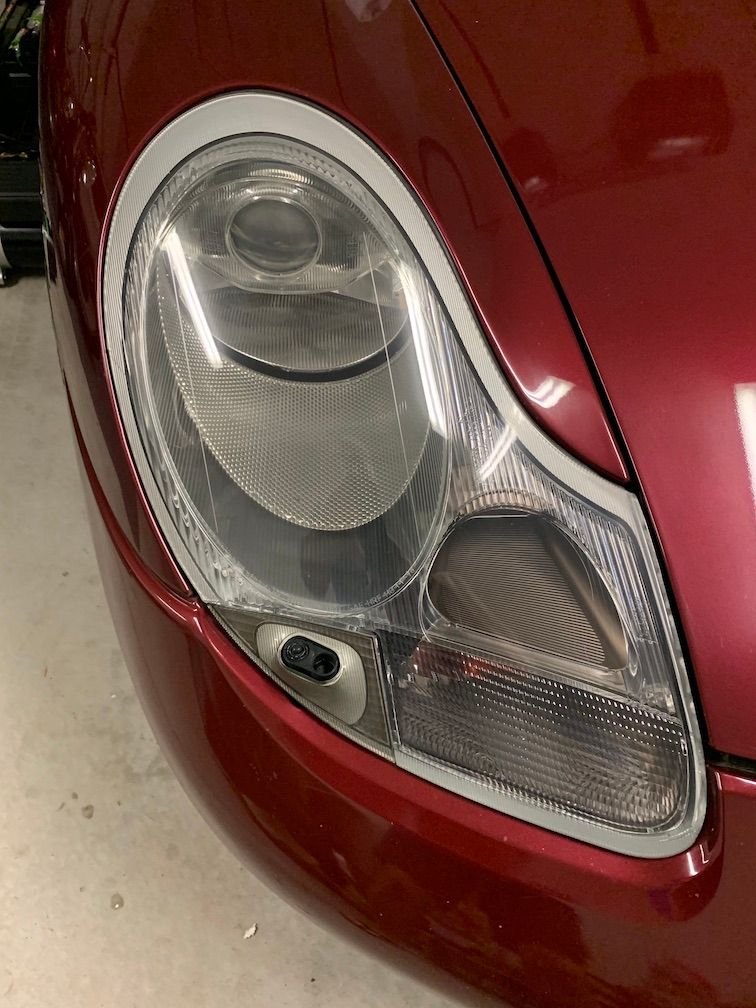

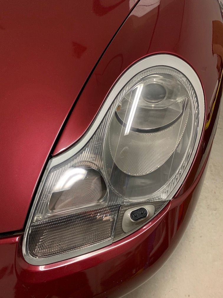

Another possibility. I removed the headlights in my Boxster and had them sanded then clear-coated at a local body shop. The result is impressive, and because they are clear-coated, you can apply wax as you would to the paint to protect the finish.
Left Headlight
Right Headlight
