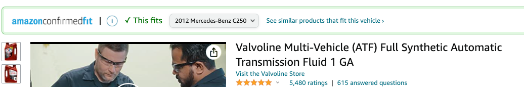

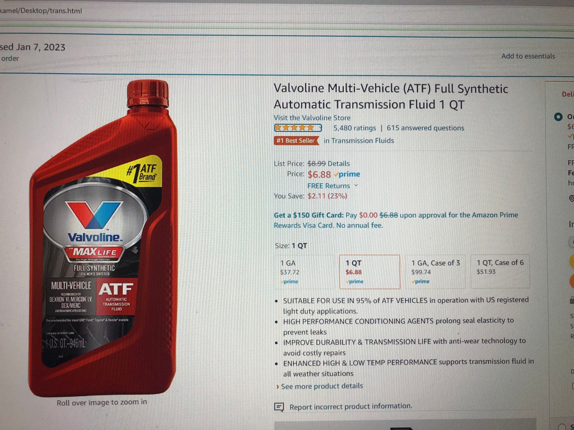

Even though Amazon says it "fits", I would independently verify this. It needs to meet specification MB-236.15 and/or referred to as ATF-134FE. I do not see that on the label.
I also don't trust the Valvoline site because it says that Max Life stuff is 236.14 and 236.15 compatible, but you cannot mix 236.14 and 236.15. Maybe if you somehow could completely flush out all the old fluid (to include the torque converter and transmission cooler), using only the Valvoline stuff might work, but why take that risk.
Bottom line: Get the right stuff! Don't try to save a few extra bucks on a service that you do every couple of years.

I know there are some on this forum that say Valvoline Max Life is okay. Valvoline claims that Max Life works in just about everything. But its not on the BeVo. What is on the BeVo are the approved fluids Valvoline ATF Pro 236.14 and 236.15. Even in the Valvoline brand, the two fluids are separate.
Every Mercedes C-Class W204 built after June 21, 2010 with a 7 speed automatic has transmission 722.9 7G Tronic Plus (code A89) and requires a fluid meeting specification 236.15. You have a 2012, so that should include your car.
Whether Valvoline’s claims are valid is up to the user to determine. But all these manufacturers design the transmission fluid to have specific friction and viscosity characteristics to perform well with the clutch material used while providing the lubrication needed. I personally suspect that an Allison sitting between a Cummins highway diesel and an 80,000 pound load has very different requirements from a 200 HP I-4 pulling a 3500 pound sedan.
