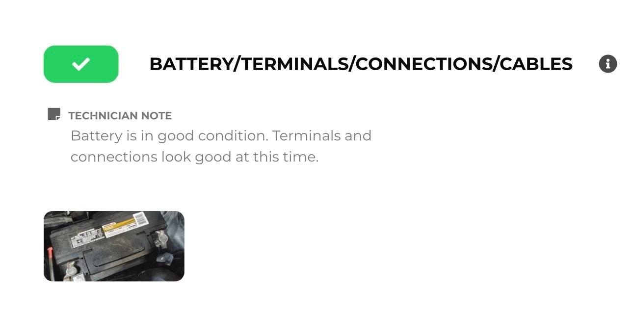

Mar 20, 2023 | 10:38 PM
Thanks Adi I will check into the scanner.
Did not think to change the battery as I had it checked at the shop and they said it was fine and they couldn’t figure out what was wrong. That and it still does start sometimes which didn’t think that was possible if the battery was dead. Will have the battery checked tomorrow though.
Plus all other electronics in the car work fine still.

Mar 21, 2023 | 06:28 AM
Quote: Did you replace the battery yet
would the battery just nosedive a month later for no reason?
Reply 0

Mar 21, 2023 | 12:55 PM
yessir
it's amazing how many threads on this forum have a resolution where a battery needs to be replaced and it solves the issue
Reply 0
