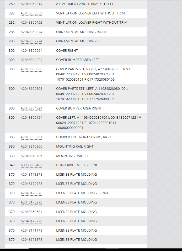

I found some part #s, but the diagrams is for my 2010 C300 but may be the same. The spring may be 2048550001

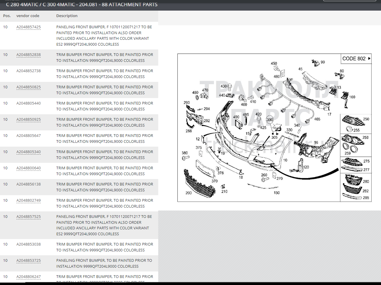

Im not sure what the difference is between Code 801 and 802.
