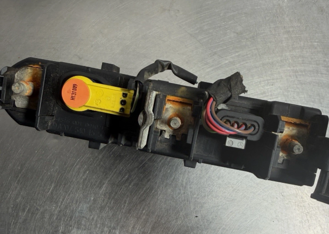

Does anyone know how to disconnect pyrofuse from prefuse box??? I've heard of people accidentally breaking them. Here is a pic

Hidden beneath the blue rubber piece are 2 plastic ears, 180 degrees apart, that need to be squeezed to release pyrofuse.

So basically squeeze blue part in very hard then pull out?
Old May 7, 2023 | 12:16 PM
gamma300C's Avatar
Joined: Jun 2017
Posts: 608
Likes: 107
From: Western NC
2009 MB C300 Sport 4matic
That's my feeling...the one prior poster pried up without releasing tabs and broke the base where the tabs engaged. The replacement profuse fit back in fairly snug luckily.

Heard that you lift up the orange tab, may you can ;look at the old one to see what it does.

You pull up the top cap on the pyro to release it, easy as
The resister is to fool the computer to say the fuse is not blown.
It will not fix a blown fuse.
The Mercs have many high current fuses hidden in modules, in the ML I had a blown fuse in the module under the drivers floor. This gave an indication of a blown PYRO and all sorts of funny things like airbag faults no start etc.
I had to physically track the battery cables to find.
The fuses can be replaced, I think i have a post on it somewhere
I had a pyro error after all that and it was actually because the plug was seating. You have to pull the cap up, put plug in and push cap down. It actuates the plastic tabs people mention here that work like a clamp to connect. Do not try and mess with those little things the plugs are near impossible to find.

No squeezing necessary to get this off, simply pry up on the orange cap, it lifts up and the plug comes off easily.

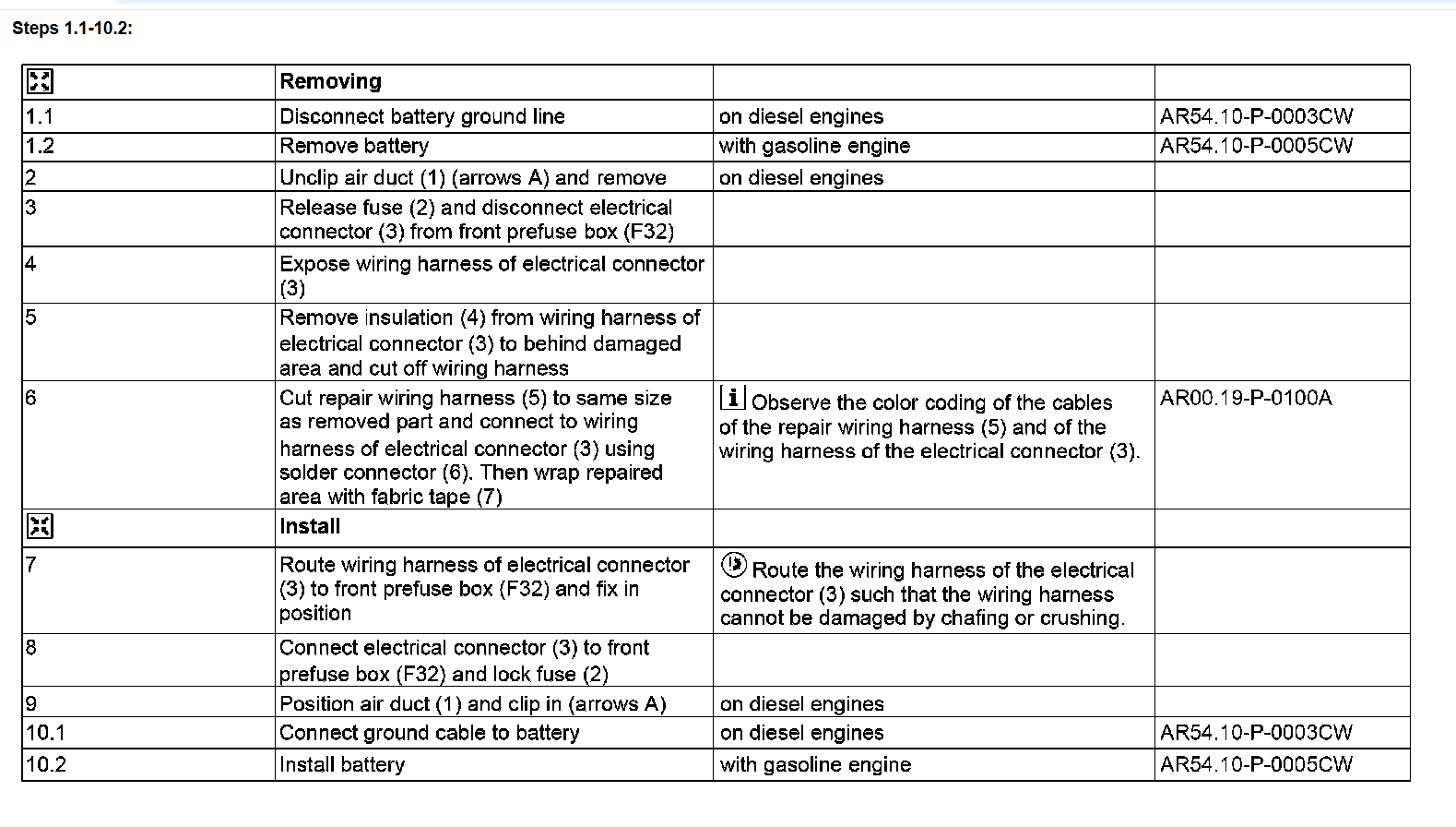

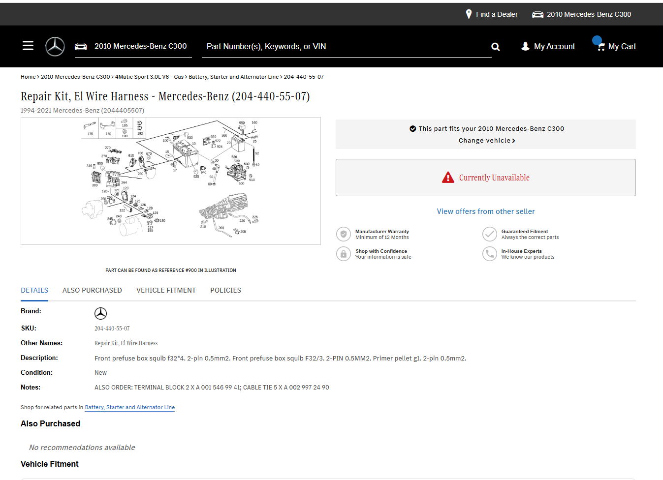

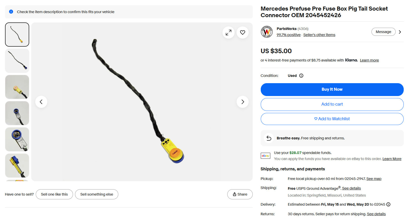

If there is an issue with it then best to replace it. Instructions are pretty straight forward. Can always buy a used one since new dont appear to be available. Can even buy a used F32 and remove the one in it, just make sure its still in there.

I just ordered one earlier today from mbusa. I didn’t get an indication it wasn’t available, yet anyway.

Hopefully they have it or there is a different part #.

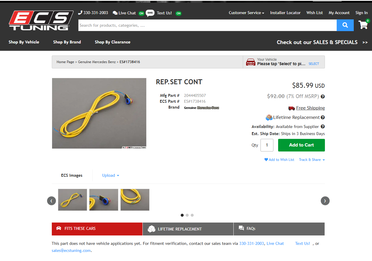

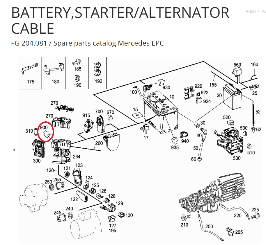

I was curious how much a replacement costs so looked up my parts diagrams for the part# and all the Mercedes branded websites say its unavailable. Just looked again and ESC seems to have it though. I found a few on ebay though they had different part #'s but all started with 204*******. They look the same.
I didnt look in my car so who knows what part# is in there. Its why I didnt bother posting part #'s above since I didnt want to confuse anyone and its best to look in the car for the exact part#.

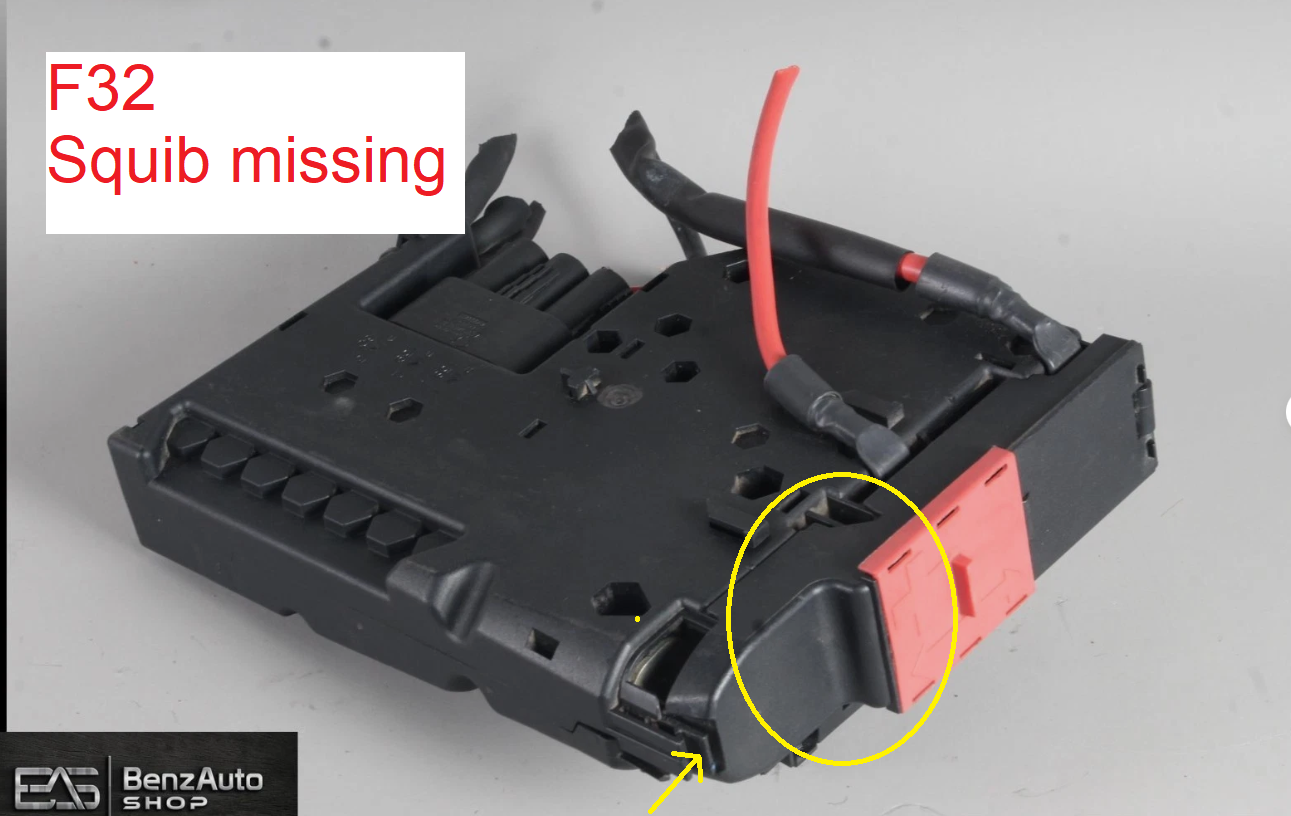

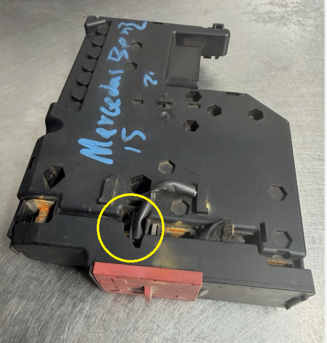

Does anyone know how to open this F32 prefuse box or have the procedure? I know there are tabs to release it but I was having trouble getting them to release.

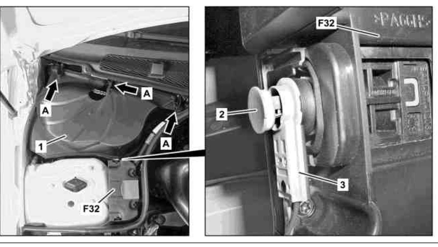

You can see the locking tab in the photo above to the left of the yellow circle.
Push the top of the tab on the cover in and it should unhook.

Thank you Tim - but I was talking about how to open the box completely to replace the pyro fuse. I got it though. This is from a G550, the F32/3 pre fuse box.
