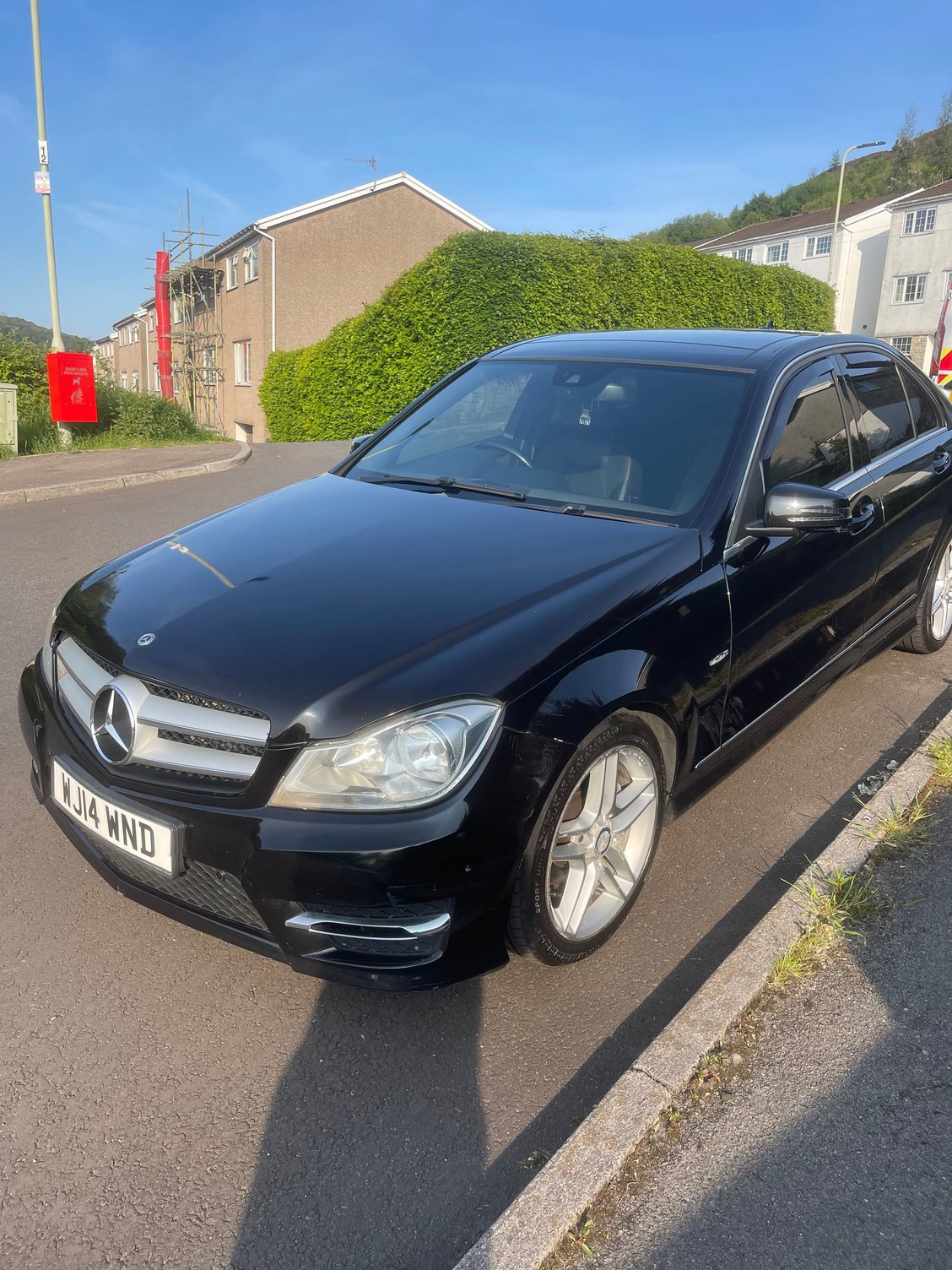

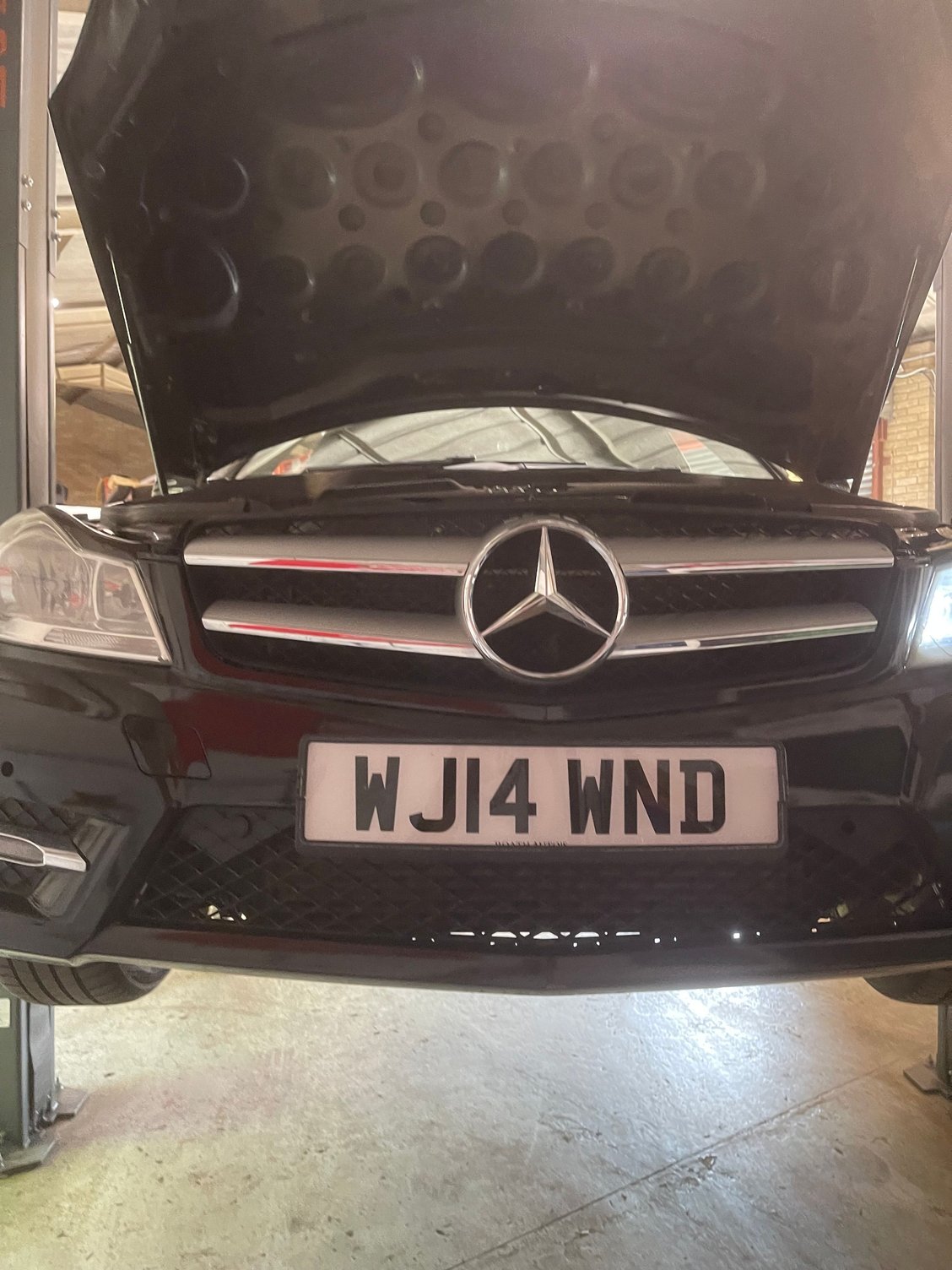

photos ?

Old Jun 1, 2023 | 11:28 AM
spb147's Avatar
Joined: Jan 2022
Posts: 104
W204 2013 C250 Coupe
thats the facelift model

The temp sensor cable showld be in the horm loom from what I can see.
Do you have the correct front bumper for the car ?
Can you decode the VIN and see exactly whick model/trim you have ?
Those DRL looks like they are for the AMG trim, maybe....the whole area is a minefield for me :-{{
