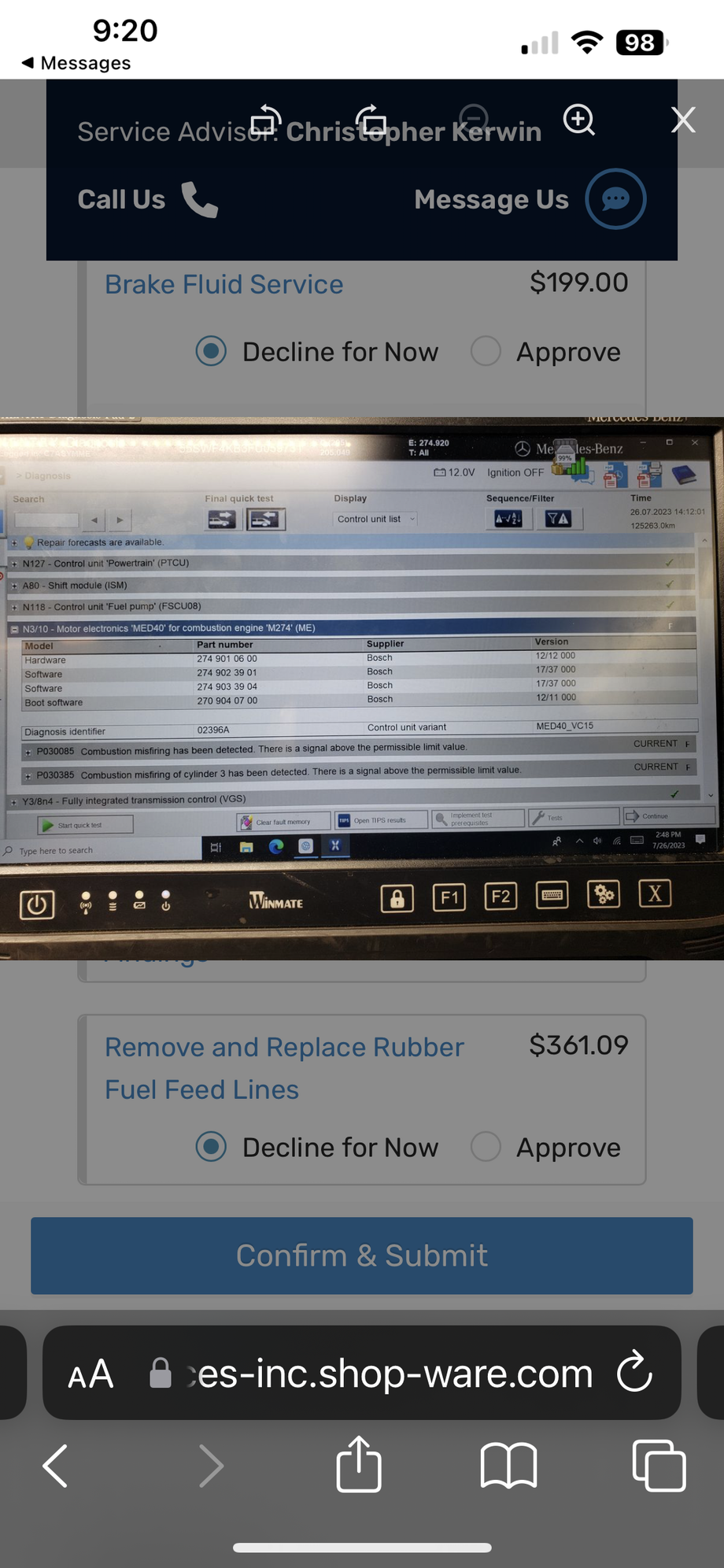

Not sure what we're looking at. Any reason given to replace fuel lines?

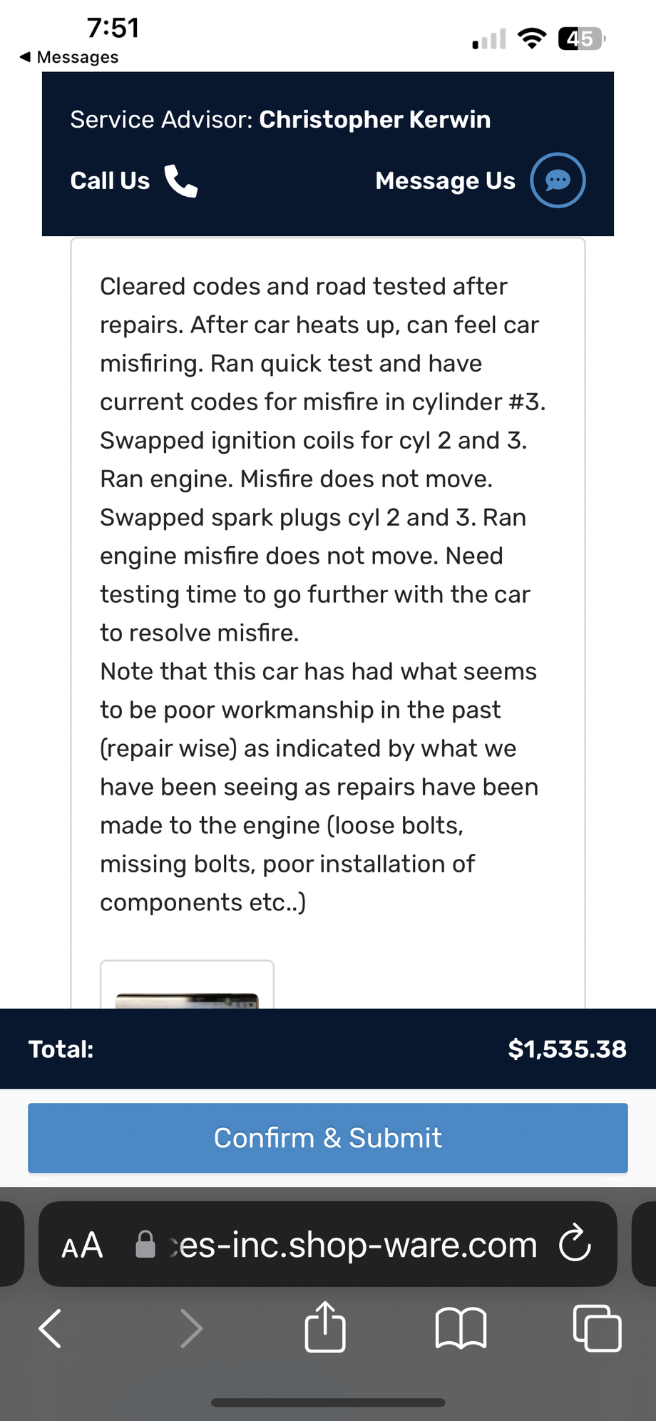

i sent a picture of the mechanics notes. It reads:
Cleared codes and road tested after repairs. After car heats up,can feel car misfiring. Ran quick test and HAVE CURRENT CODES FOR MIFIRE IN CYLINDER 3. Swapped ignition coils for cyl 2 and 3. Ran engine. Misfire does not move. Swapped spark plugs for cyl 2 and 3. Ran engine. Misfire does not move. Need testting time to go further with the car to resolve imisfire.($450) Note- This car had whatseems to be poor workmanship in the past (repair wise) as indicated by what we have been seeing as repairs have been made to the engine(loose bolts,missing bolts,poor installation of components etc)

From Mechanic
​​​​​​Since engine repairs were performed, I removed and checked all spark plugs, checked injector coding, inspected upper engine for unmetered air leaks. Only noticeable difference was that cylinder #3 is black in color, which is indicative of unburnt fuel in the cylinder. Spark plugs of cylinders 1-2 and 4 look new as they were all replaced with engine repairs. Checked injector performance data and found cylinder #3 ASH count is extremely high as if the injector is stuck open or the spark plug was not firing. With Xentry connected and spark plug #3 removed, I borescope the cylinder to look for and fuel leaking in from a stuck open injector. No fuel leakage found. Now I went to look for any obvious cause that could cause faulty Lambda control. There is a possibility that due to the engines condition upon arrival and finding the camshaft pulse wheel moved, that the engine could not correctly time itself, which in turn could create a fuel dump issue and contaminated the O2 sensors. Before leaning this way, I decided to smoke test the entire engine for any possible air leaks that could corrupt the mixture information. Smoke test revealed excessive smoke coming from under the charge air intercooler. Lifted car and removed belly pans. Found smoke omitting from behind the engine mount bracket that attached to the left side of the engine. \The only component behind the mount bracket is the crankcase vent line oil separator mounted to the block. These components have a high failure rate from the factory as new, and it is obvious that this has been replaced in the past. I also noticed with a mirror that the oil separator has oil on it as if it was leaking oil as well.
Replaced but issue remains.

Not only that but he said this
Removed and replaced crankcase vent line assembly as recommended. During replacement, found 2 engine mount bracket bolts to the block loose and top 2 bolts of the oil separator at the block loose as well. The top 2 bolts keep the oil seperator sealed to the block. All indications point to this being the source of the air leak and the smoke seen during diagnosis.
Preview
So this means my original Crankcase vent assembly probably didn't need to be changed but instead of telling me his findings and giving me the option, he changed it out. Maybe for best just not for my wallet.
