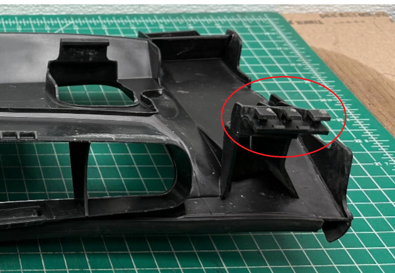

I'm having issues with my front passenger hood latch unlatching, and it's because the wire doesn't have enough tension. It's supposed to be connected in 2 places, by zip tie, to some plastic item. (Technically 3, in the middle of the air intake cover if I remember correctly.)
Does anyone know where those 2 plastic parts are that they are zip tied to?

Mines had some front end work so may not be original but included photos of what it looks like. Works perfect no issues. Just 3 zip ties, one on the right, the middle, and the left side.
Left side at the latch.
Middle.
Right side (drivers side).

Perfect, I guess that front plate is where those 2 end brackets broke off for me. Purchased a replacement. Thanks for your help!

Looks like there are tabs in the fan shroud where the cable snaps in to. Maybe my cable wasnt staying put and they added zip ties. No idea.
There is a fastener for the cable along the drivers fender area.
