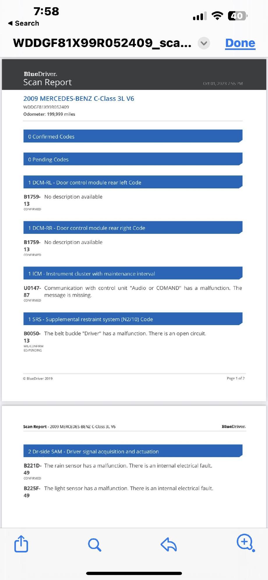

I checked out all the scanners you recommended and thank you. I went with BlueDriver, which was the least expensive option.
BlueDrive is good for scanning and clearing some codes, and it will support multiple vehicle brands, but it is not as full-featured as the others. But for now, you may not need those features.

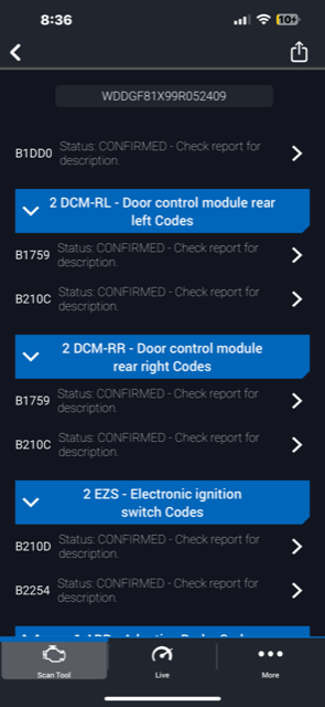

Old Sep 30, 2023 | 09:02 PM
CedricShelby's Avatar
Joined: Sep 2023
Posts: 20
C 300
Old Sep 30, 2023 | 10:12 PM
JettaRed's Avatar
Veteran: Army
iTrader: (1)
Joined: Nov 2016
Posts: 7,847
Likes: 3,498
From: Maryland
I’d focus on the last two dealing with ignition.

is that the first time scanning the vehicle? If so may try clearing the codes, then try starting it a few times to see what current codes show. First time I scanned with a good scanner it had a bunch of codes, i cleared them and most if not all were gone.

Regarding the steering wheel, it moves about two inches in either direction, regardless of whether the key is in or out. I cleared the codes, and this is the only issue that remains. See attached.
