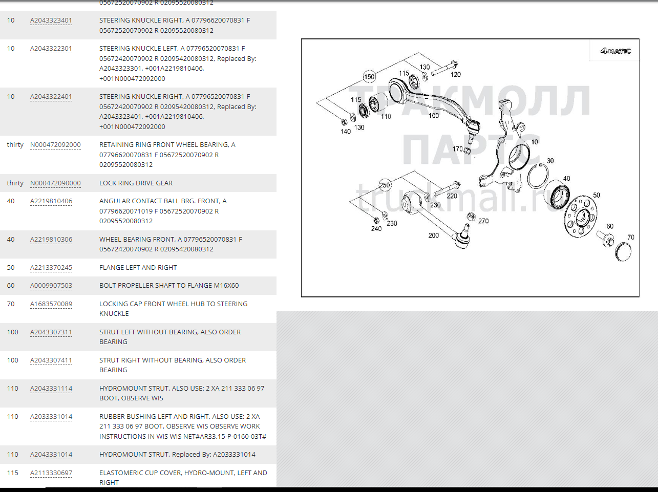

Hello all my 2011 c300 sport just started leaking some sort of fluid from the front right lower control arm. I was reading some other forums and another person had that issue but someone said the control arms have no fluid in them. I also went to a mechanic who stated these have something called hydraulic fluid in them but he sounded like he didn’t know what he was talking about. Is it possible there is fluid leaking from there?

I do think they are filled with fluid, called hydro bushings. From the photo I can see some tears in the rubber. I believe that bushing can be replaced, or replace the entire control arm.

The parts diagram refers to the bushings as hydromount struts. makes me wonder if they are fluid filled.
FCP blog talks about how control arm factory bushings are commonly filled with fluid.
https://blog.fcpeuro.com/bushings-th...ion-components

I will say that the multiple parts for item 110 (bushing) is confusing. The part starting with A203 replaced the one below it. Usually, the first three numbers indicate the model, which would be the previous generation to the W204. I wonder if Mercedes found too many of the fluid filled bushings failing and went back to rubber only.
