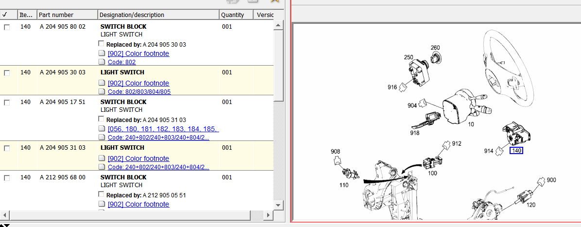

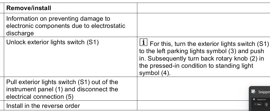

To remove...
S1 is your light switch. The rest you'll figure out...
