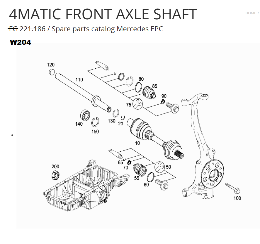

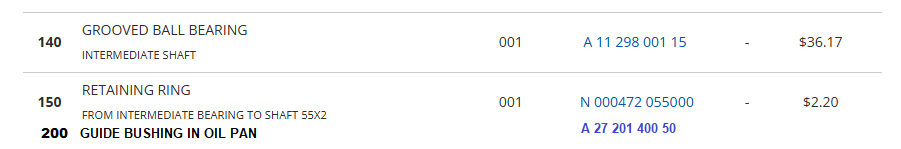

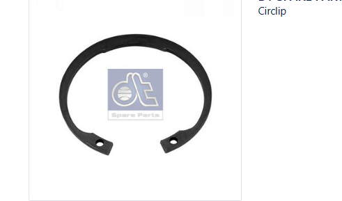

There is a retaining ring holding the bearing in place that has to be removed first. Then the shaft with the bearing should pull out.
Item 150 in the diagram below.
