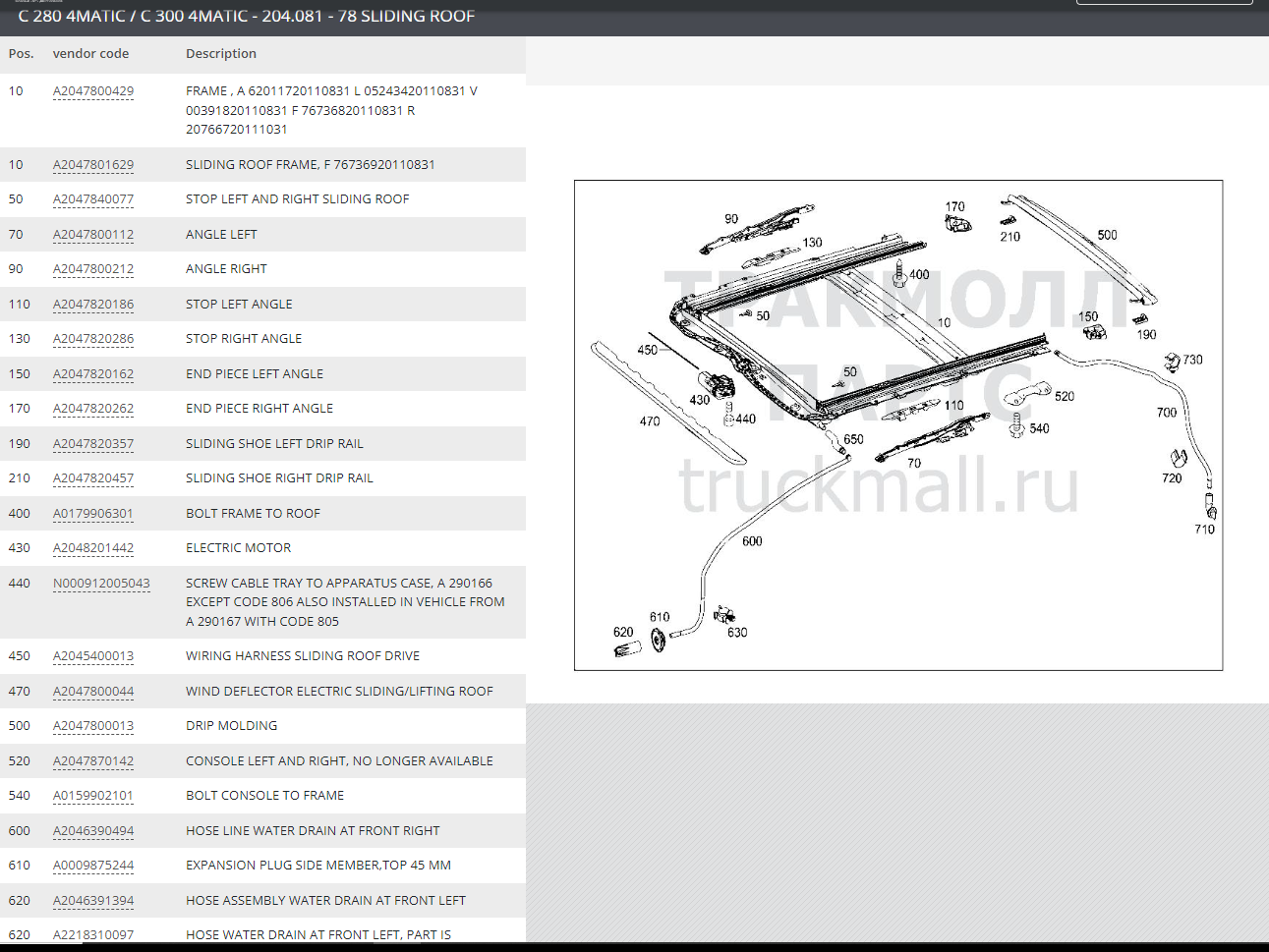

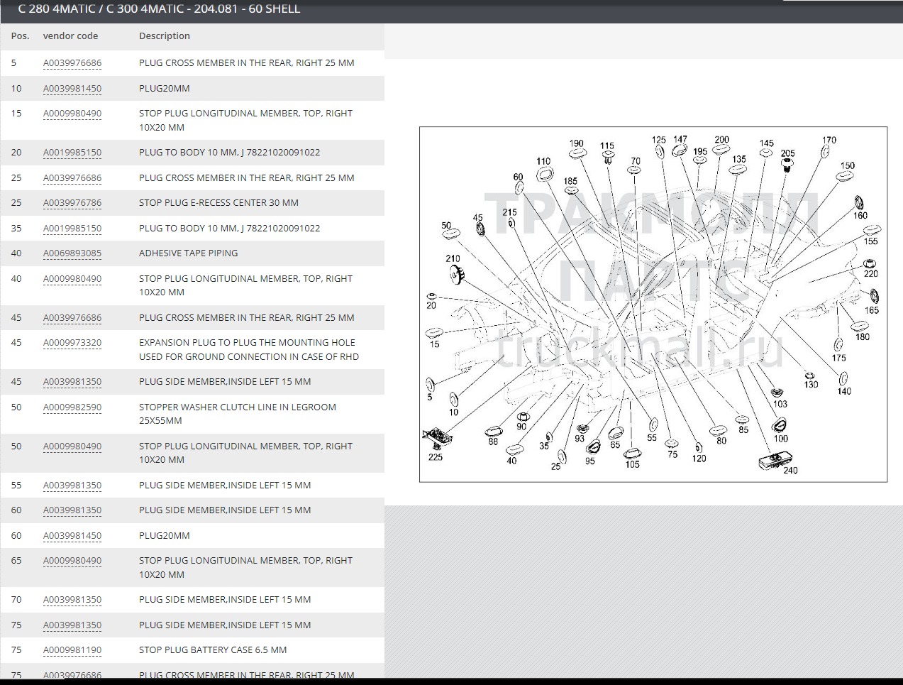

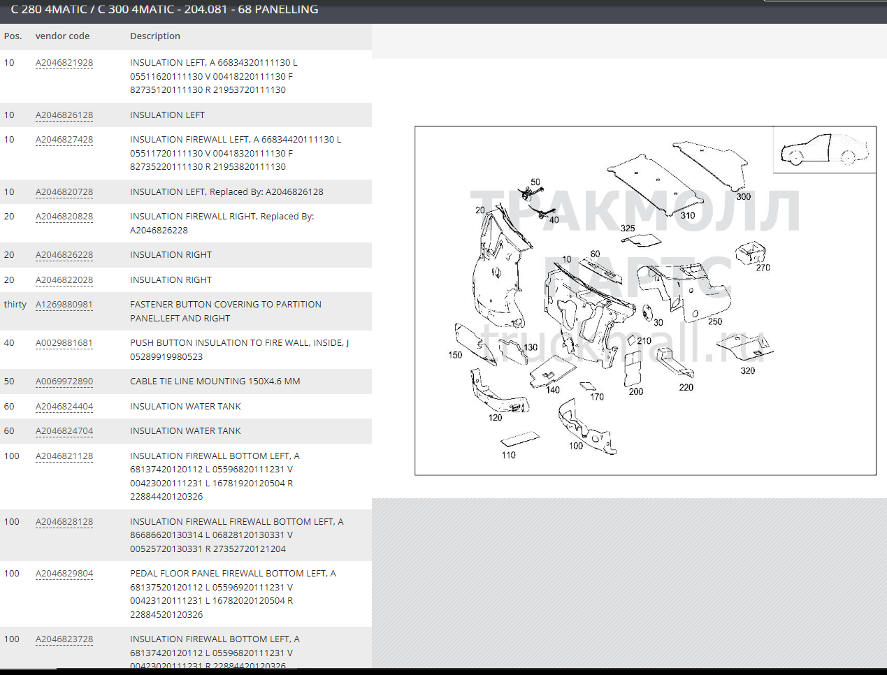

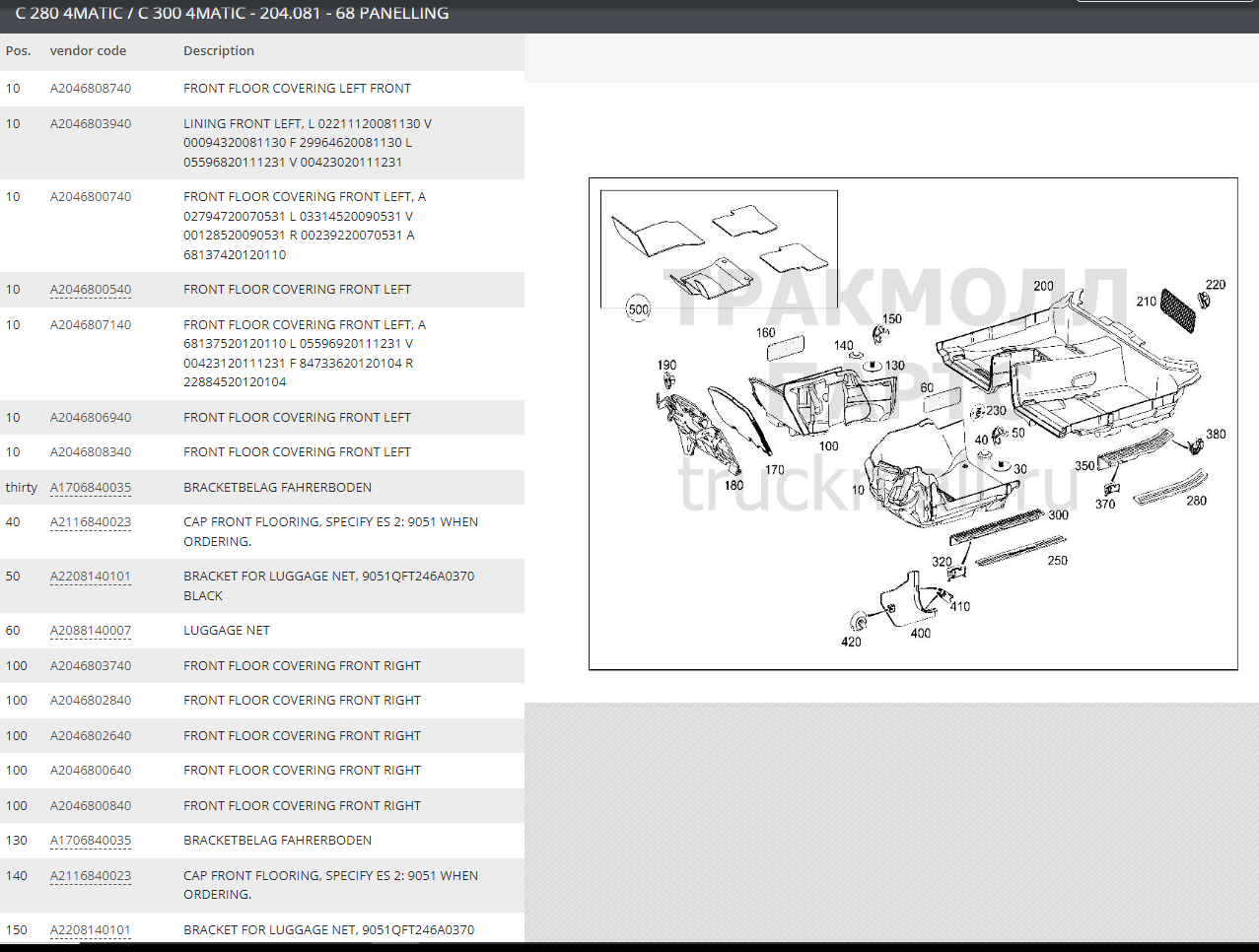

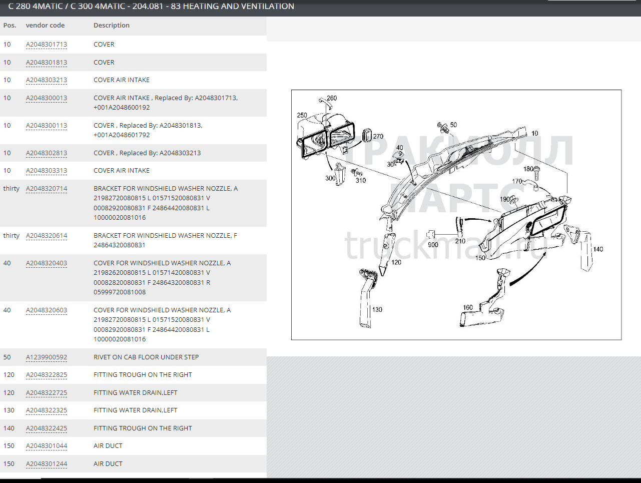

Im thinking remove the carpeting is the only way to really dry everything out, at least pull it up and towel dry everything under it. Even if left damp it can lead to rust and maybe mold issues. Wet vac to suck up as much water as possible then air dry.
Found some diagrams for the carpet, insulation, sunroof drains, and seems theres a bunch of various plugs and grommets all over the car. Diagrams are for my 2010, should be similar to other models im thinking.

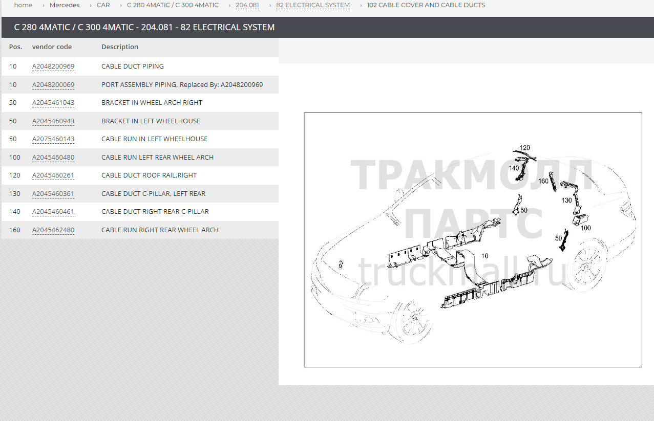

Looks like theres some cable ducts that run along the bottom also. Ive read where people have issues with water getting into wiring connectors down there.
Drains below windshield.
Thank you for the info! This is helpful. Do you think that it is safe to pull any of these plugs to drain the water or is there a specific plug that I need to pull?

I had this problem earlier this year and ended up removing the plugs in the floorboard on the driver's side where the carpet was soaked. I also used compressed air to blow out the sunroof drain channels. While I'm not entirely sure it was the sunroof, the drain line that parallels the A-pillar was clogged. I removed the plugs to keep water from pooling should there be another leak. Under the car, you have splash shields that should keep any water from entering through the holes (though I can't make any promises about critters, such as mice, that might look for a nice home this winter).
