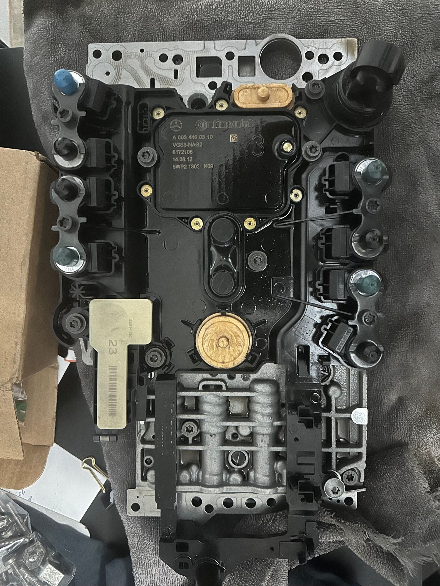

What conductor plate do I have?

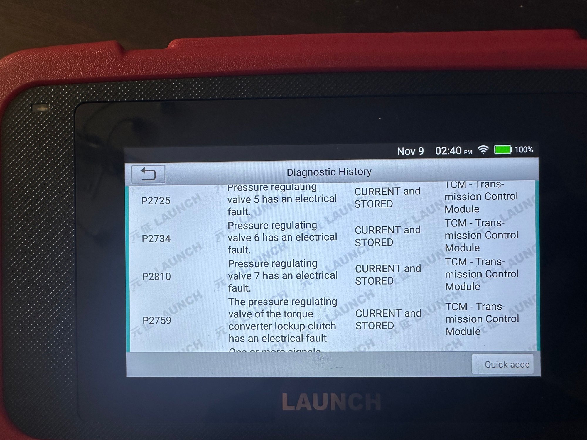

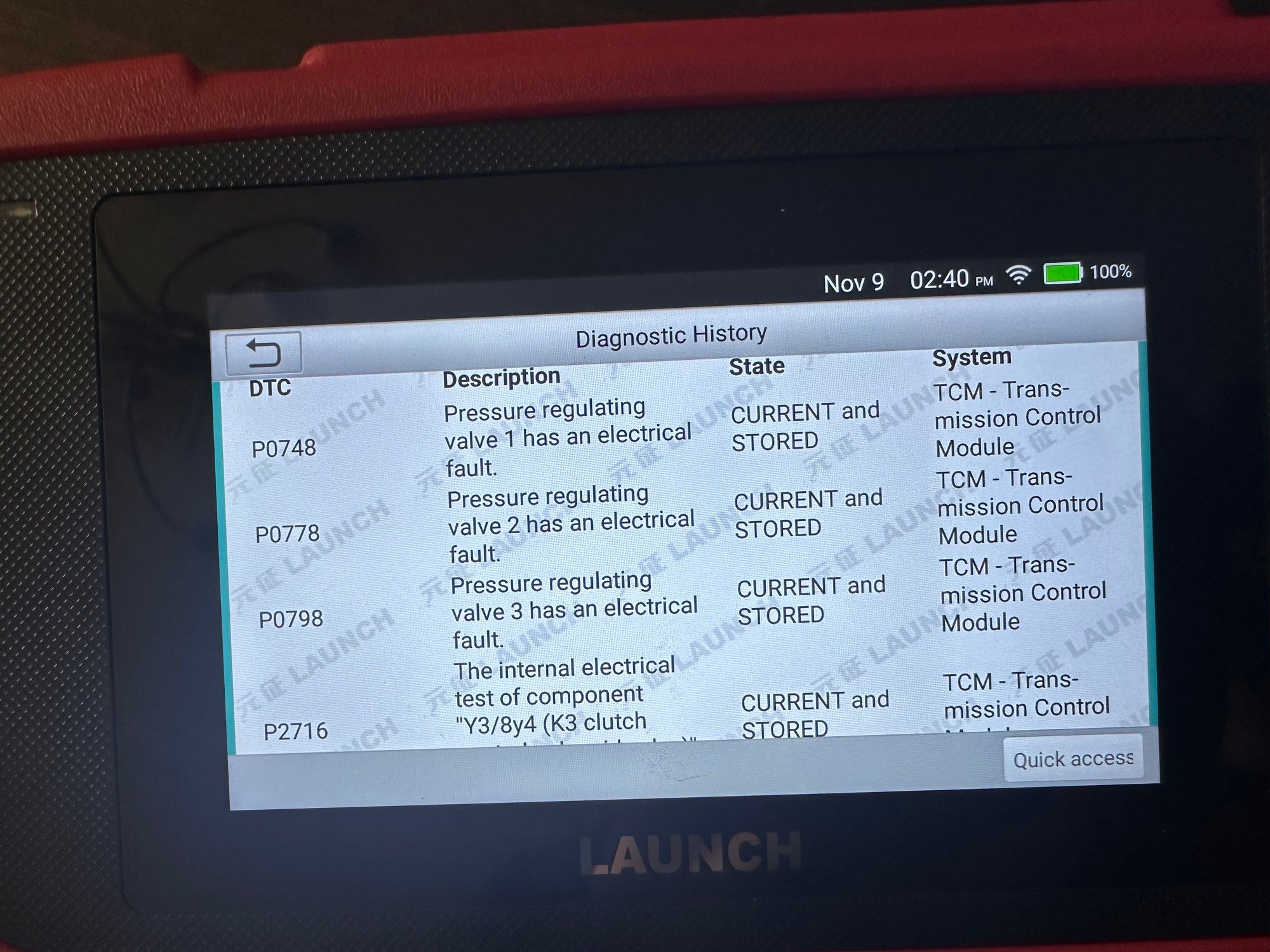

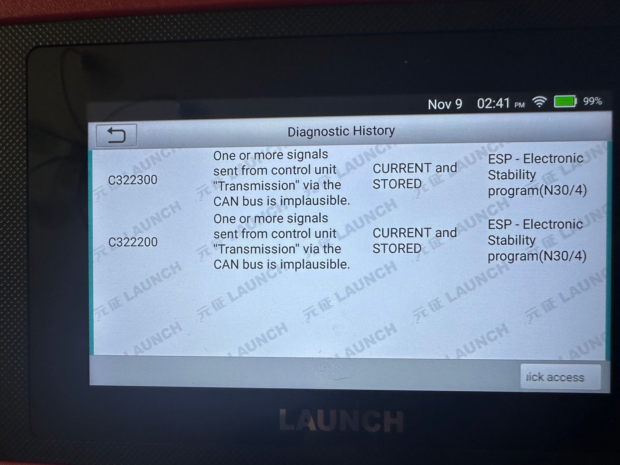

Hello y’all, kind of a dumb question but what conductor plate am I suppose to buy? On the plate itself, it says A003 448 03 10, which I thought was the type of plate I needed, but when I look up that said serial number, I’m being met with 5 pin plates in which I need a 4 pin plate. Am I missing something here? Or am I just not looking hard enough? My solenoids are not being registered by the esp module nor the tcm and no company seems to willing to try and fix said problems so I’m trying to find a new conductor plate that will work for my unit.

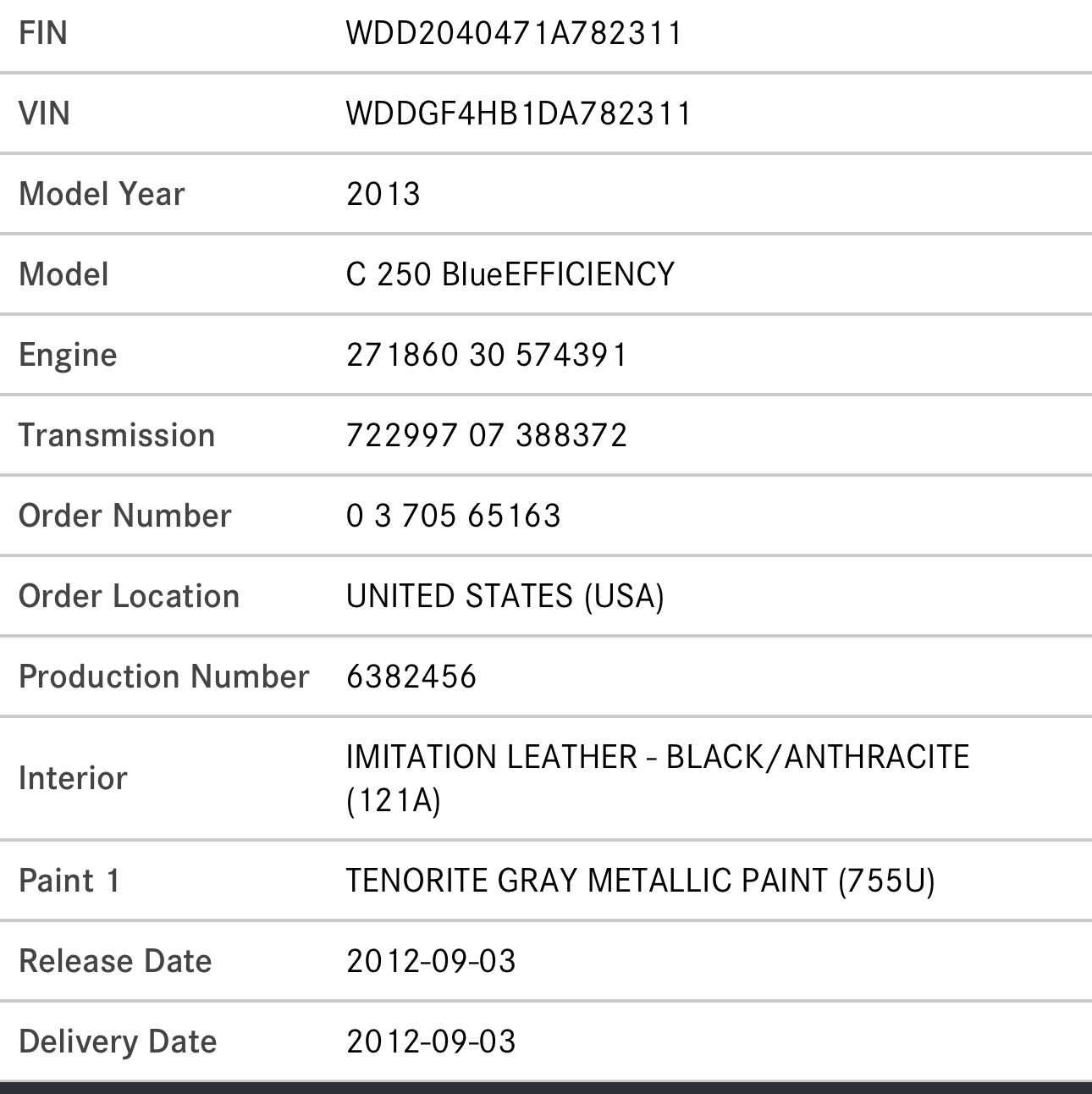

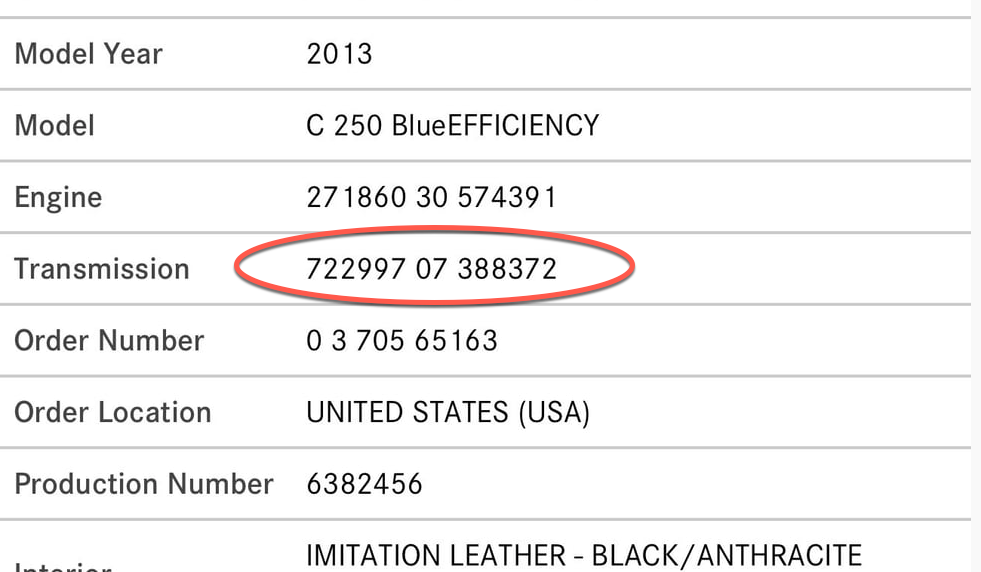

How many speeds do you have? That part number is for a 722.9 7G-tronic tranny. If you plug your VIN into www.lastvin.com, it will tell you exactly what you have.

That tells you which transmission you have.

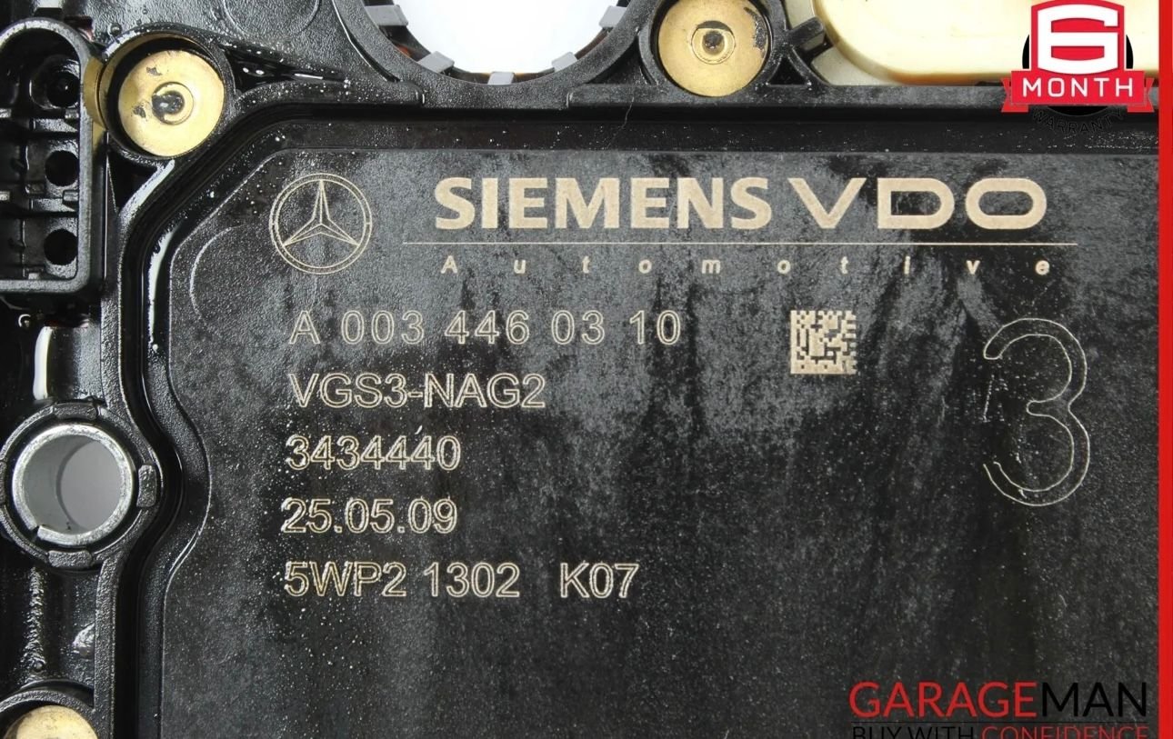

Is that an 8 or a 6?
A003 446 03 10?
Old Nov 10, 2023 | 02:51 PM
That1person's Avatar
Joined: Oct 2023
Posts: 31
From: Mesa Arizona
2013 mercedes c250 luxury
A003 446 03 10?
It’s a 6

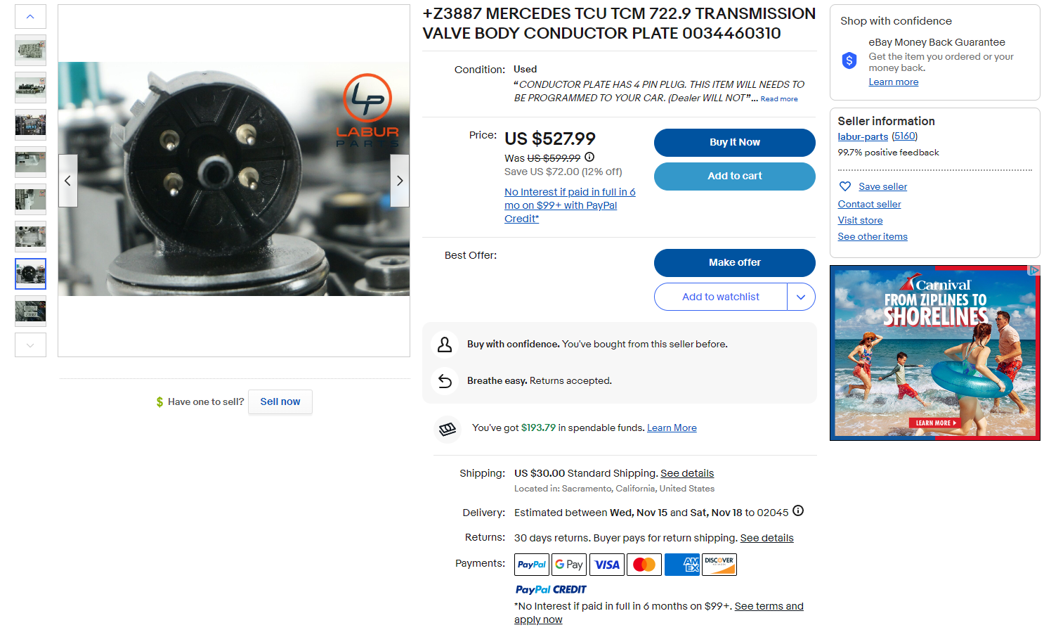

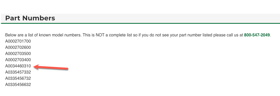

found this conductor plate online would this be a match to my conductor plate?
Old Nov 10, 2023 | 03:01 PM
TimC300's Avatar
Joined: Aug 2023
Posts: 3,687
Likes: 1,107
From: MA Coast
I'm finding 4 pins with that number. I know nothing about conductor plates, or what pins are. Are they the pins at the round connector?
