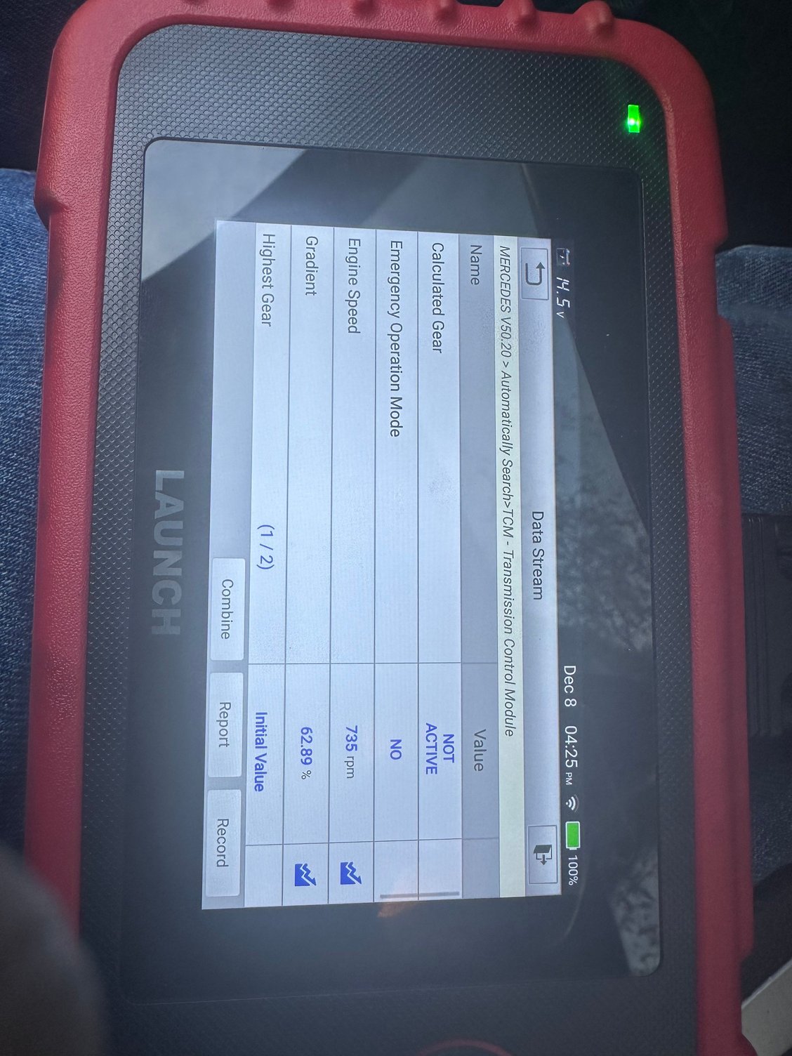

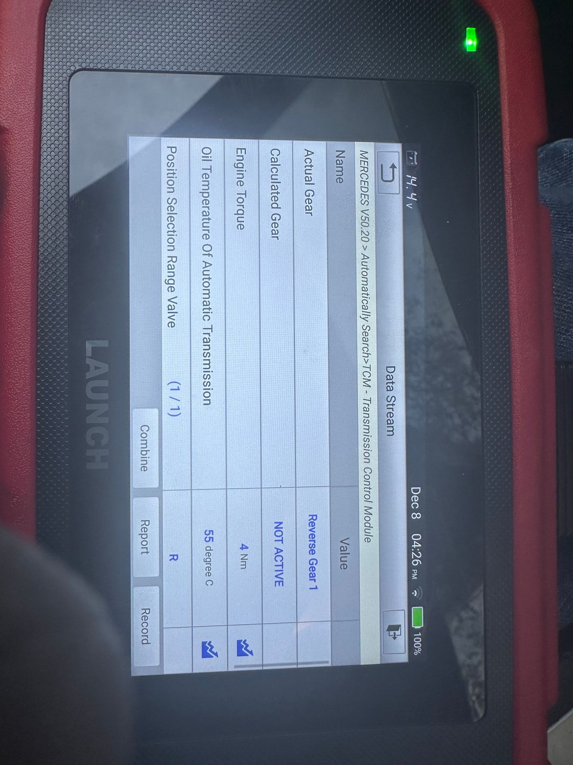

Hello y’all, just replaced my conductor plate in my 13 c250 and everything seems to be working fine, but the car will not go into reverse. When put in Reverse, the car acts as it’s in neutral and revvs and just rolls forwards. I had the conductor plate programmed to my car so I thought everything would work as it should.
Anyone got any tips?

I’ll remember that! And it was a guy on eBay all the way in NY (I’m in AZ) who did the programming.. I had to send my old plate with the new to which he Aparently connected the vin and the adaptions from the old plate.. I reached out to him and he said that the car needed a learning adaptation with the range selector.. fast forward I bought the function on my launch obd reader and did the steps and yet it still will not shift. Although.. during the shift relearn drive does become available but the second you take it out of Drive and put it back it becomes inoperable.. cars been a real money pit for me recently so hopefully this can be fixed soon..

just yesterday I had my car at the my local Mercedes dealership (not really local it was an hour away lol) for a battery problem (was under warranty) when it was there, I had them diagnose the car for the car not shifting and they said 1, found the used conductor plate which they said was not the smart way of doing it, and second, that the cars lack of shifting was due to incompatibility with the conductor plate.. 400 diagnostic charge later and they quoted me a new conductor plate and instillation at around 2300 and some change.. let me put it in perspective, the mileage the car has (163,000 miles) and with that said, it would be stupid of me to even consider having the dealer fix it.. at this point my goal is to get the car driving just to sell it because as is not movable I’ll get less then what I’ve paid for the new parts in it as it sits.. so with that said, I need to break out the ol piggy bank and spend a few nickels lol.. I thank yall for the help and I’ll update when there’s one to give!
