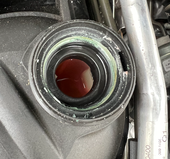

Checked inside the tank, and while I don't quite have a black tab sticking out like #3 from the manual page (different model), there is still a small black section along the lower rim of the opening that I guess is meant to indicate full level.
I added more coolant, although not quite all the way up to the black to be cautious. The low coolant indicator went off without me ever having started the engine, so Low Coolant level warning was probably correct all along. Keeping my eye on it now that it doesn't fall below the threshold again anytime soon!
