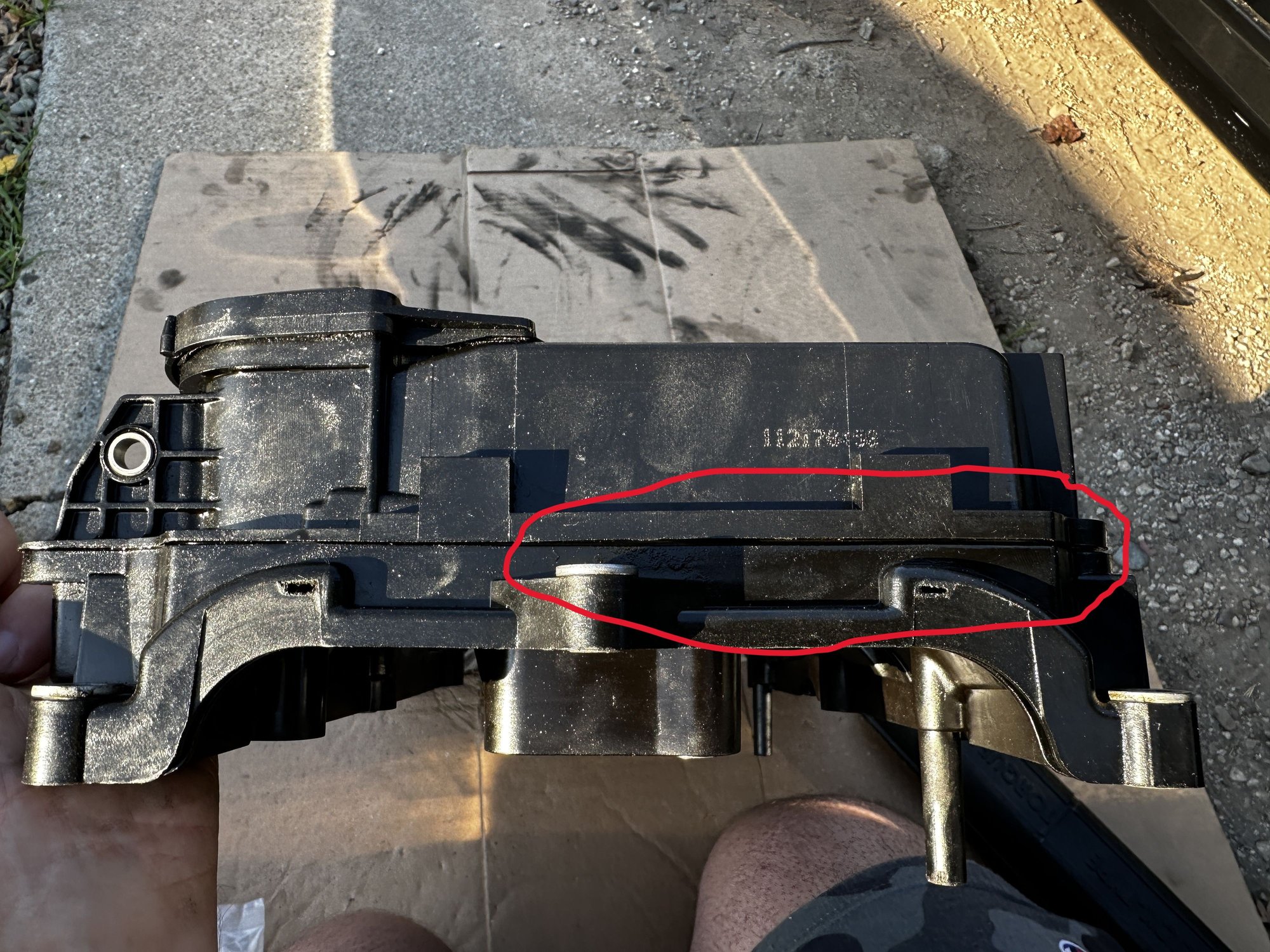

My 2012 C250 valve cover has been leaking even after changing the gasket. I couldn't find any cracks but I noticed a small gap at the rear right of the valve cover and was wondering if i could somehow tap that back in with a rubber mallet. My concern is if beating on it would somehow mess up the gasket and make it worse. I checked used VCs on ebay and almost all of them have some sort of separation at the rear of the VC so if I were to replace it would probably have to be original new. What do you guys think??

Appreciate the feedback but I am already aware of the PCV routing in the VC. My question is if it would be a wise idea to try to tap the upper VC back into place. My logic is it was probably pressed in during manufacturing and has slowly backed out over the years. Also as far as I understand any clogging up of the PCV system would cause the engine to run poorly and throw a CEL which I dont have. As far as the aluminum VC it is aftermarket and I wouldn't completely trust it to have all the internal plumbing for the PCV done correctly if at all since it is completely out of sight unless you've verified with the manufacturer. I will continue to monitor the situation and report back with any future developments.
yeah I’m definitely taking a gamble on the aluminum VC. But I will let you know how it works out. It looks legit and appears to have all the piping for the built in PCV. Here’s the link to check it out - https://www.ebay.com/itm/17611377652...mis&media=COPY
As for your valve cover, i agree with you. It was definitely pressed or glued on from the factory. I would not try to press it back in. Being plastic and a Mercedes, it’s likely a one and done deal. Just get a new valve cover and gaskets call it a day.

I think i would go crazy if I had to take it off again as this was the fourth attempt to get this done right. I've had pretty much everything that could go wrong happen to me from new defected gaskets to broken bolts and stripped holes. I think the mallet method could work if I do it after the engine has been running for a while where the VC would be as warm and malleable as possible and then gently try to tap it back into place. Also I recently changed my oil and used the LM Molygen oil with the UV dye so I will be able to better trace the leak with a UV light as my theory of that gap causing the leak is still an assumption.

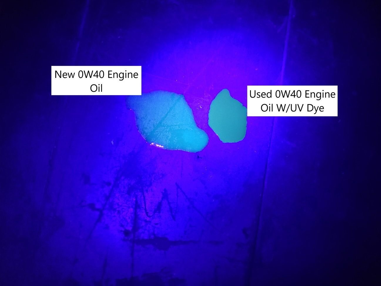

I put a UV dye in my oil over the summer and think it was a waste. I took a UV flashlight to the engine and all the old oil leaks seemed to be glowing a green color. Then I used the flashlight to compare fresh oil with no dye and old oil with the dye and they basically looked the same. it looks like there is already something in the oil that makes it glow greenish. Have you looked in the engine bay with the UV flashlight before using the dye? I should have.

Here's the thread I made on it. I talked about a few things in it, UV dye, replacing breather covers, replacing oil filter housing gasket. Post# 16 has photos I took looking in the engine bay with a UV flashlight, shows old oil leaks look glowing. So I didn't know what was new or old leaks.
https://mbworld.org/forums/c-class-w...ks-yes-no.html
Heres an example of an old leak.
