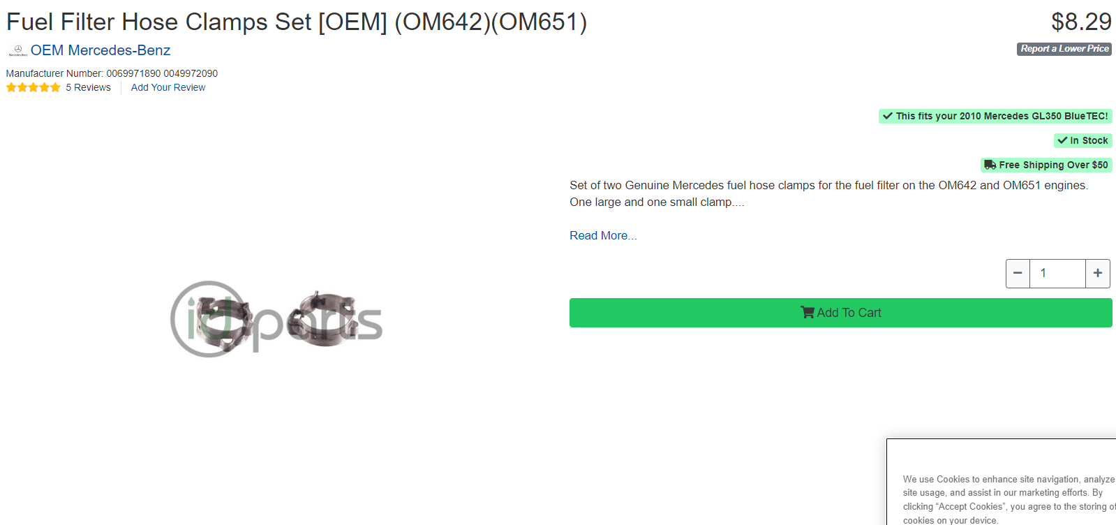

I dont have that engine but I would think its hose # 20- Feed line from filter to high pressure pump. See if thats what it looks like in your engine.
The clamps would be # 0049972090 14.5-15.5mm, # 0069971890 13-14.5mm.
