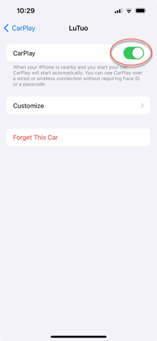

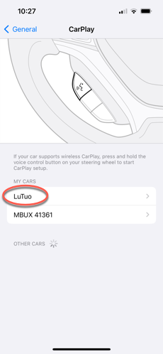

Also, make sure your iPhone is configured to work with your Road Top unit. In my car, LuTuo is the Road Top unit. Have you tried connecting using the USB cable (Bluetooth is not the most reliable)? Does your map app work? What app are you trying to hear?
