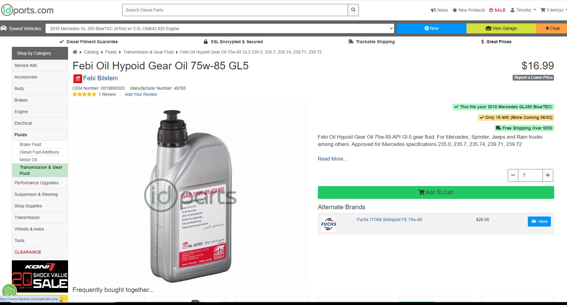

I'm not sure which differential fluid to use

I have a 2010 4matic and used Febi 75w-85 GL-5 gear oil. Its Mercedes approved for my diff, even has it on the back label.
I ended up using 2 bottles, a little less than two actually. The rear took 1.1l and the front was around 0.7l.
