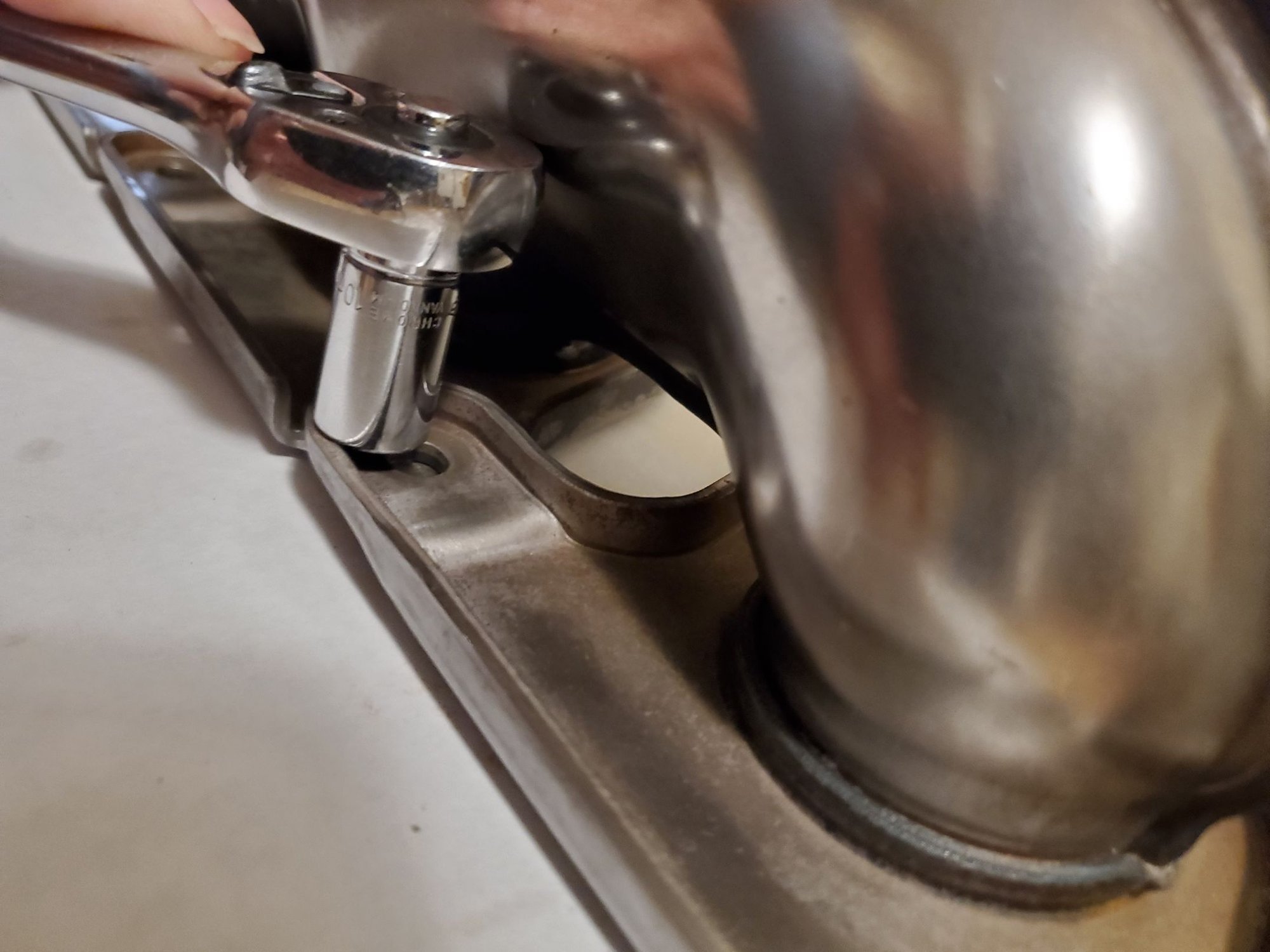

Right now i'm searching for a good 10mm wrench. I was playing around with the new manifold and realized I cannot fit my 1/4" ratchet on the two bottom middle nuts, the ratchet hits the manifold. And thats with a shallow socket. It fits when I put my swivel extension on but it seems like a sharp angle I prefer not doing. I did order a 10mm six point swivel socket that may work better. But I tried my small 12 point 10mm wrench it it looks like thats a better way, but I want to get a 6 point wrench if i can.
This is where the ratchet ends up if i have the socket straight up and down. Wont fit over where the nut is.
If I tilt the ratchet to fit then the socket isnt on flush.
Wrench will fit fine.
Swivel adapter works, but I dont like the angle. Plus I think the engine mount will be in the way at this specific nut for this to even work.

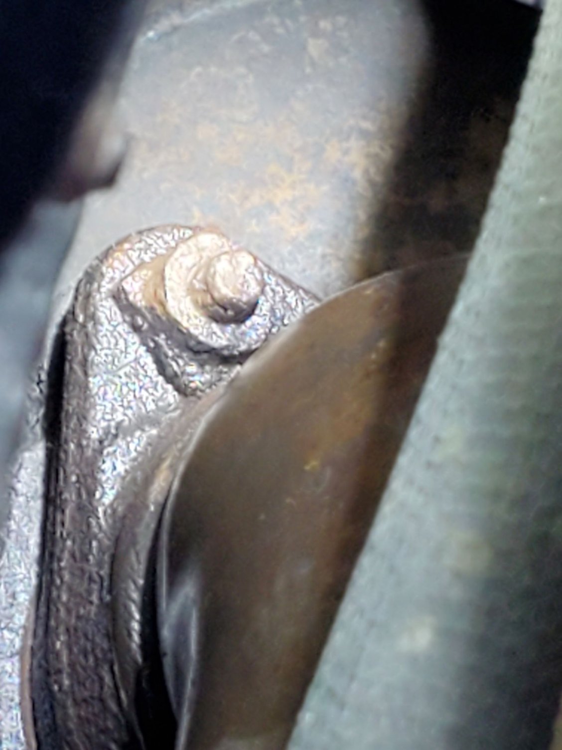

Heres the top of the header bolt, the bolt on the inside that I cant even see without the borescope. Does a good job of being able to hit it with penetrating fluid. The picture on the borescope screen is much better than this photo shows. I took the photo using my phone.

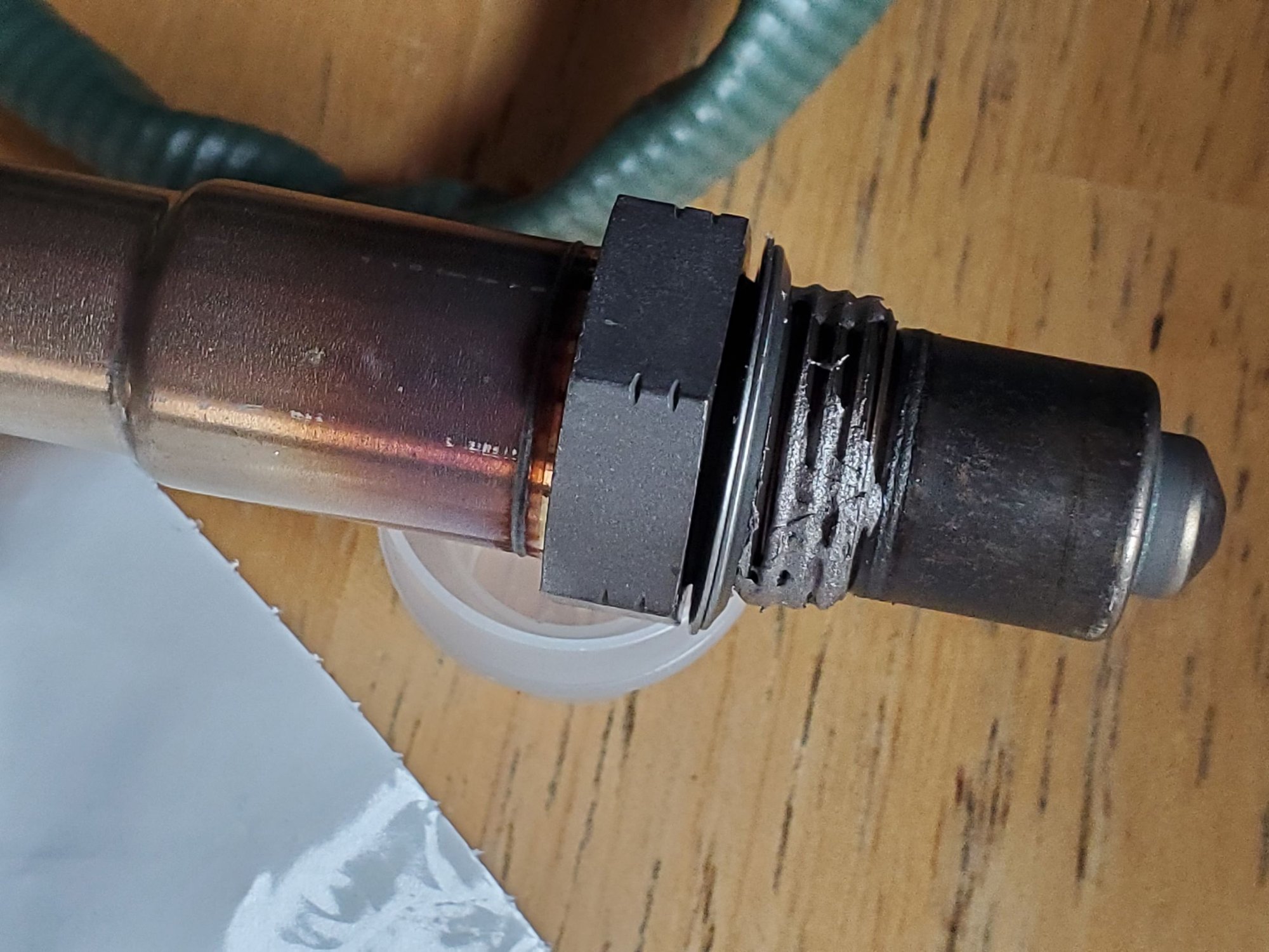

Wonder what size the O2 sensor is? I have to remove that section of exhaust pipe and disconnect the O2 sensor. I found I have a set of O2 sockets, They all say 22mm. Are they just different shapes depending on how its installed in there? Never removed one before.

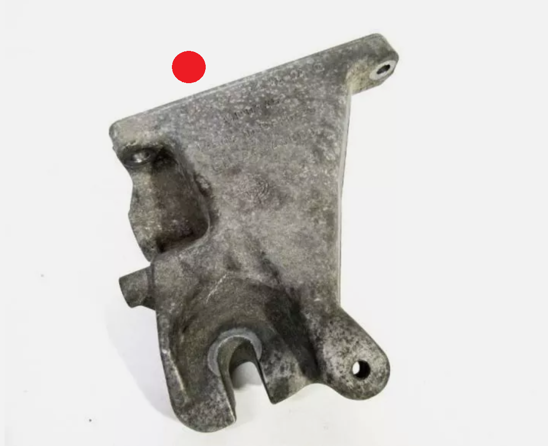

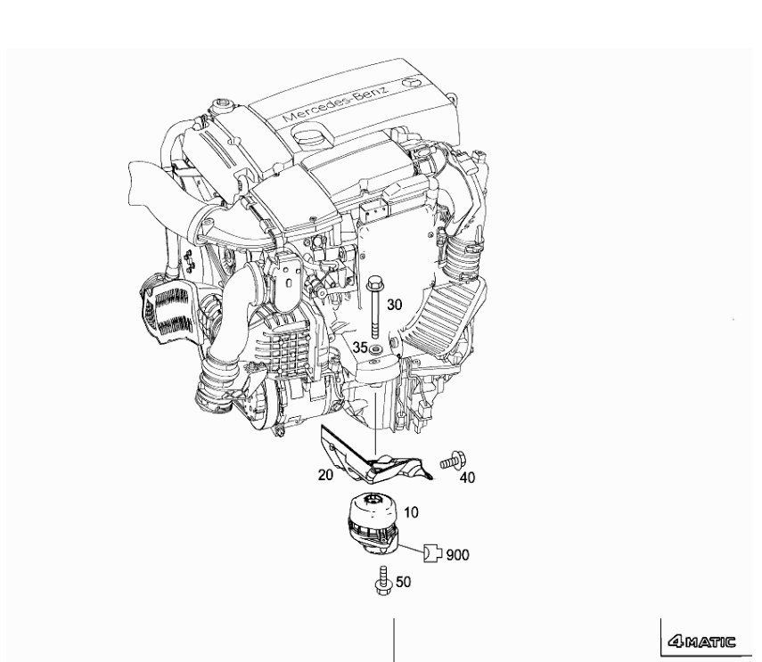

Still thinking about the nut at the engine mount. I looked around for what the engine mount looks like and seems there is a notch in it on the left, probably have enough room to fit an offset wrench and get it off that way. I'd love to hear how anyone else removed it. I think that nut is where I put the red dot in the photo of the mount below.

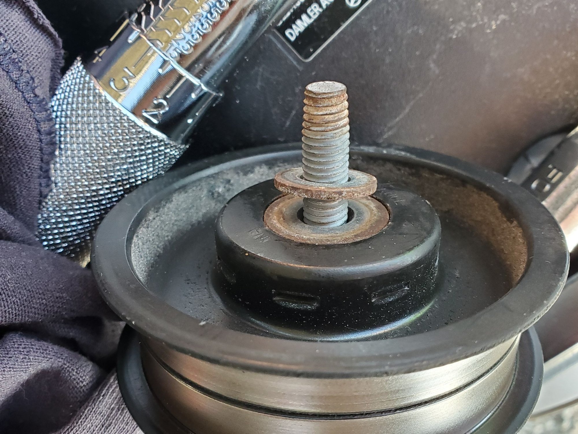

I replaced the lower smooth pulley and oddly enough it sounds the same thru my stethoscope. The ribbed pulley is very quiet, but the smooth pulley is just loud. The old pulley seems perfectly fine, spins smooth and im thinking it is still good to go. Oh well, now I wont have to worry about it hopefully ever again plus it was on sale at FCP. Its the same pulley that was in the car. The box doesnt have the Mercedes part# on it anywhere so I scanned the QR code and it showed as an original product. I was going to get the pulley off eBay but was paranoid it may not be a real INA pulley.
I've had that pulley off a few times before and I still forgot about the small washer on the back side and almost didnt even see it. Took some photos even though its a pretty simple job. I still have the small pin that came with the belt tensioner so just used that to hold it open, tension off the belt. 17mm socket and small extension on a breaker bar to move the tensioner. E14 socket to loosen the pulley bolt then remove it by hand while holding the belt so it doesnt move. Dont have to remove the belt at all. Install new pulley and remember to install the washer, torque the bolt to 25nm/18.5 ft lbs.

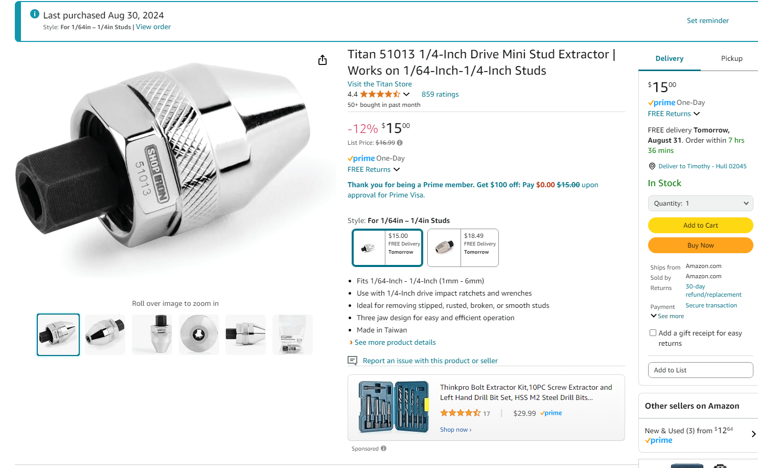

Received the 1/4" drive stud extractor and it wont work, in order to fit the 6mm stud you have to back the jaws in so they are way inside the tool. So basically if the stud breaks and there is 1/4" sticking out the tool wont be able to grab on to it. Its a nice tool and seems to work fine, just not for what I want it for. The larger 3/8" drive should be here tomorrow.
I drilled out the 10mm swivel socket so now the stud can pass thru it. Worked my way up to a 1/4 drill bit and fits fine now.

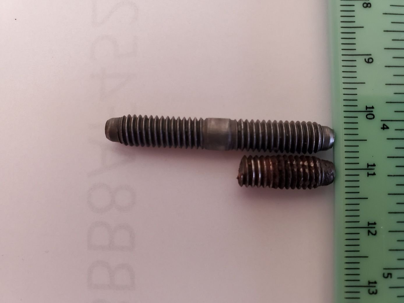

Well I did it now, snapped a stud. I was in there with a wire brush trying to clean off the rust then put a socket on the top front nut and it got it moving, this is the one closest to the exhaust leak so I went to tighten it back up a little and snap. I didnt even use that much force, though that ratchet is very long so probably used more than I thought. It did seem to be moving nicely, probably 1/4 of a turn before i stopped then tightened it back.
I started the car up and the exhaust leak isnt really any worse.
Not sure what to to do now. Bring it to Mercedes and have them fix it? Or keep going and deal with things as they come? this was my nightmare. Im looking at the break and it appears the stud snapped out past the manifold flange so there should be 1/8-1/4' left sticking out once the manifold is removed.

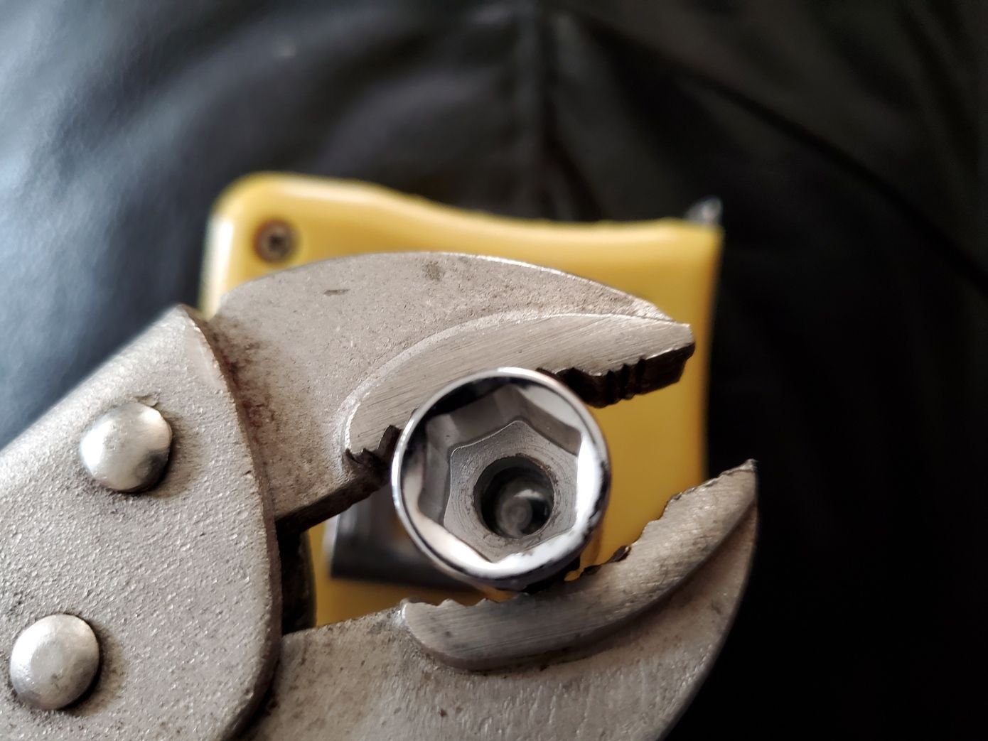

I dont think i'll give up just yet. I'm looking at the broken stud and I think I can get it out. I really think it was coming out but by tightening it back I think it fractured it, I think i turned it past the spot it was originally torqued down to. I should have just kept loosening it. I paired it to a new stud and there should be 1/4" sticking out from the head, I think my vise grips can grab it good enough. I really didnt expect all the studs to come out along with the nuts so I figured I would need a way to remove the studs which is why I ordered the stud extractors. By the way the 1/4" drive one seems too small and the 3/8" one seems too large, I dont see any way either will grab onto a broken 6mm stud with only 1/4" showing.
I have a set of old Sears vise grips to try. I wanted to see how easy the nut turns off the broken piece of stud and it turned fairly easily using vise grips and 10mm wrench.

I saw the broken stud close-up and to me it appears there should be a decent amount of it sticking out of the head to grab on to. I ordered some reverse thread nuts for 6mm bolts, wonder if i can put that on the stud and remove it that way?

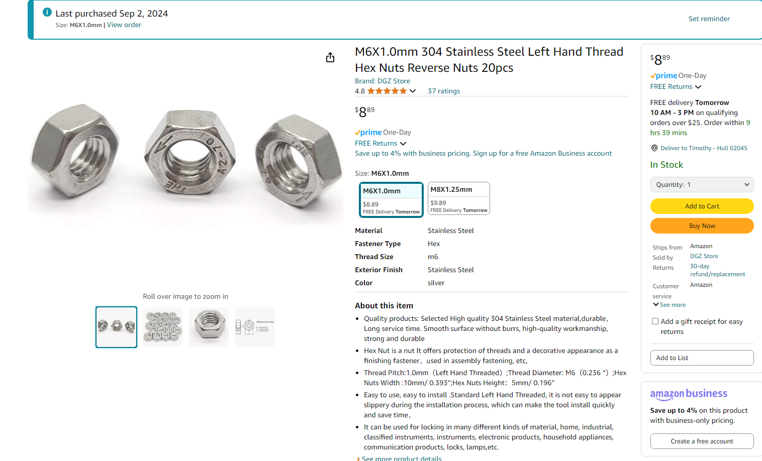

Received the set of stripped nut removers to try and get the two header bolts out. Put a flash light down there to see if the penetrating fluid i've been spraying on them is doing anything and it doesnt appear so. The exposed threads of the bolts are just covered in what looks like hard rust, I used some stiff wire brushes and it wasnt even making a dent in the rust. I just had the idea to try and chip the rust off, have to find something long and sharp to stick down there and wack with a hammer, see if that does anything. I tried spraying penetrating oil then driving around to get everything hot, also drove around then sprayed everything while it was still hot. Dont think the penetrating fluid is doing much.
Looking at the piece of broken stud/nut I dont see any of the nuts coming off from the studs, its either the studs come out with the nuts or the studs break.
Heres the new parts. The new bolts screw in easily by hand up until the very end of the nut, then it gets tight.

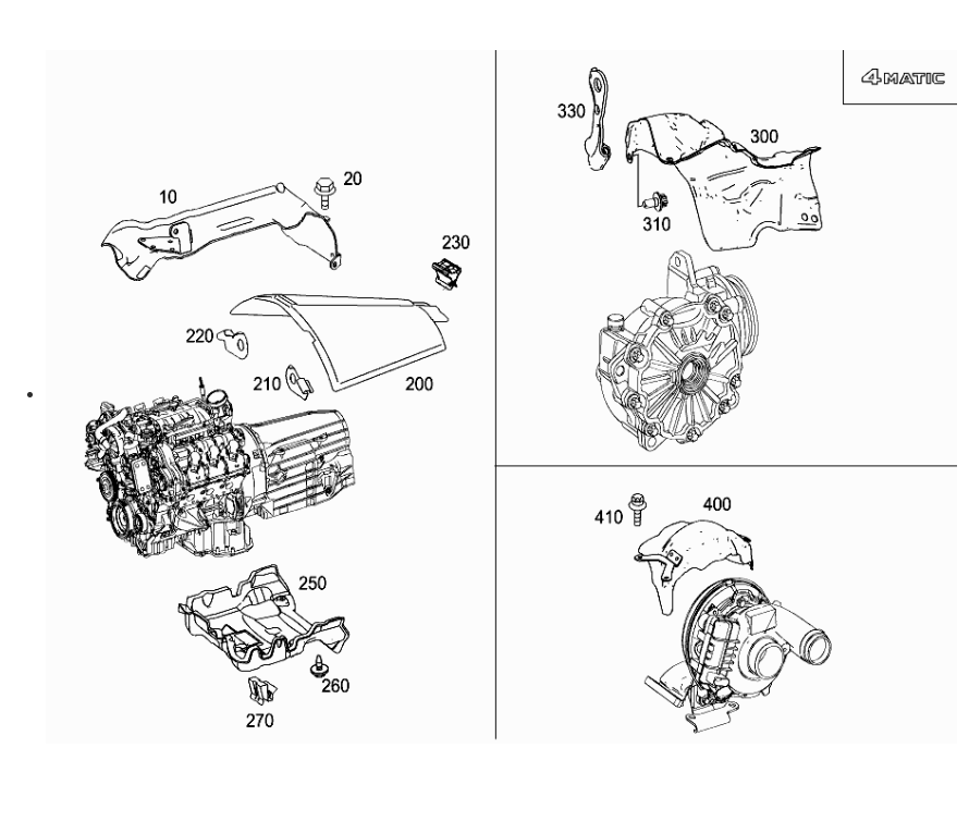

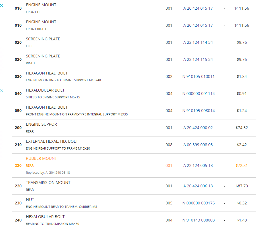

Just made an appointment for this Friday to take it to a shop listed as working on Mercedes and BMW. Its hard getting answers out of people on the phone since they all seem in a rush and just say "drop it off". I asked if pulling the engine makes sense to replace the exhaust manifold on a C300 4matic and he laughed saying "No".

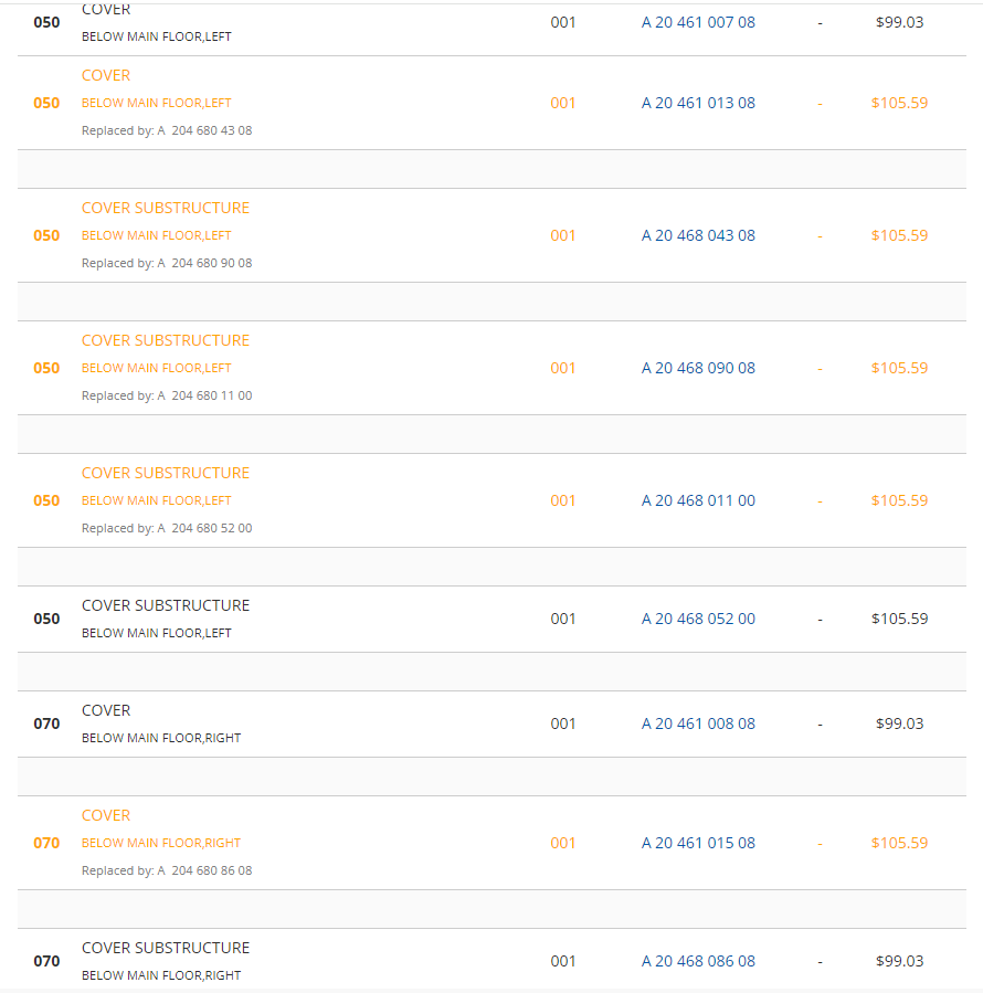

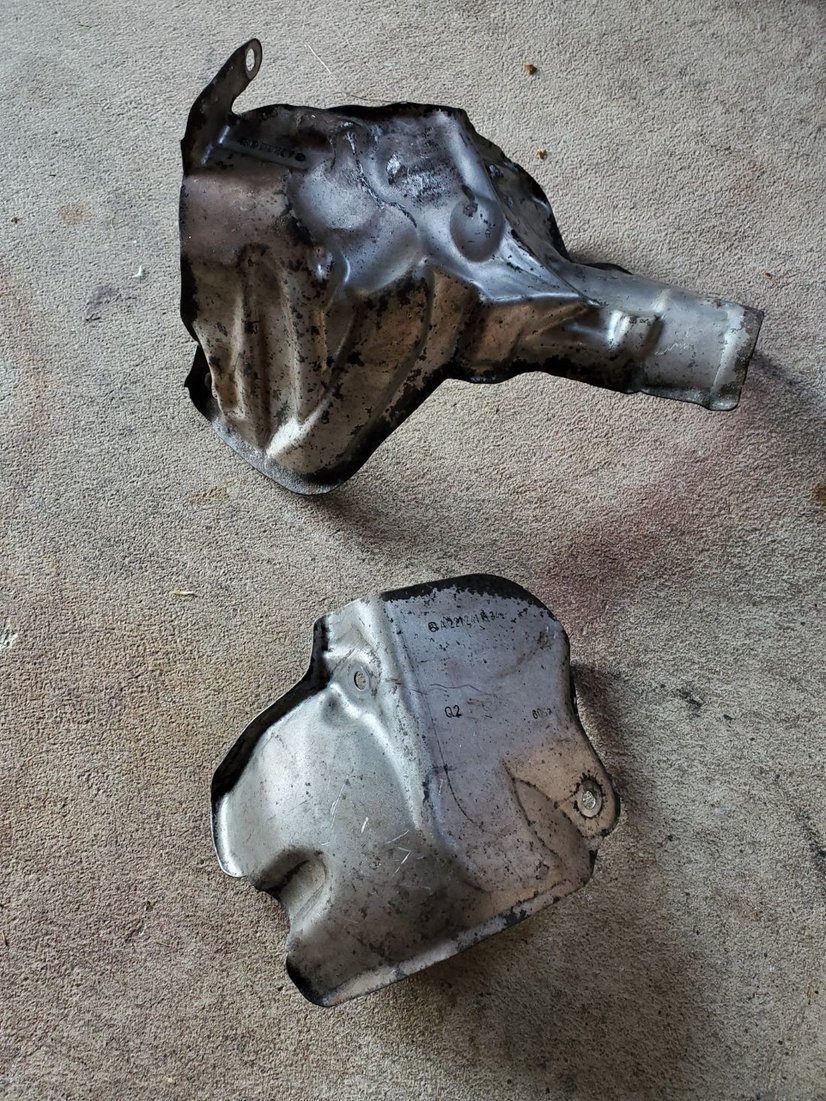

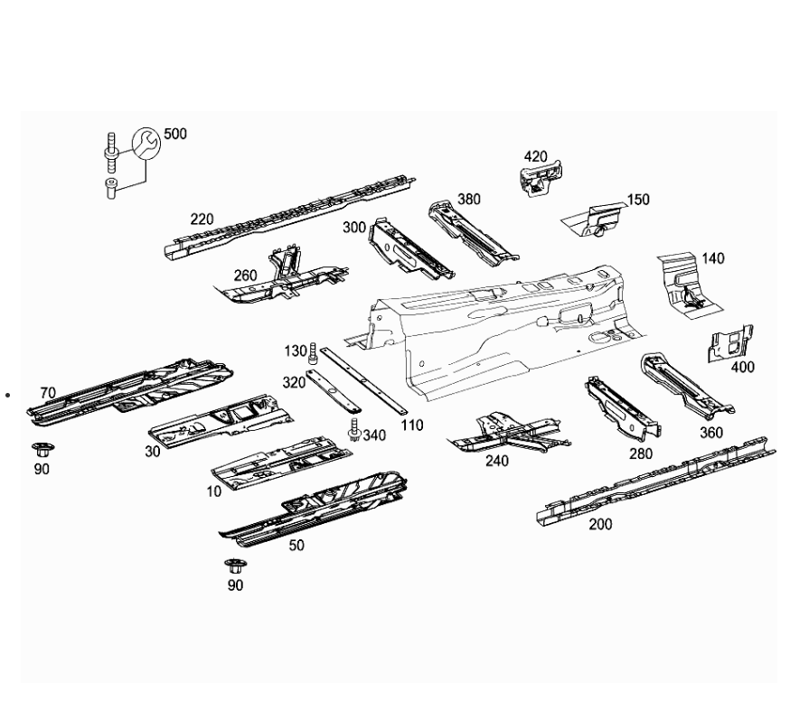

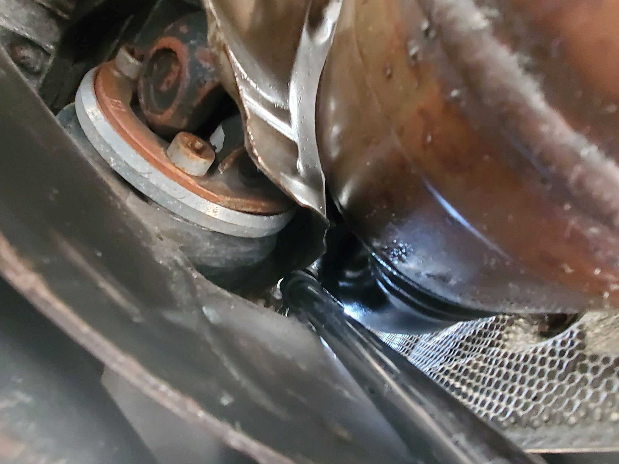

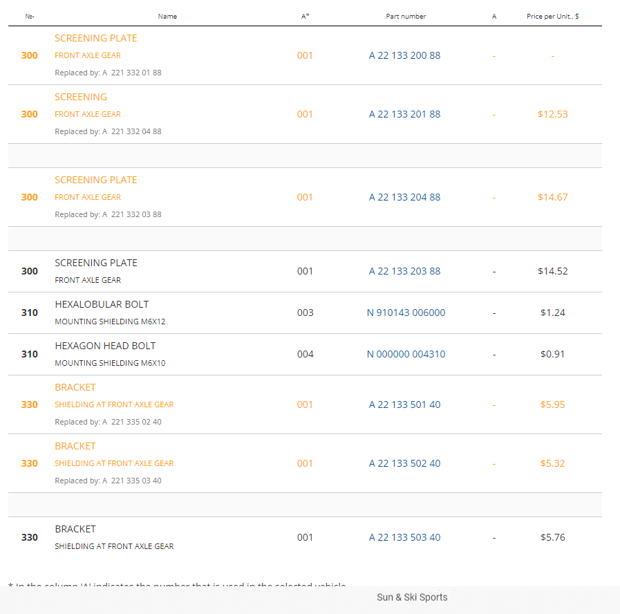

When I was under the car previously I noticed a metal brace going over across the middle section of the exhaust and remember thinking it will have to be removed to drop that section of exhaust pipe, except the bar ran underneath the two side plastic undertrays. Was just under there and saw what that shop did, they just cut out the undertray in pieces to remove the bar. I am completely outraged at the hack job that place did. I also think they put the two O2 sensors back in the wrong places, switched them.
The metal shields for the front diff and engine mount they didnt put back or include the bolts to install them:

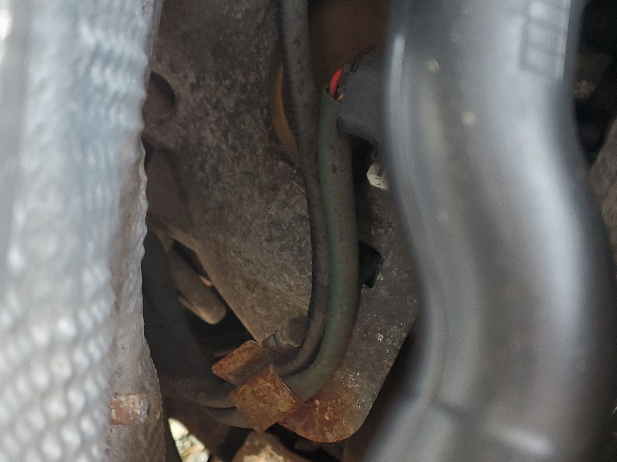

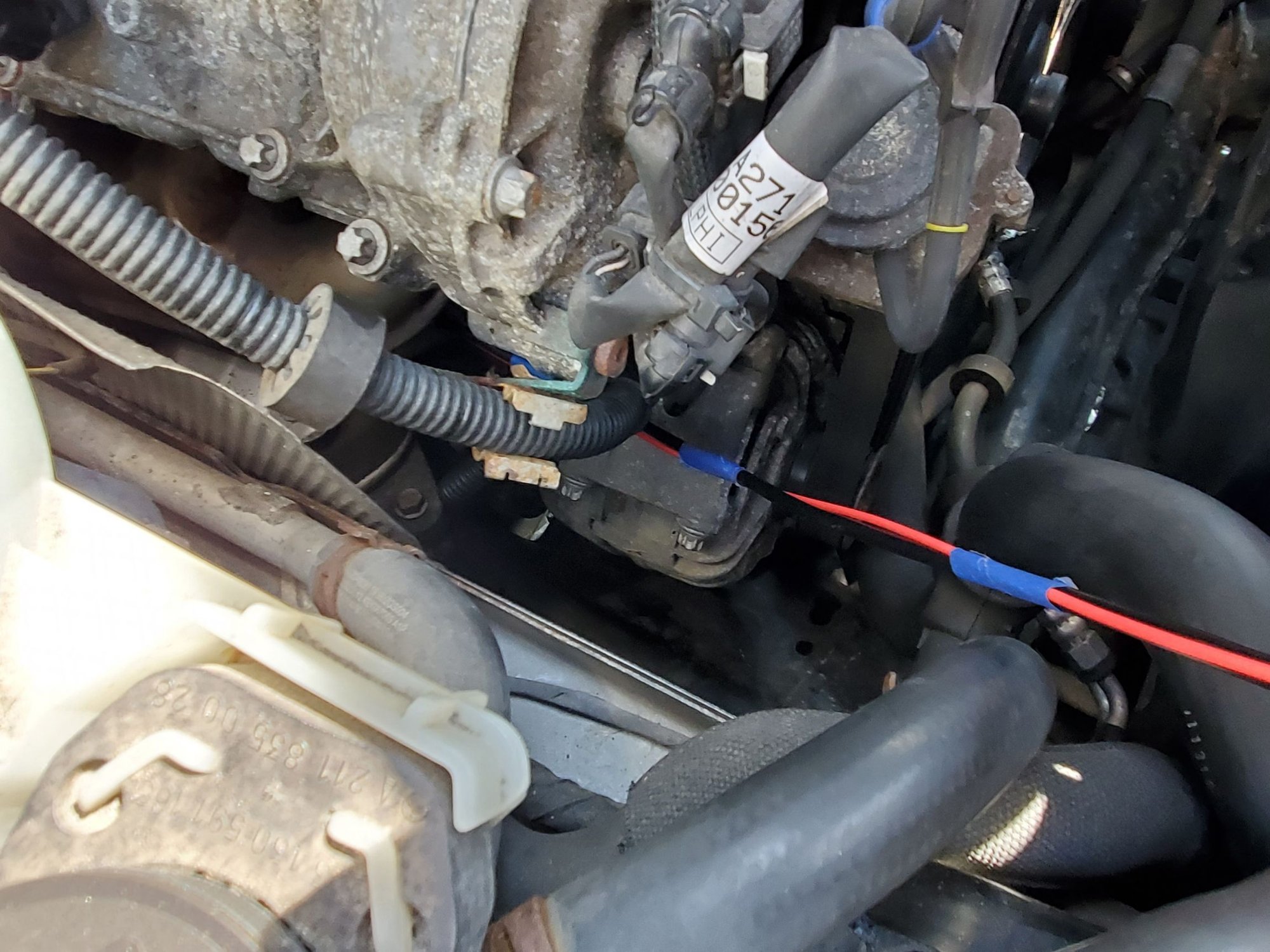

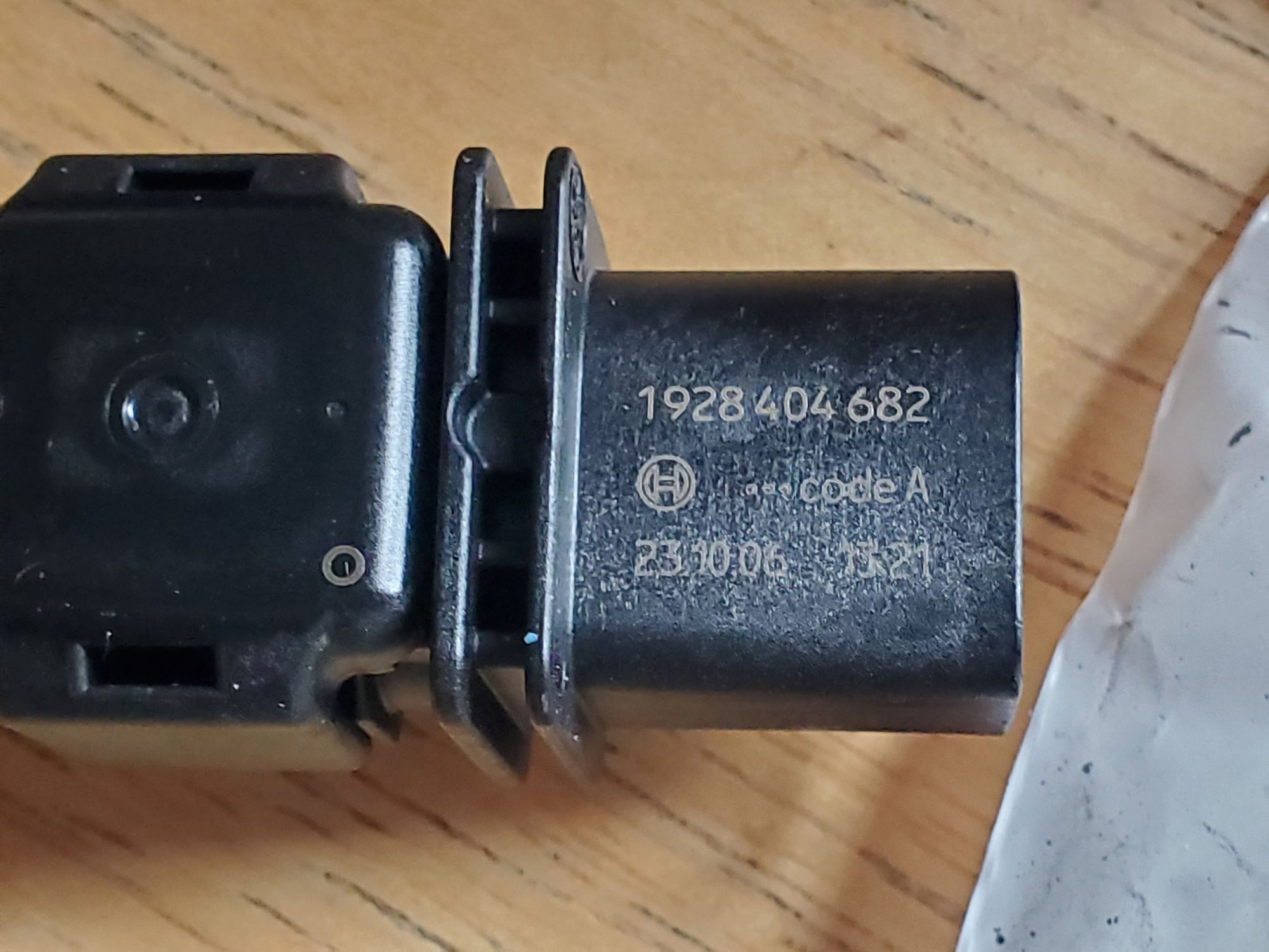

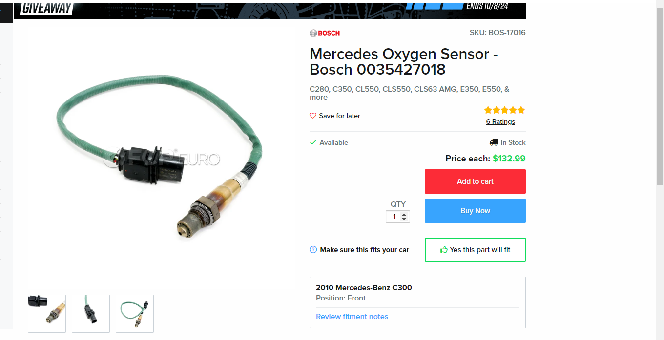

I just checked by unhooking the O2 sensors at the harness and it does appear the O2 sensors are switched, the forward is where the rear should be. The bottom O2 sensor is fairly easy to get to, but the top one doesnt seem possible. From below no way to possibly get my hand up there to even fit the socket on. I was able to fit one of my o2 sockets from up top but wondering how to get the ratchet on.
Odd that would cause only one code, I would think both O2 sensors would throw codes if they were switched? The one installed at the bottom (which should be #1 at the top) appears to be bent near the wire, wonder if its just broken now?

I went ahead and ordered a new upstream O2 sensor from FCP next day delivery so it should be here tomorrow in time for me to bring it to the repair shop. When I unhooked the sensors to see the part #'s sure enough the upstream sensor is installed at the bottom. That sensor has a 2016 date on it so it was replaced at some point in the past, wonder if they had to drop that section of exhaust to do it? I can get my o2 sensor socket on it but I cant seem to attach a ratchet though I got frustrated and gave up for the day yesterday. I'll wait to see if I need a new downstream O2 sensor since that one I can do myself since its easily reachable.

I tried to figure out how that last shop got the two header bolts out and I think they maybe cut them out somehow. The nuts that are attached to the exhaust manifold dont look like they are there anymore and instead just a regular nut and bolt is there, very odd.
Now i'm stuck trying to track down new undertrays for the sides that the shop cut away. New they are around $160 each, finding some used for around $100 each. Maybe I should try local salvage yards since its the shipping costs that make them cost so much. I double checked and sure enough some of the bolts werent even tightened all the way. Im seriously going over the entire car checking EVERYTHING. The wrote an R with an arrow on one of the braces they clearly removed, its on the passenger side so the right side but the arrow is pointing to the rear of the car?
I was searching for all the bolts to re-install the two metal shields and they appear to all be M6 bolts just all different lengths. I ordered a bunch of M6x12 bolts (910143006000) since FCP had them available. If the bolt ends up being too long I figure just add a washer and call it a day. Or even get bolts from the hardware store, I usually only like using Mercedes hardware but for these shields I dont think it really matters as long as they are back on. In the parts diagram for the engine mounts they show a picture of a different engine but the part #'s seem to be correct for what I have.

Received the new upstream O2 sensor and it appears i was reading the date wrong and the one in the car is most likely the original manufactured in 09. The first set of numbers is the year, it appears. Noticed there appears to be anti-seize already installed on the threads, I never held a new o2 sensor before.

Good thing I went ahead and ordered a new exhaust pipe seal ring, looks like the one in there is crushed and falling apart. They are probably one time use anyways, they look like they are made out of metal mesh and must form a seal when the clamp is tightened. had to order a new clamp for the left side since they just put a regular U-type clamp in. Im pretty sure that clamp was all rusted so not the shops fault.
Trying one more time to remove the O2 sensor, I dont feel comfortable driving around knowing they are switched, im paranoid it may mess up the cat some how? Such a project just getting the car up so i can even fit under, and its just barely.
I took alot of photos of my car when working on it before, now after this mess im taking even more. Would be nice to have proof the plastic undertrays werent cut away prior to that shop getting ahold of it but dont think I have any photos specifically showing it. Should have taken a photo of the mileage too, soon as I started the car the low fuel light came on and I know I had 1/4 tank when dropping off, now its much lower. Did someone take it home and drive it around? The cover for the radio was open when I picked the car up and I never have it open. I had some money stuffed in the arm rest I keep there for emergency which I made sure to remove prior to dropping the car off thankfully.
Tried to fit the metal shield for the engine mount on but it wont fit, must have to be fitted from below when the exhaust pipe is removed. Received some M6 bolts that will hopefully work to re-install both metal shields.
