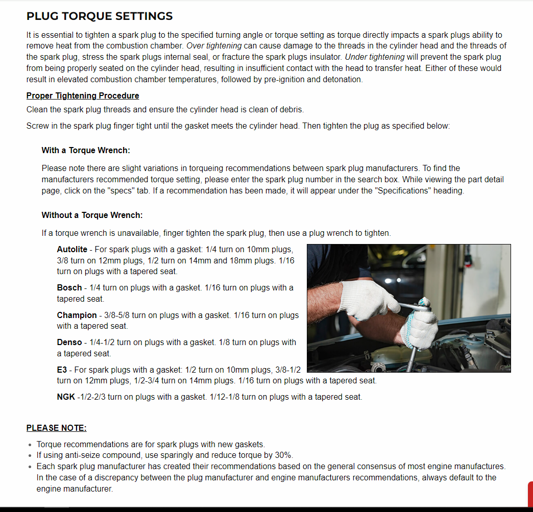

You can either remove them then re-install using a torque wrench, or remove and follow the directions below for installing without a torque wrench.
This is from the Bosch web site:
Reply 1

I would NOT follow the Bosch website instructions as they are more for non-GDI engines. Personally, I would reinstall the plugs to the correct torque setting. I know it is a pain to remove the intake plenum, etc., but I would always worry about the "perfect storm" of conditions that will cause damage.

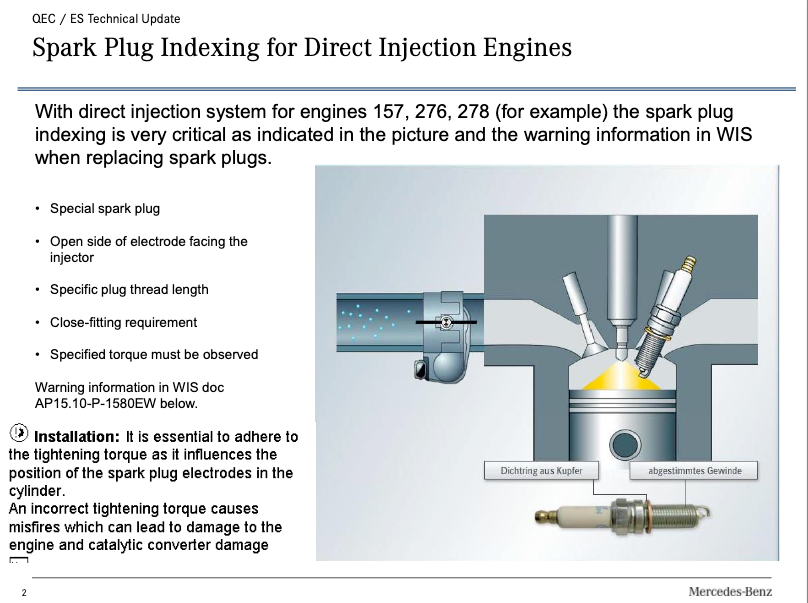

Quote: I remember no mention in the 2015 GLK350 (M276 NA) owner’s manual about damage to the engine from not indexing spark plugs.
I'm not sure ANY Operator's Manual would discuss indexing spark plugs. But, please see the attached document.

Quote: I'm not sure ANY Operator's Manual would discuss indexing spark plugs. But, please see the attached document.
That’s about what I know plus the non specific engine damage comment. Engine damage from backfires at high RPM and high load maybe. Doing it right is never wrong. Personally, I’m like the guy in the video. If they say 45 deg is okay, I will do 15 deg or less if I am going to do it at all. I have an indexing jig that I use. I even indexed the M271 and in the 70s indexed HiPo carburetor engines.
