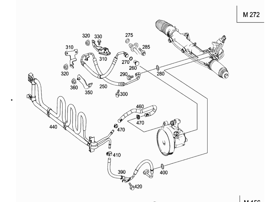

I need to know which power steering line goes into the top port of the steering rack and which line goes into does anybody know. I didn't mark them

One hose looks like it goes to passenger side then comes back

Heres the steering diagrams that may help. https://nemigaparts.com/cat_spares/e...204081/62p/46/

Thinking you have the M272?

Yes 272. Looks like the top port goes towards the passenger side then comes back.

Top port on the steering rack goes to the pump, bottom port connects to the cooler line.
