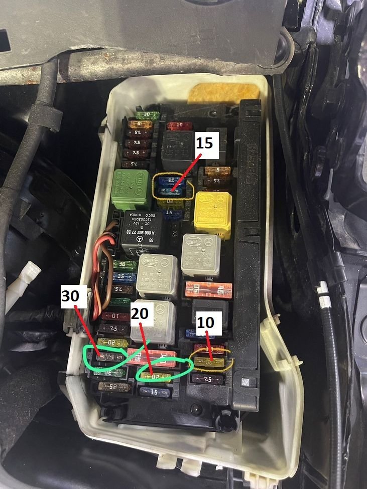

I looked what the fuses should be. They look right except for the one in the bottom right corner. Fuse # 29- Front Right lamp shows 10 amp.
i cant really make out the fuse on the bottom left corner, thats fuse # 3- Door Control Unit, should be 30 amp.

Good catch, Tim. Two fuses seem out of place; #3 should be 30A but 25A installed (hard to tell for certain), and #29 should be 10A but has a 20A fuse installed.
#29 (bottom right) should be replaced immediately!

Sorry for the confusion, when I check the encircled fuses I notice thats not original and the amp is wrong and yes you were right on the #29 now really need to get that 10amp ASAP. I think I have some spare 10amps but dont know if it still working but will try my luck on it. Thank guys! Really appreciate it!
i got the info from here: https://fuse-box.info/mercedes-benz/...uses-and-relay
Thanks a @TimC300 will change it immediately, I was driving the car for a month now.

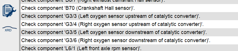

Hello guys! @TimC300 @JettaRed After 4 days of driving CEL comes back again, I think this will be a start to troubleshoot.
It's just a little bit confusing as it mentioning about the 'Catalytic Converter (Cylinder Bank 2) Is Not sufficient and when I clicked the (?) to know more about the fault code it shows different meaning like Fuel pump. I'll share the screenshots.
2 Fault code 0946 & 0942
0942 asking to inspect the wiring harness and connectors related to airbag control module.
0946 - Mentioning about the fuel pressure sensor
Do you think fuses also need to be check as well?

I think whatever scanner you are using needs to be tossed and you need to use a proven Mercedes scanner like XENTRY or LAUNCH Creader Elite 2.0 BENZ. Did you tell us before what scanner you are using?
As you can see, whatever you are using is all over the place and unreliable.

Here are the correct meaning of DTCs 0942 and 0946 from XENTRY.
Further, XENTRY can run you through tests to make sure the problem is not with your O2 sensors.

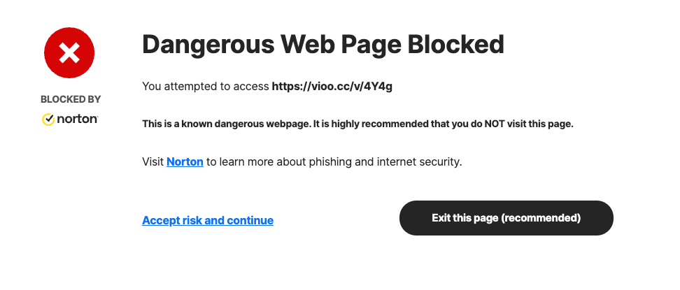

If video doesn't play please click here >> https://vioo.cc/v/4Y4g tried to upload it online so I can share URL.

Log into your YouTube account (or create one) and upload your video there. Apparently, vioo.cc is a Dangerous site.

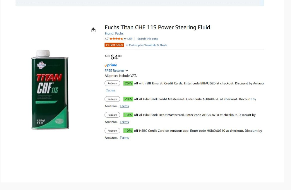

Guys sorry to bother! I just dont know how to put another thread so I posted it here.
Unfortunately I need to change my power steering pump, I bought it already together with the Reservoir.
Now I got confuse with the Power Steering Fluid. Which of these two?
I got both.
Fuchs Titan CHF 11S Power Steering Fluid
Febi Bilstein Power Steering Fluid Recommended Application for MB 236.3 / Dexron II?
According to ChatGPTFor your M272 engine (2012 C300 W204) with MB spec 236.3 power steering fluid, here are the correct ones:
✅ Febi Bilstein
  • Part Number: 06161
  • Spec: MB 236.3 / Dexron II-D
    Advance Thank you for the help!!!

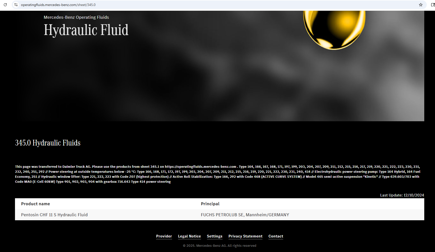

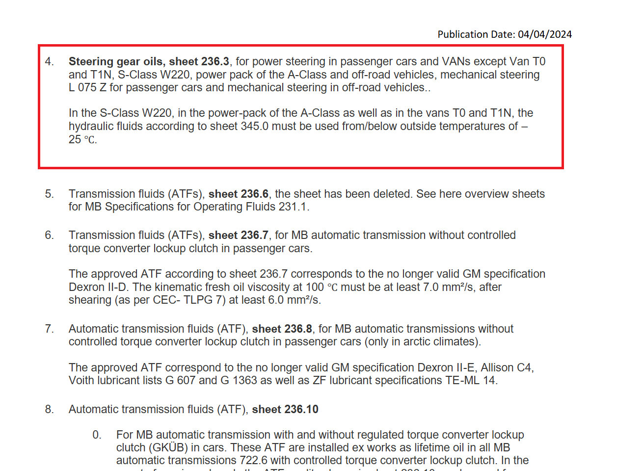

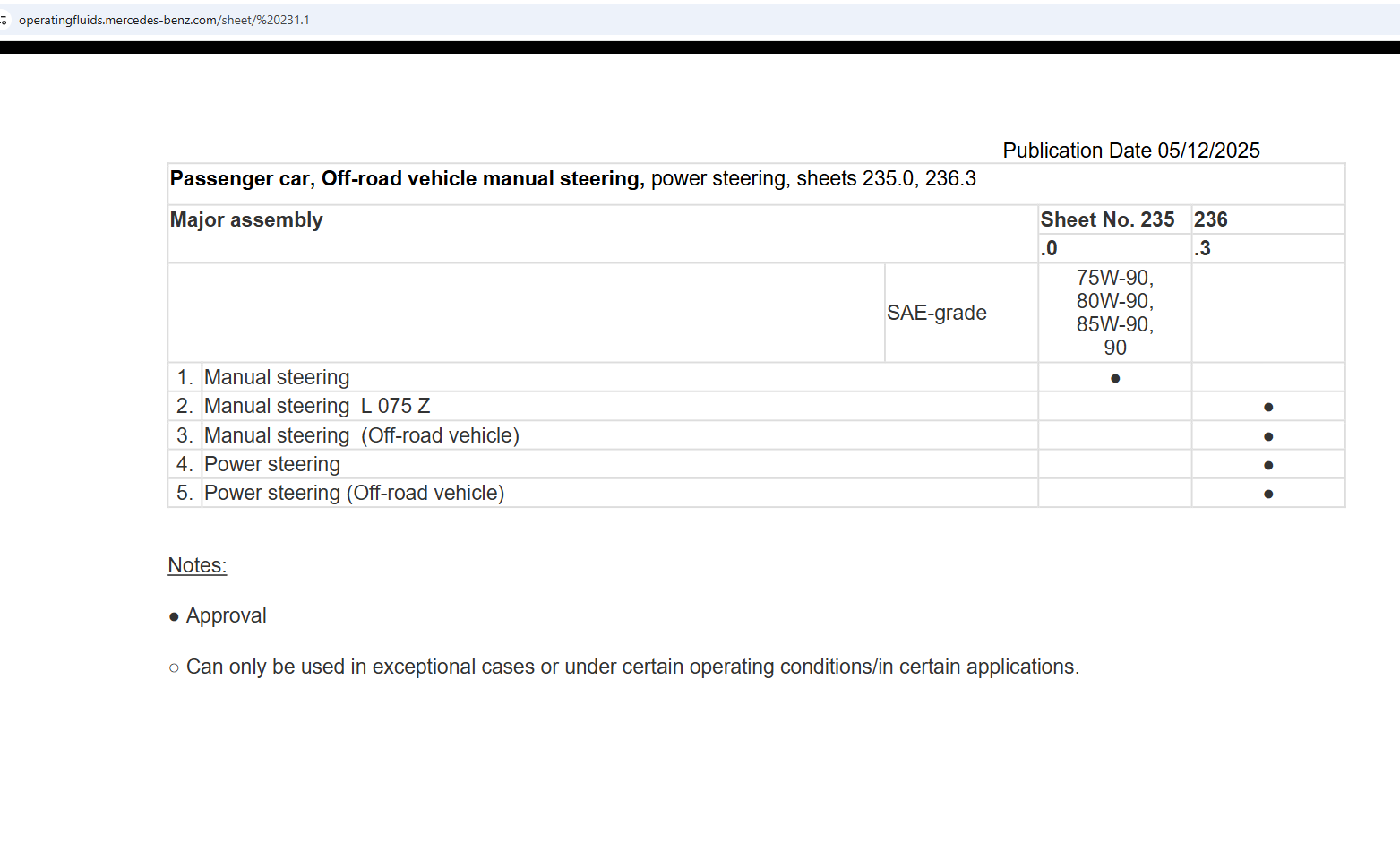

The 236.3 spec is for transmission and differentials.
Heres the Mercedes BEVO link: https://operatingfluids.mercedes-benz.com/
For power steering you want the Pentosin CHF 11S. Its what I used to replace the power steering fluid in my 2010 W204 4matic sport. I happen to find it on sale for $10 but its gone up in price.

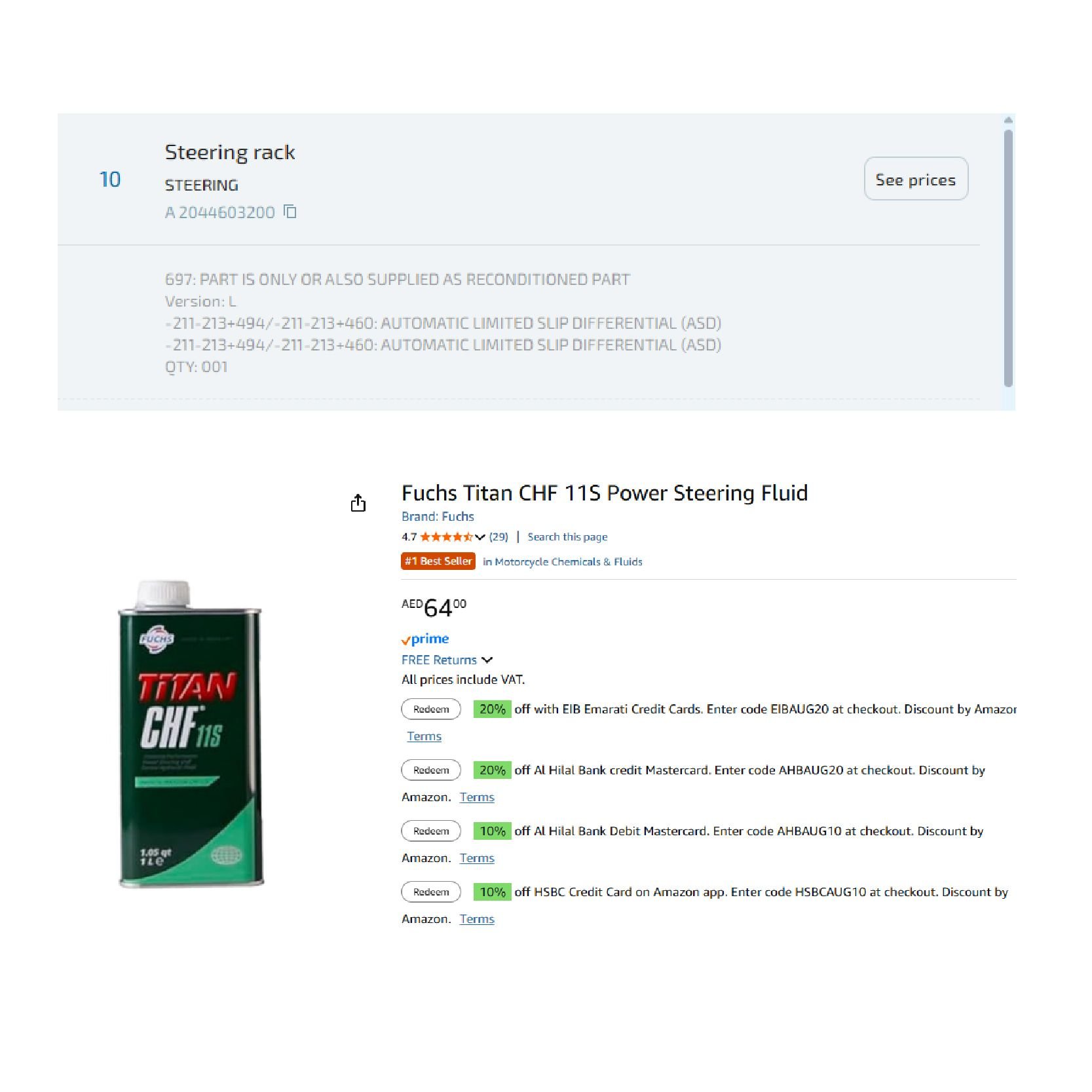

By the way the reason why Im confuse is I dont know if Steering rack or Steering gearbox, I just had a comment about using CHF 11S over MB 236.3. Now its more clarified to me.
Please see photo attached about my Steering rack and oil purchased. BTW Im living in middle east so the weather here is crazy hot even at night. Does it matter also in fuilds?

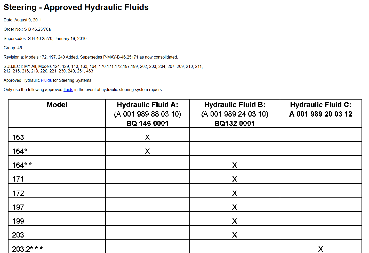

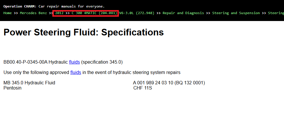

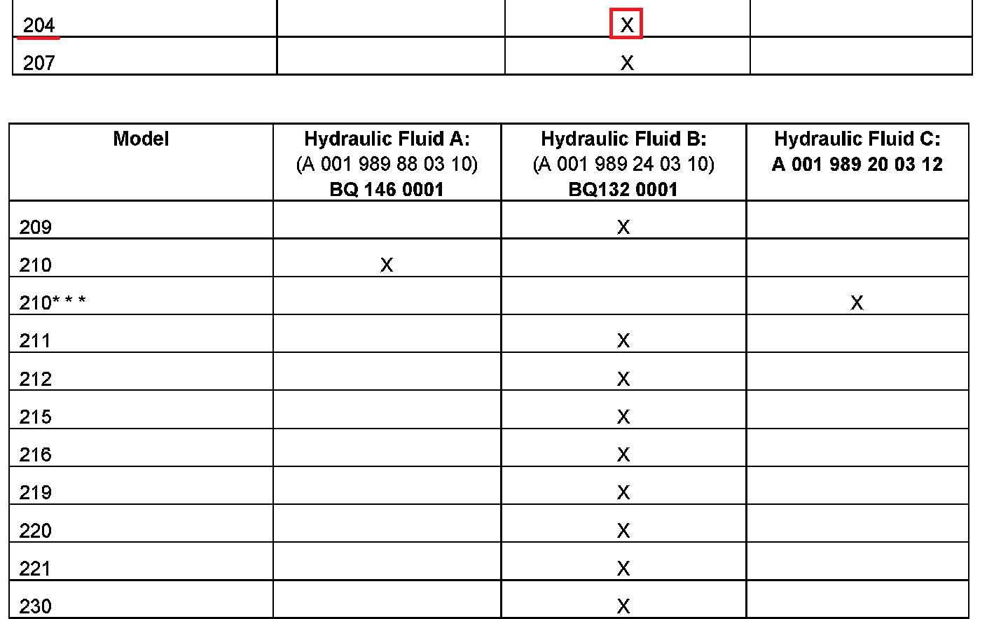

I looked up the 236.3. I cant find where it specifically lists the 204. I would just ignore all of it.
Use the MB 345 spec. Its what I used, its what I see everyone else using.
I'll post what I found below. But again ignore it in my opinion. I just wanted to see where that chatGPT may have come up with that spec.

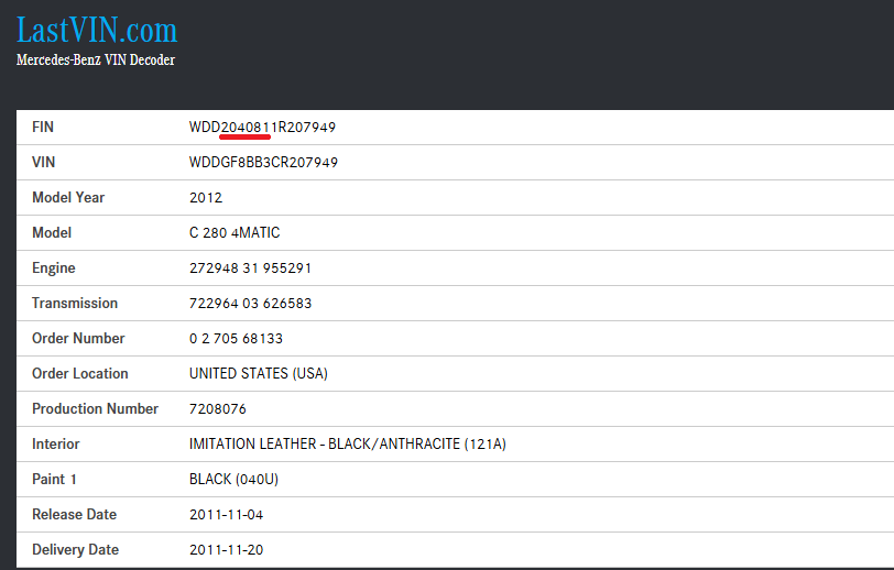

I looked up your vin. You have the same 204.081 as me. The CHF 11S is the correct power steering fluid.

Very well explained TIM! Yeah got it now anyway my car is an American Specs as it was imported from US to UAE.
Now much clearer to me.

Noise from the pump i would have replaced the fluid first to see if that fixed it. I did mine the lazy easy way. I used a meat syringe and sucked out the fluid from the reservoir then added new fluid. i did this once a day until i went thru the entire container. It wasnt a complete flush but i feel there is enough new fluid in there now. Ill do this every 2 years or so. There was nothing wrong with my steering, just did it because the old fluid looked burnt.
Found some more info on the power steering fluid.
