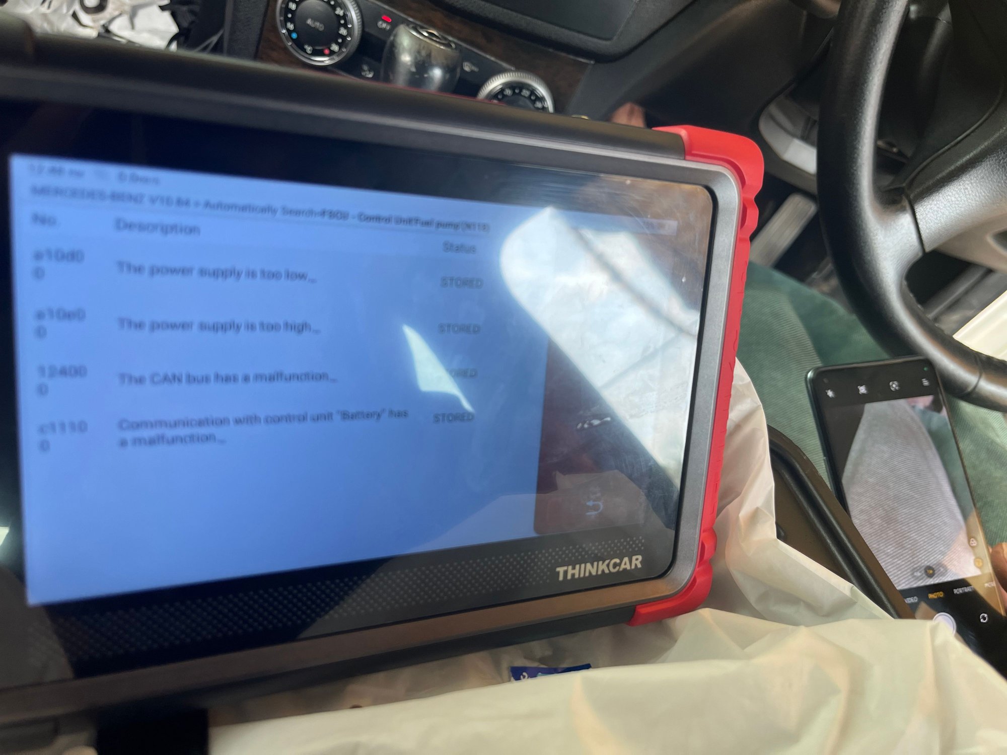

thanks so much for your input. Yes I got the car scanned using both Autel and Thinkcar . And it did record over voltage as well as undervoltage in many components . Will be getting the alternator changed at the earliest .

hey @TimC300 thanks so much for your input . Will get this checked A few fault codes that were recorded are as follows . Originally Posted by TimC300
