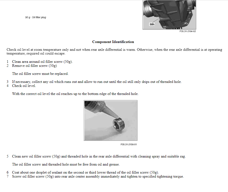

I changed the front and rear diff fluid in mine just because. I did it around 140,000 miles. I have no idea if it was ever done before. For the rear I remember how good the old fluid looked, i was thinking it must have been done more recently just how it looked. I didnt see any oil staining or signs the diff was leaking, but I wanted to make sure it had the proper fill level anyways. Its one of those things I just had to see for myself.
I re-used the same filler plug, I just screwed it back on to proper torque, 50nm I believe. later on I came across an MB procedure that shows a sealant installed on the fill plug prior to installing. I havent had an issue with leaking thankfully. Sealant makes sense why I had such a hard time removing the fill plug, had to use my impact on it.

Teflon tape. I put 3 layers then torque to spec. Has never leaked or gotten "wet".
