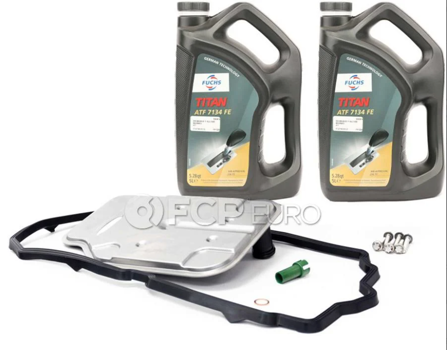

The link to the kit is under the picture.
https://www.fcpeuro.com/products/mer...tosin-7229late
