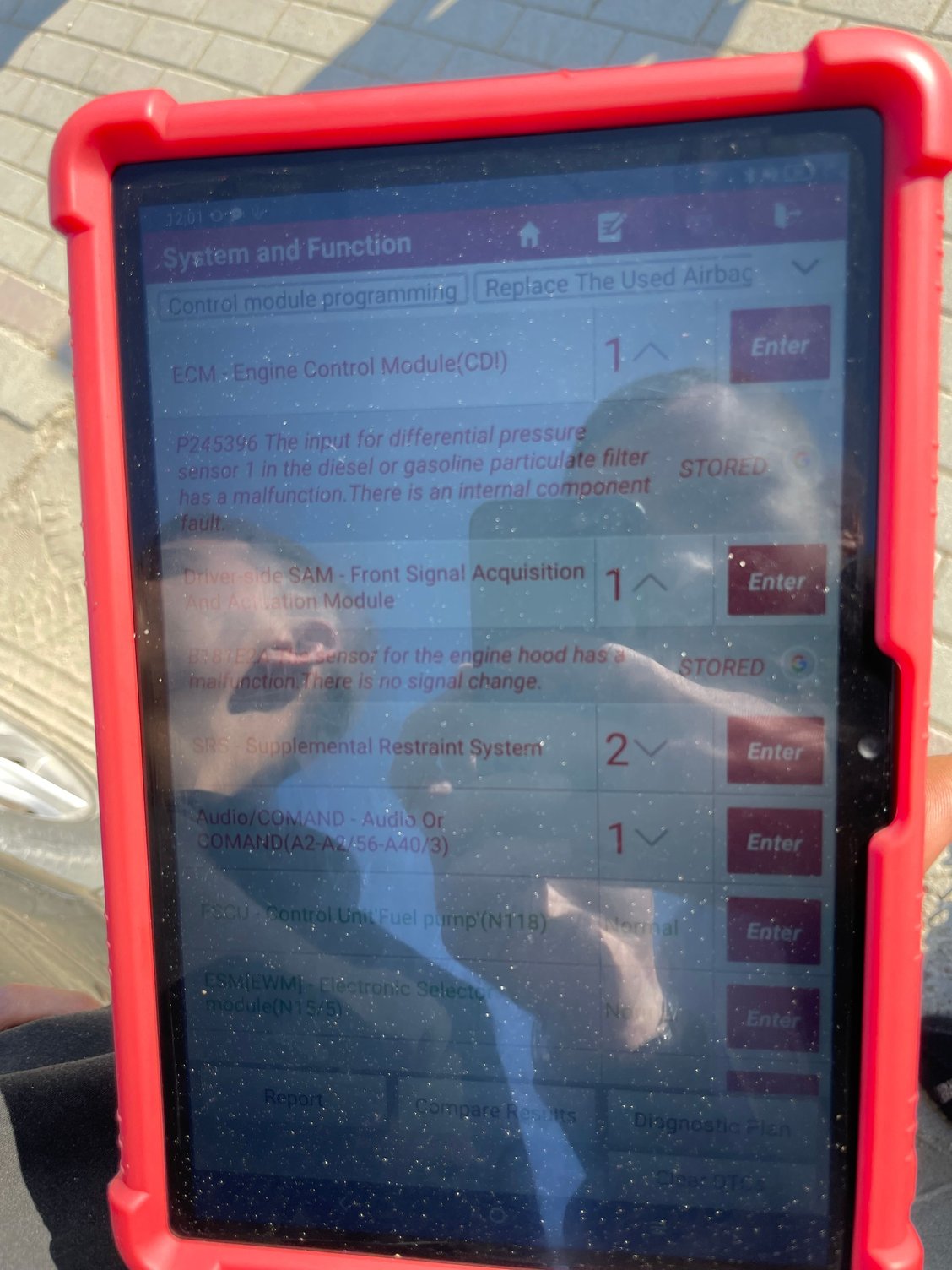

After starting the car in the morning (this problem happens only in the morning) and driving, the car does not exceed 2000-2500 rpm and does not pull. When I'm braking at the moment when the speed is about 20 km/h, the car gives a small shock, after I stop and restart the car, everything returns to normal. I went to check the gearbox and it was fine but they gave me this problem as in photo P245396 (The input for differential pressure sensor 1 in the diesel or gasoline particulate filter has a malfunction. There is an internal component fault.) (STORED), I changed this sensor, cleaned the pipes with compressed air, I did a regeneration, I tired it on live data and the pressure increased when I pressed the pedal but in the morning same problem again. I also checked my glow plugs but they were fine. I also checked fuel injections but they were in good condition. My dpf is 2%. I don't know what to do. Any advice?

diesel exhaust pressure
New sensor... same fault.
Your diesel particulate filter is plugged up.
Time to renew it.

@CaliBenzDriver Thank you, I changed it and everything is ok.
